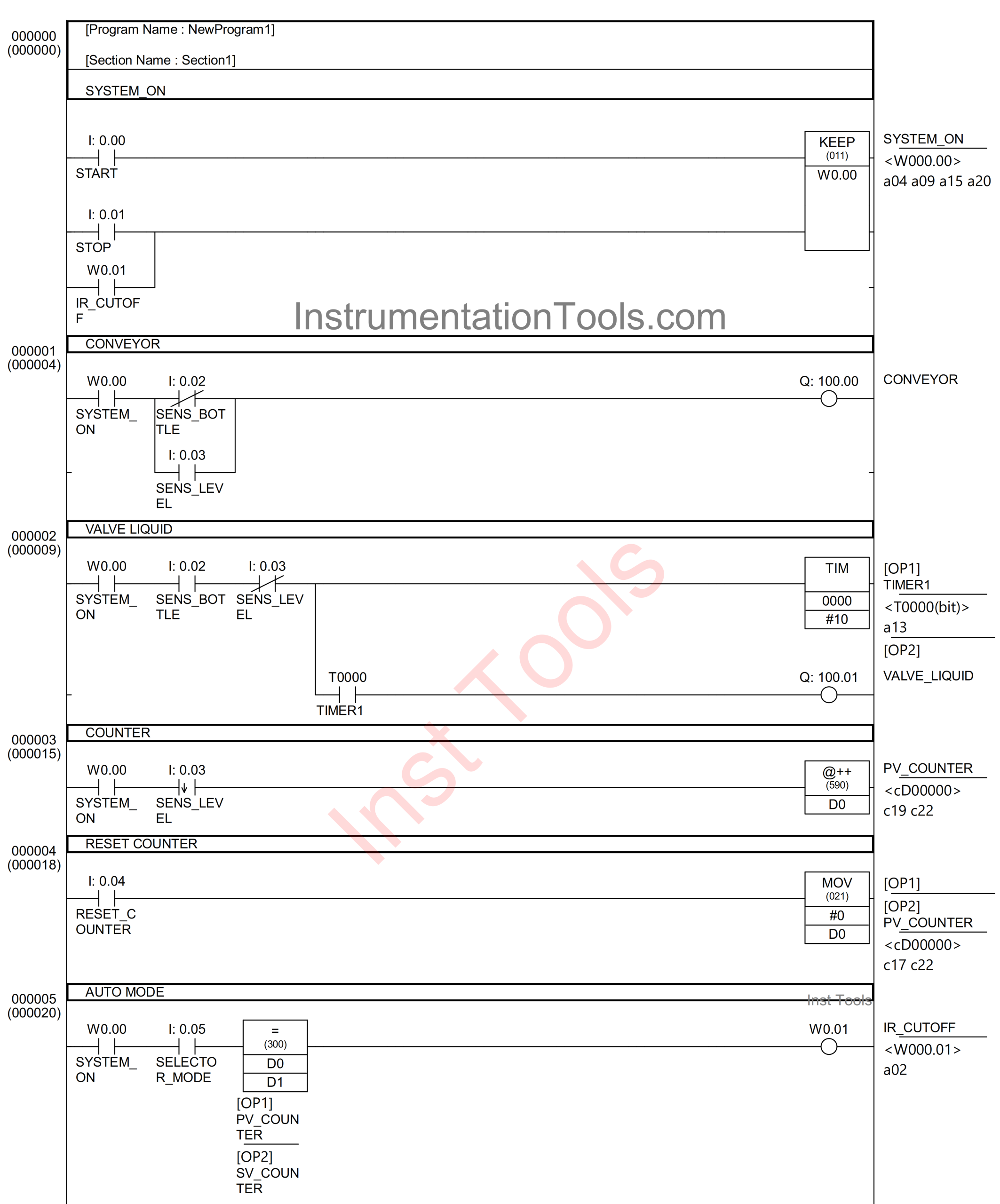

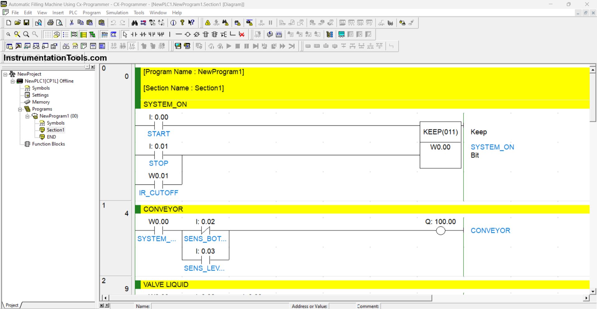

RUNG 0 (SYSTEM_ON)
In this Rung, when the START (0.00) button is Pressed, the memory bit SYSTEM_ON (W0.00) will be in the HIGH state. The memory bit SYSTEM_ON (W0.00) will remain in the HIGH state even though the button START (0.00) has been Released, because it uses the KEEP(011) instruction.
If the button STOP (0.01) is Pressed or the NO contact of the memory bit IR_CUTOFF (W0.01) in the HIGH state, then the memory bit SYSTEM_ON (W0.00) will be in the LOW state.
RUNG 1 (CONVEYOR)
In this Rung, when the NO contact of the memory bit SYSTEM_ON (W0.00) is in the HIGH state and the NC contact of Sensor SENS_BOTTLE (0.02) is in the LOW state, the output CONVEYOR (100.00) will be ON.
The output CONVEYOR (100.00) will be OFF if the NC contact of Sensor SENS_BOTTLE (0.02) is in the HIGH state.
The output CONVEYOR (100.00) will return ON when the NO contact of the memory bit SYSTEM_ON (W0.00) and the NO contact of Sensor SENS_LEVEL(0.03) are in the HIGH state.
RUNG 2 (VALVE LIQUID)
In this Rung, when the NO contact of the memory bit SYSTEM_ON (W0.00) and Sensor SENS_BOTTLE (0.02) are in the HIGH state, the timer TIMER1 (T0000) will start counting up to “2” seconds. After Timer TIMER1 (T0000) has finished counting, the output VALVE_LIQUID (100.01) will become OPEN.
When the NC contact of Sensor SENS_LEVEL (0.03) is in the HIGH state, the timer TIMER1 (T0000) will be OFF, and Output VALVE_LIQUID (100.01) will return to CLOSE.
RUNG 3 (COUNTER)
In this Rung, when the NO contact of the memory bit SYSTEM_ON (W0.00) and Sensor SENS_LEVEL (0.03) are in the HIGH state, the value in the memory word PV_COUNTER (D0) will increase (+1). Because it uses the @++(590) instruction.
RUNG 4 (RESET COUNTER)
In this rung, when the button RESET_COUNTER (0.04) is Pressed, the value in the memory word PV_COUNTER (D0) will be Reset to zero “0”, because it uses the MOV(021) instruction.
RUNG 5 (AUTO MODE)
In this Rung, when the NO contacts of memory bit SYSTEM_ON (W0.00) and SELECTOR_SWITCH (0.05) are in the HIGH state and the value in the memory word PV_COUNTER (D0) is Equal To SV_COUNTER (D1), then the memory bit IR_CUTOFF (W0.01) will be in the HIGH state.
