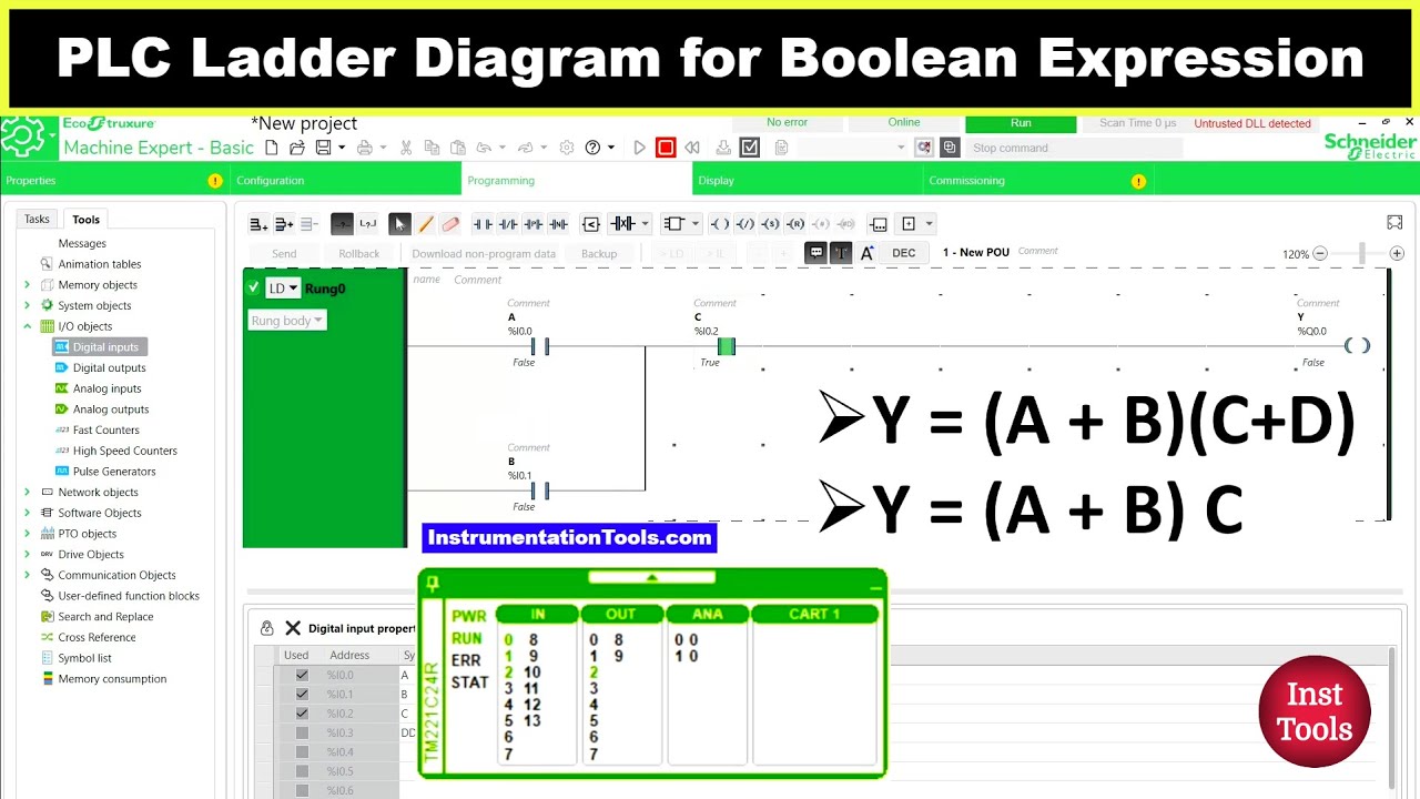

Design a PLC ladder logic for the following Boolean Expression.
We are using toggle Inputs to control the output.
Y = (A+B) (C+D)

PLC Ladder Diagram for the given Boolean Expression

PLC Programming
Find the equivalent plc program for the given Boolean expression.
Boolean Algebra to PLC Logic
PLC Program Description
  • In this program, we used Schneider Electric PLC software. You can use any brand of PLC software.
  • In the above PLC program, Normally Open Contacts are used for input A, input B, input C, and input D.
  • Input A and Input B are connected in parallel, thus implementing OR Logic Gate.
  • There is again the implementation of OR Logic Gate as Input C and Input D are connected in parallel.
  • There is also implementation of AND Logic Gate as A+B is connected in series with C+D.
  • For the output Y (Q0.0) to be ON, either Input A or Input B should be ON and either Input C or Input D should be ON.
  • If input A and input C are ON or If input A and input D are ON or If input B and input C are ON or input B and input D are ON, then the output Y (Q0.0) will be ON.
