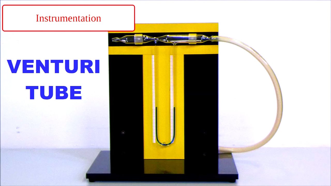

Venturi Meter
A Venturi meter is a device used to measure the flow rate of a fluid in a pipe. It consists of a pipe whose diameter gradually decreases to a throat (the narrowest point) and then gradually increases again.
Venturi Flow Meter - Venturi Tube
According to Bernoulli’s principle, as the fluid’s speed increases in the narrow throat section, its pressure decreases. By measuring the pressure difference between the wide and narrow sections of the pipe, the flow rate can be calculated.
