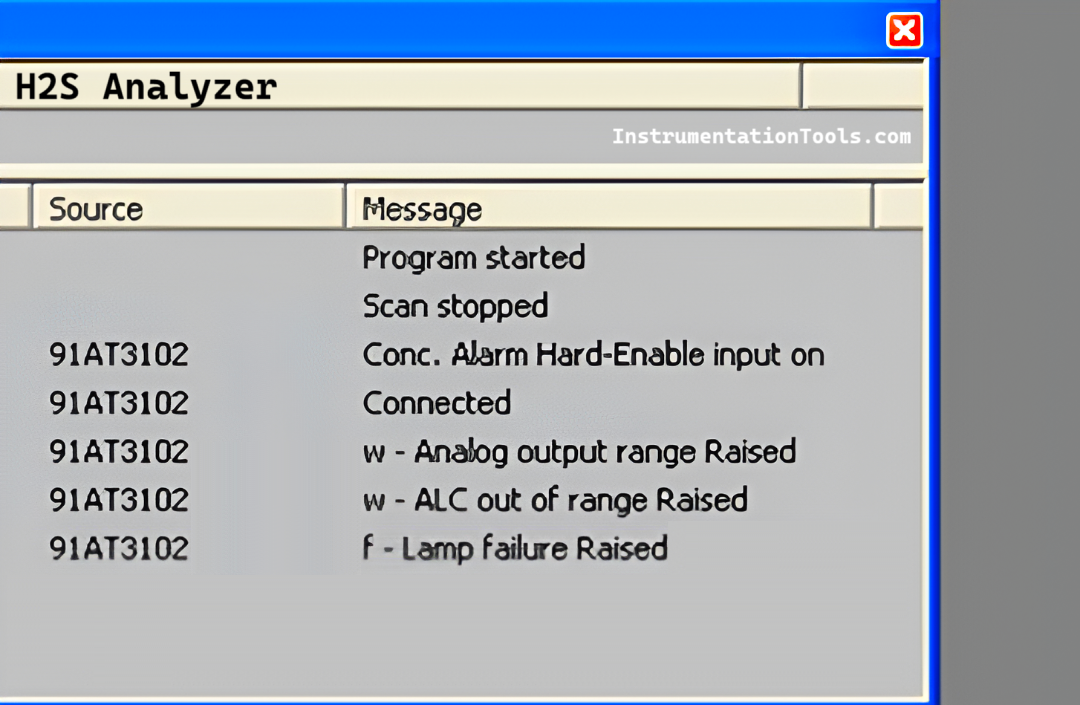

Problem Description: The H2S Analyzer was displaying a Lamp failure Alarm and not responding. Alarm could be visualized in both the local Display Panel & laptop.

Alarm Analysis

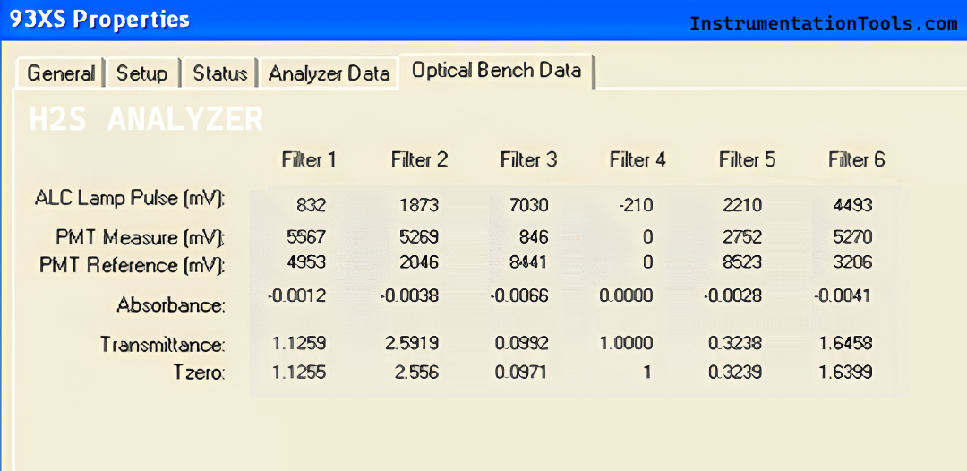

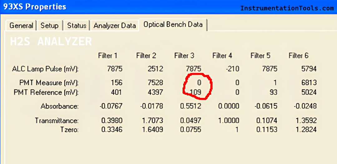

Connect the laptop and open the analyzer software. Open the Optical Bench Data and Filter 3 data, which are found to be abnormal compared to normal operation data.
Filters no. 1, 3 & 5 are responsible for the Cadmium lamp & filters no. 2 & 6 are for the copper lamp. It has been identified that the alarm appeared due to a failure of the cadmium lamp.

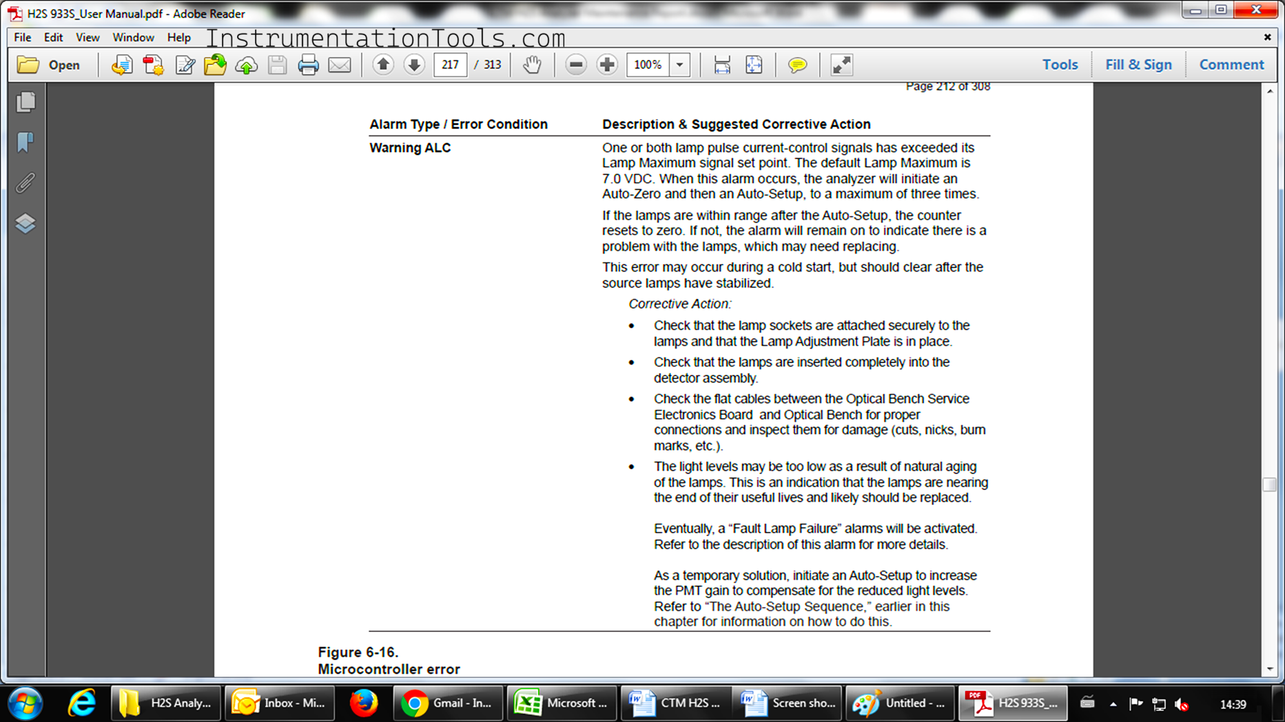

As per the reference manual, the error description & suggested corrective Action following activities were also carried out.
Removed the analyzer from housing & adjusted the lamp & completed the lamp replacement procedure, but no improvement was found.
Inspect & cleaned the sample cell with DM water for any contamination, and Auto setup activities were done, but no improvement was found.
Checked all the cables of the Analyzers for tightening & found ok.
Replace the Optical Bench service electronic card; the problem still persisted.
We are not able to understand where to measure 7.0 V DC as per the manual. We observed the Optical bench Data & found that the ALC Lamp pulse (mV) is the value to check. Opened current Optical bench data & found that filter mV was 7815. Then, the following procedure was carried out to resolve the issue:
Open the optical bench setup and compare the parameters with the Optical Bench Data:
ALC Set point in Optical bench setup should equal (difference up to 600 allowable) to PMT Reference (mV) in Optical Bench Data.
ALC lamp Pulse (mV) values in all the filters should be less than 7000mV after the lamp replacement process. (Lamp replace–Auto setup—Manual zero calibration). If more than 7000mV appear in any of the filters, then adjust the PMT Level (mV) in the Optical bench setup and again do Auto setup and Manual Zero calibration (2-3 times this procedure is done). After this adjustment, “ALC out of range alarm” disappeared, but “PMT out of range alarm” appeared.
