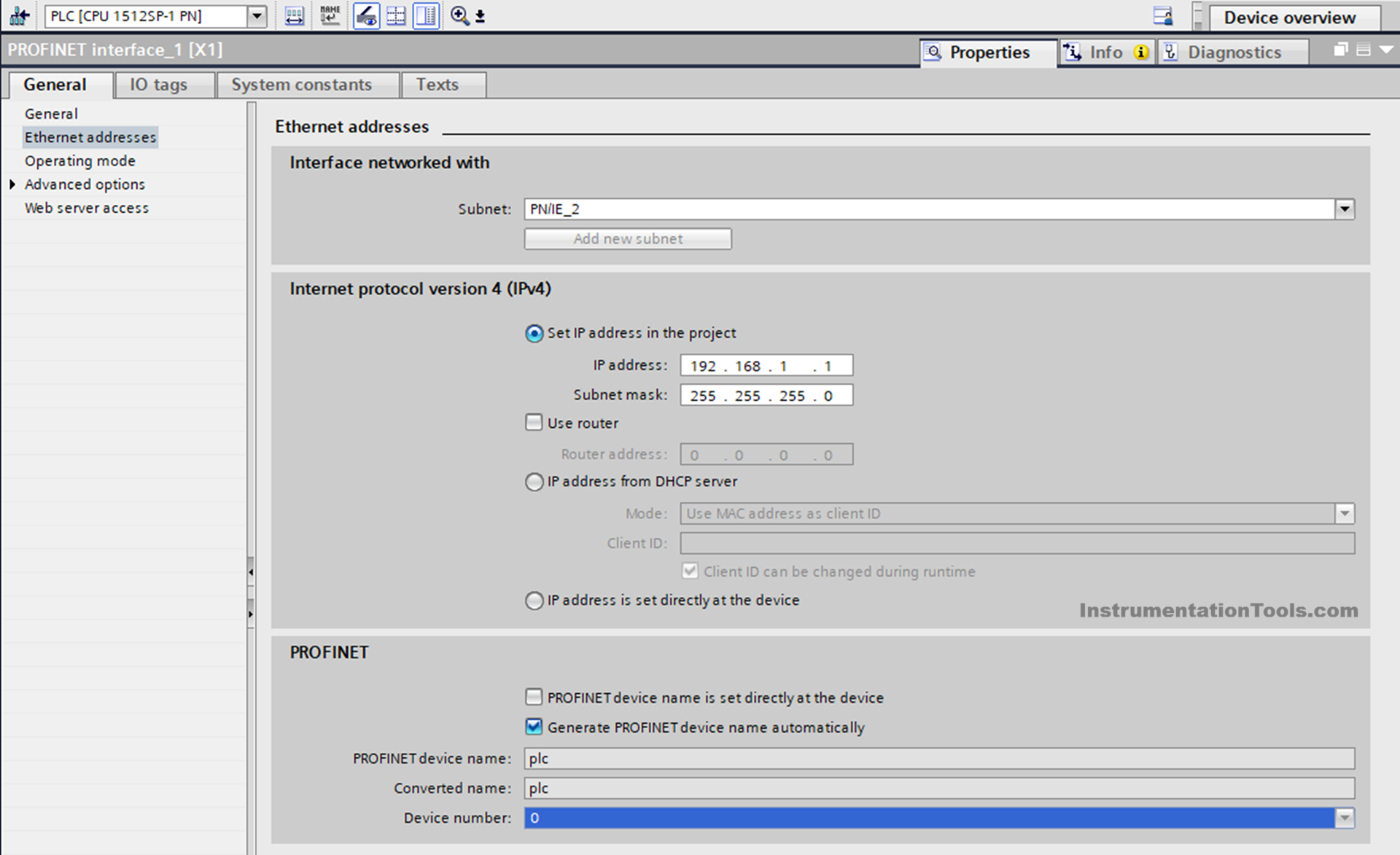

In TIA Portal, as you know, a network view is available where you can configure the network very easily. If the PN/IE subnet (the logical network that groups all PROFINET devices that should communicate with each other, because every device that must exchange PROFINET data must be assigned to the same PN/IE subnet in TIA Portal) is assigned incorrectly, then the communication will not happen.
PROFINET communication is not only based on IP addresses, but also requires a unique device name, correct PN/IE subnet and the matching topology. So in short, when you assign a subnet, TIA Portal realises which devices belong to the same network where IO devices are managed by the same control unit and how cyclic data will be exchanged between them.
PROFINET has a unique concept of device name. The device is identified primarily by its device name and secondarily by its IP address. This name is used by the PLC (IO Controller) to identify and bind the IO device during startup. The name can be set either automatically or directly on the device.
Whatever the case may be, when you go online in the PLC and search for PROFINET devices on the network, it shows either manually entered names or automatically generated names. You should assign this name to the corresponding device. If this step is not done, then communication with that device will not happen. Issues can happen if the wrong name is linked, if a name is not assigned, or if the name is a duplicate.
This name is very important, because even if the IP address is not assigned or the IP address is wrong, then too the PLC will correct this task automatically if the name is given. If there is no ID, then no further activity will happen. Refer to the above image for PN/IE and device name settings.

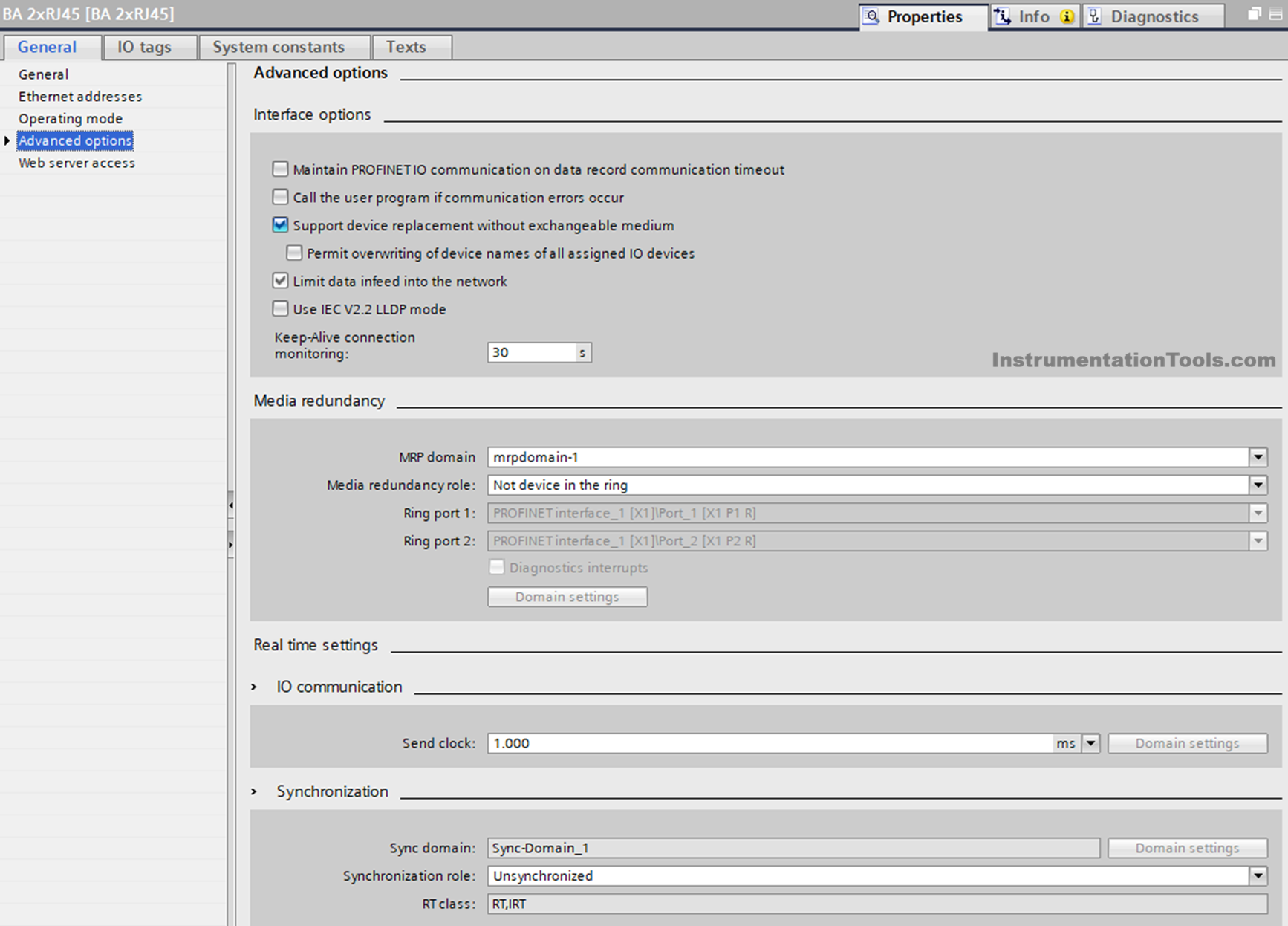

In the interface options, there are three factors to look at: maintain PROFINET IO communication on data record communication timeout, support device replacement without exchange medium and use IEC V2.2 LLDP mode. The first case means PROFINET cyclic communication (data) will happen even if acyclic communication (diagnostics, parameters, config transfer) breaks. This setting is disabled by default.
If an acyclic read/write timeout happens frequently, then it will break communication if the setting is disabled. The second setting means the device, if replaced, will automatically resume communication without manual intervention. This setting is enabled by default. If disabled, then communication will not happen without manual intervention during replacement.
The third setting means LLDP (link layer discover protocol) is being used for topology detection, detecting wrong port connections, and device naming assistance. This setting is disabled by default. Refer to the above image for the settings to be understood.

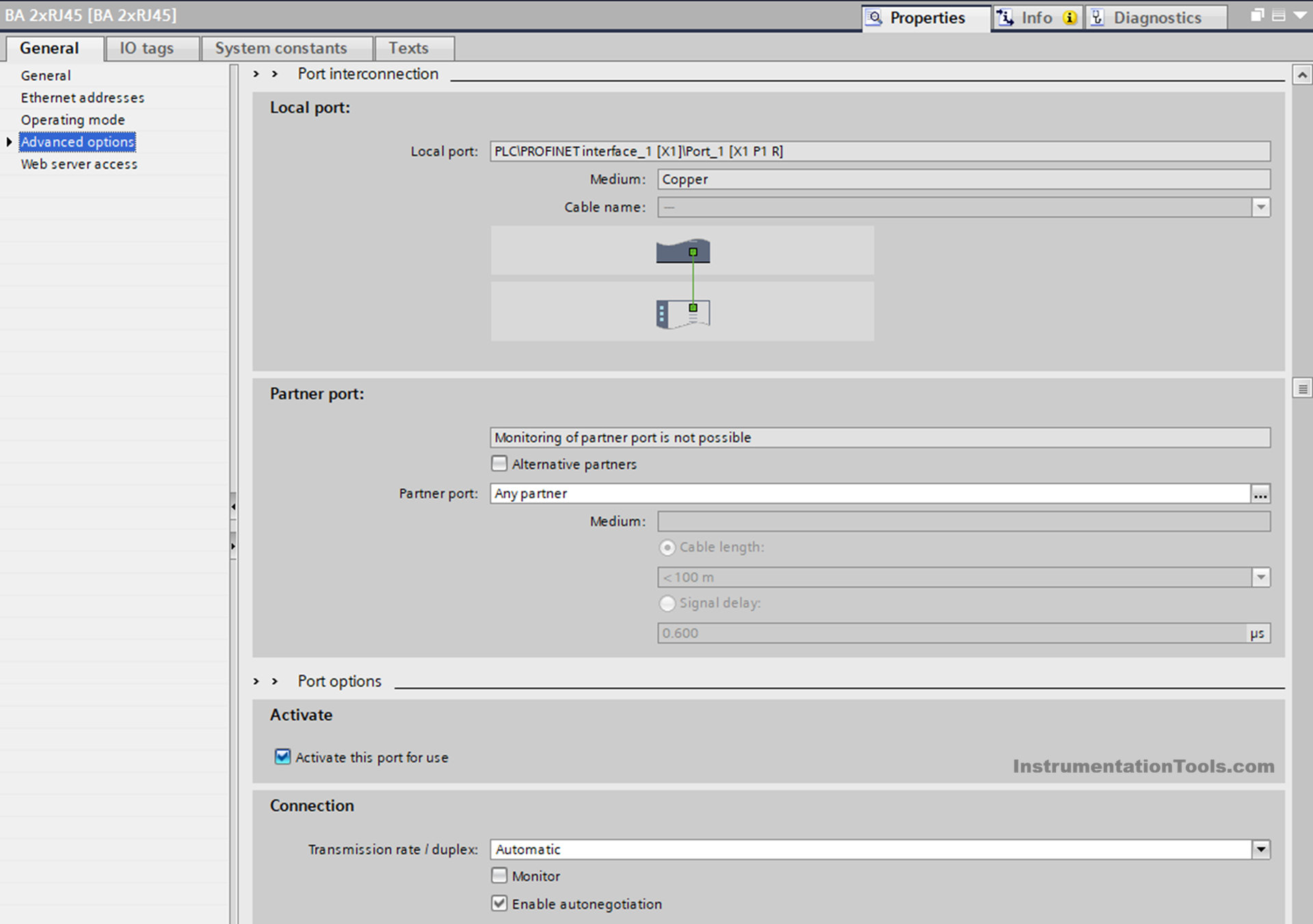

Media redundancy is an option where the PROFINET communication goes on working in the network, even if it fails. But this is applicable only for ring topology, where there are two Ethernet ports on a single device. Out of these two ports, one port is blocked during normal communication. If the ring is found to be broken, then this blocked port will be opened so that a new path is developed and communication flow starts from that path.
For this, there are two parties responsible for the communication: the manager and the client. If this option is enabled and no device is set as manager, then the ring will not be controlled. The same issue will happen if multiple devices are set as managers. If the topology you have designed is not a ring, and this option is enabled, then unwanted communication with high data bandwidth consumption will occur, which will result in a breakdown (because the manager waits for ring data which will never come). Refer to the image below for more settings.
PROFINET has the option to activate or deactivate the port. If the port is not activated, then it means the port will not work. This option is activated by default. Refer to the image below for more settings. If the port is not working, you can immediately check the option to find whether the option has been deactivated by mistake or not.
Once activated, you can also select the transmission speed – automatic or 100 Mbps full duplex (depending on the model, this speed was just an example). So if you choose full duplex and the switch used in the panel is half duplex, then communication will break.
