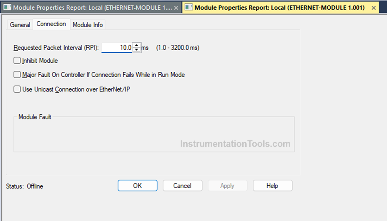

In any case, first check the value of RPI (in milliseconds) or request packet interval. It is basically the speed of data communication. The default value in Rockwell is 10 milliseconds. If you have too many devices on the network, and you have kept a low value for fast communication, then data is communicated too quickly in bulk, which increases network bandwidth and causes the network to overload and break down.
Connection timeout happens frequently in this case, as packets get dropped. A high value of RPI is not as dangerous as compared to a low RPI, which we discussed, but it makes the process very slow to operate. So, always calculate the network load (for that, calculate the total number of devices on the network, the data they will communicate, and the speed set in the configuration) and set the appropriate value.
Then, you have to check the unicast/multicast setting in the Ethernet-IP communication configuration. Unicast means one to one (meaning a device with unicast selected can send data to PLC only), and multicast means one to many (meaning a device with unicast deselected can send data to any device that joins the network). Multicast consumes more bandwidth and requires managed switches due to any device joining the network for data.
Simply, in any software configuration, if a device is the owner (like PLC in Studio 5000) and unicast is selected in another server device (like AENT in Studio 5000, then that device will communicate with PLC only. So, when you are trying to get data to SCADA directly from that device with unicast, the data will not be communicated to SCADA.
When choosing multicast, care must be taken to use IGMP (Internet Group Management Protocol), as IGMP controls who should receive multicast packets and who should not, failing which the multicast behaves like broadcast and floods the network, causing data loss.
For simple non-critical communication, forcing multicast is not the recommended option. If two PLCs incorrectly join the same multicast group with the wrong RPI, then data inconsistencies will occur, and timeouts will happen frequently. Refer to the image below for RPI and unicast settings as an example.
