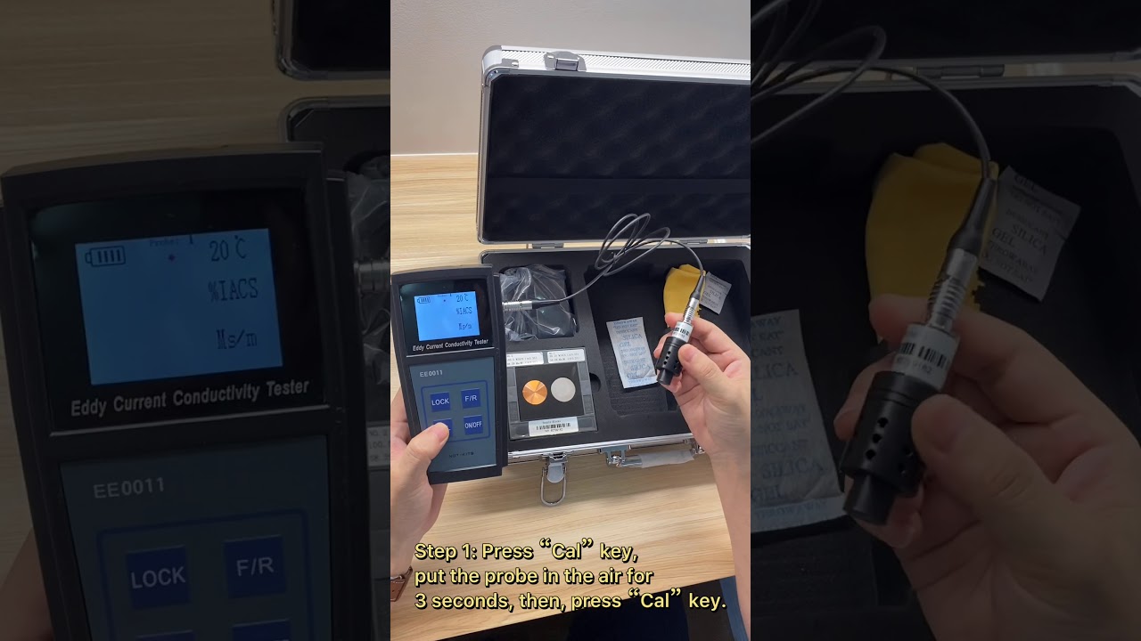

An Electrical Conductivity Meter is a device used by quality assessment professionals to measure the conductivity of metals on-site and in the laboratory. They are often portable and can give very accurate conductivity readings pretty quickly.
This explains why they’ve become the trendy tool in the industry for electrical conductivity measurements. But here is the thing.
The electrical conductivity meter has specific use cases, making it important to know where and when to utilize it for electrical conductivity measurement.
  • EC Meters are applicable for testing the conductivity of non-ferrous metals, including copper and aluminum.
  • They are also applicable for pre-anodizing conductivity tests for aluminum
  • The current resistance of a material is also obtainable with an electrical conductivity meter
  • For material hardening and heat working processes for metals, an electrical conductivity meter is used to monitor the heat treatment process.
  • For alloys, an EC meter is used to determine the homogeneity of the alloy components.

  • Easy visualization of results from an onscreen LCD that helps the inspector to view their results without any stress
  • It has an easy calibration system that eliminates the repetitive calibration process involved with other types of inspection tools.
  • The results are very accurate compared with traditional conductivity measurements, which are very low.
  • The detection accuracy of the EC meter is equally very high as it uses a microprocessor to process its data.
  • It is also very durable to withstand rough environmental conditions and terrains, often the case when on job sites.
  • EC meters are portable, making them an easy choice for both laboratory and site use.
  • Automation is possible with EC meters since it has accessories that are easy to integrate with most automation systems.
  • It is very cost-effective as a non-destructive testing tool since the test sample is preserved before, during, and after.
