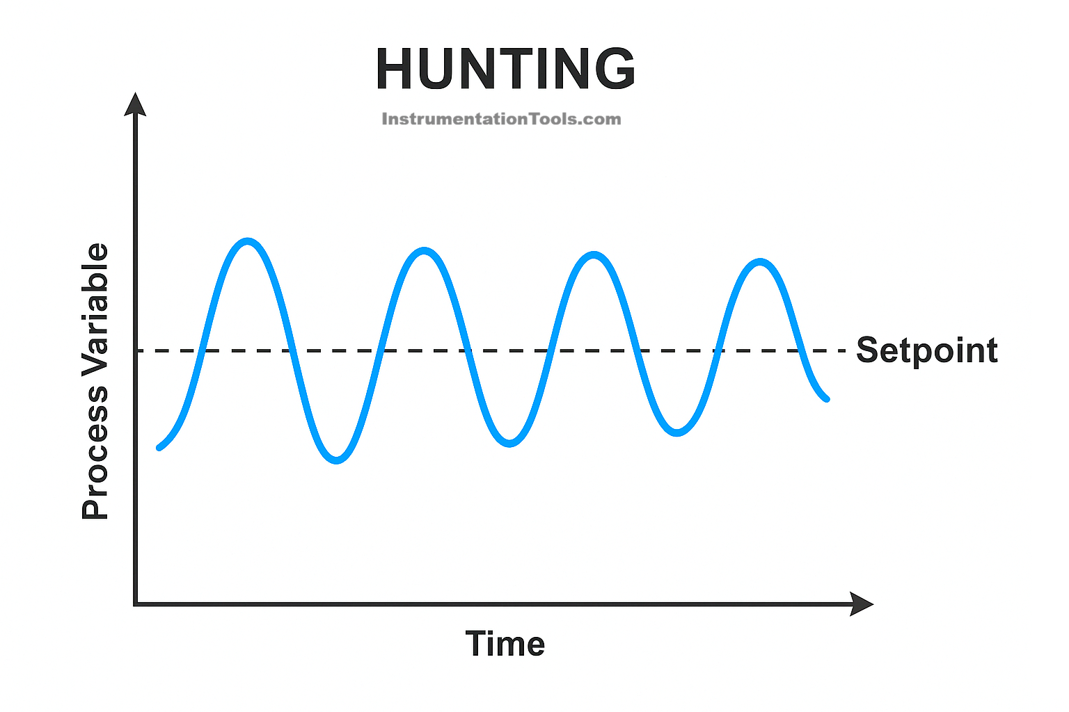

First of all, let us understand what hunting is in a control system. You have a temperature that is to be maintained around 95 degrees Celsius. For that, you have a control steam valve. This control valve needs to be controlled by a PID controller, so that the temperature is maintained by maintaining the proper flow of steam. During that process, it is normal for the temperature to vary 1-2 degrees as tolerance around the set value, or even less.
But what happens if this tolerance varies by 8-9 degrees? And this variation is at a very large time cycle, which means the system is not being controlled. This problem can then be referred to as hunting. It is to be noted that apart from hunting, these variations can also occur due to drift, disturbance, noise, or underdamped response. But what makes hunting different, we will see now.
Refer to the image below. Hunting occurs when the process variable is very above or very below the set value for a long time. It is to be noted that hunting can also occur for a short time, which we will understand later. Such continuous oscillation of the controlled variable, without settling down quickly to a steady value, is called hunting. As the variable is controlled by a control element, hunting occurs when the control element is trying to overcorrect the error by alternating between too high and too low.
This causes the process variable to swing around the desired value and create a wide oscillation. So, when the control element is trying to rapidly increase the variable or rapidly decrease the variable, then such overshooting and undershooting repeat. This reduces system stability, efficiency, and accuracy, and increases wear and tear of the element, too.
