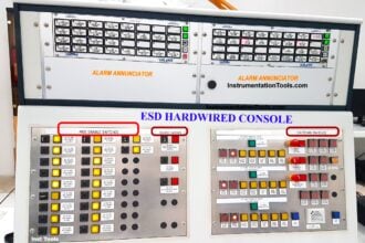

Annunciator Panel is a device that consists of a number of visible signals such as “flags” or lamps indicating the status of an alarm system or systems.
Annunciator PanelProcess controlPrincipleAnnunciators vs SCADA alarm systems
Each circuit is usually labeled to identify the location and condition being monitored. In addition to the visible signal, an audible signal is usually associated with the device. When an alarm condition is reported, a signal is indicated visibly, audibly, or both. The visible signal is generally maintained until reset either manually or automatically.
An annunciator panel is a group of lights used as a central indicator of status of equipment or systems in an industrial process, building or other installation.
Usually, the annunciator panel includes a main warning lamp or audible signal to draw the attention of operating personnel to the annunciator panel for abnormal events or condition.
Annunciator Panel
Annunciator Panel
Process control
In industrial process control, an annunciator panel is a system to alert operators of alarm conditions in the plant. Multiple back-lit windows are provided, each engraved with the name of a process alarm.
Lamps in each window are controlled by hard-wired switches in the plant, arranged to operate when a process condition enters an abnormal state (such as high temperature, low pressure, loss of cooling water flow, or many others).
Single point or multipoint alarm logic modules operate the window lights based on a preselected ISA 18.1 or custom sequence. In one common alarm sequence, the light in a window will flash and a bell or horn will sound to attract the operator’s attention when the alarm condition is detected.
The operator can silence the alarm with a button, and the window will remain lit as long as the process is in the alarm state. When the alarm clears (process condition returns to normal), the lamps in the window go out.
