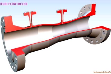

Question 2
Which flow meter works by measuring the pressure drop across a constriction in the flow path?
A. Ultrasonic Flow Meter
B. Magnetic Flow Meter
C. Positive Displacement Flow Meter
D. Venturi Flow Meter
Show the Answer
Venturi Flow Meter

Question 9
What flow meter is characterized by a reduced diameter throat and measures the pressure difference to determine flow rate?
A. Positive Displacement Flow Meter
B. Thermal Flow Meter
C. Venturi Flow Meter
D. Turbine Flow Meter
Show the Answer
Venturi Flow Meter
