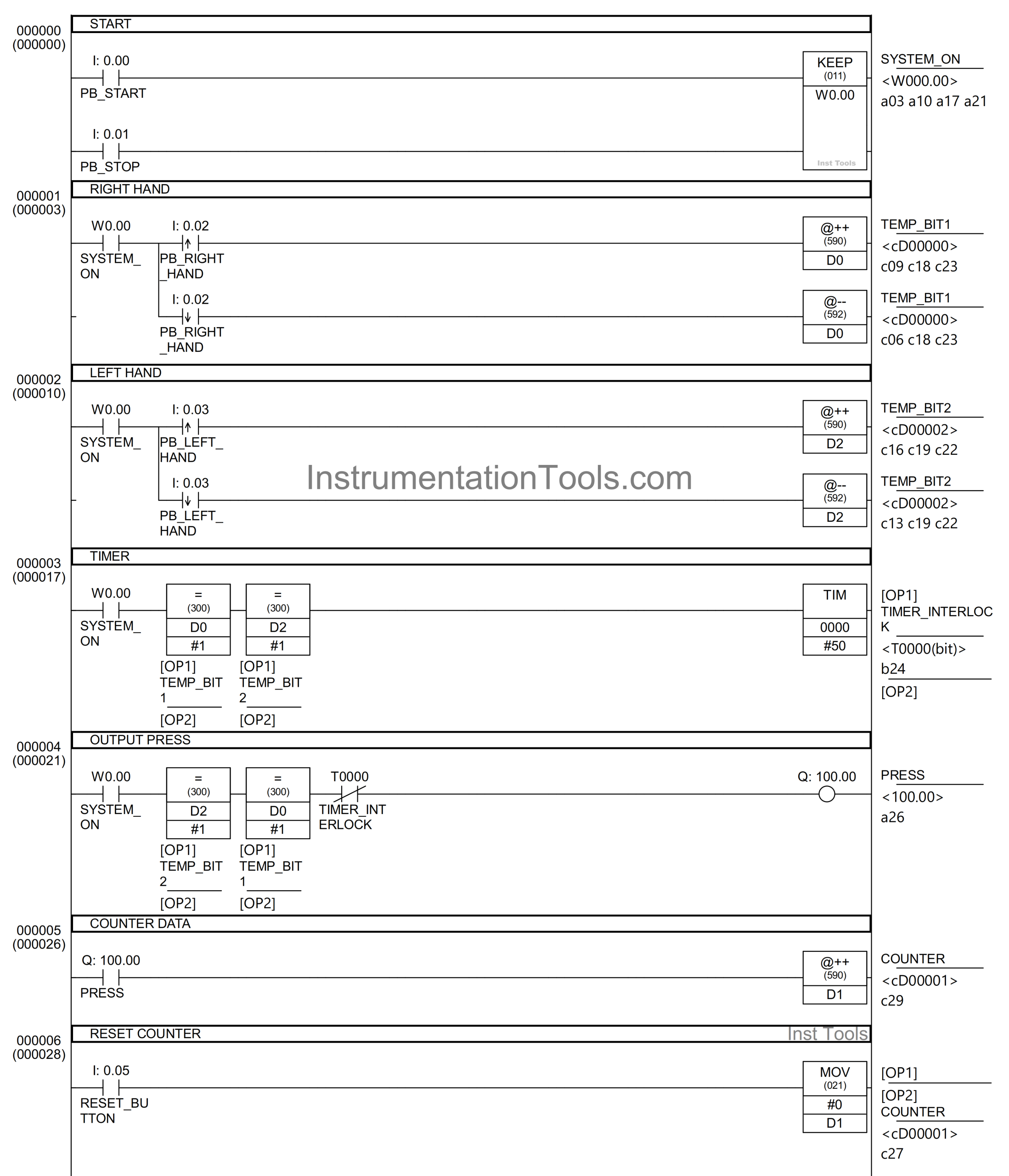

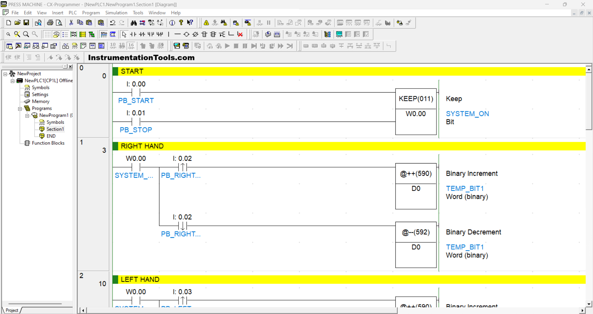

RUNG 0 (SYSTEM ON)
In this Rung, the memory bit SYSTEM_ON (W0.00) will be in the HIGH state when the PB_START (0.00) button is Pressed. Because it uses the KEEP(011) instruction, the memory bit SYSTEM_ON (W0.00) will remain in the HIGH state even though the PB_START (0.00) button has been Released.
The memory bit SYSTEM_ON (W0.00) will be in the LOW state if the PB_STOP (0.01) button is Pressed.
RUNG 1 (RIGHT HAND)
In this Rung, when the NO contact of the memory bit SYSTEM_ON (W0.00) in the HIGH state and the PB_RIGHT_HAND (0.02) button is Pressed, the value in the memory word TEMP_BIT1 (D0) will increase (+1).
When the PB_RIGHT_HAND (0.02) button is Released, the value in memory word TEMP_BIT1 (D0) will decrease (-1).
RUNG 2 (LEFT HAND)
In this Rung, when the NO contact of the memory bit SYSTEM_ON(W0.00) in the HIGH state and the PB_LEFT_HAND (0.03) button is Pressed, the value in the memory word TEMP_BIT2 (D2) will increase (+1).
When the PB_LEFT_HAND (0.03) button is Released, the value in the memory word TEMP_BIT2 (D2) will decrease (-1).
RUNG 3 (TIMER)
When the NO contact of the memory bit SYSTEM_ON (W0.00) becomes in the HIGH state and the value in the memory word TEMP_BIT1 (D0), TEMP_BIT2 (D2) is Equal To “1”, then the TIMER_INTERLOCK (T0000) Timer will count up to 5 seconds.

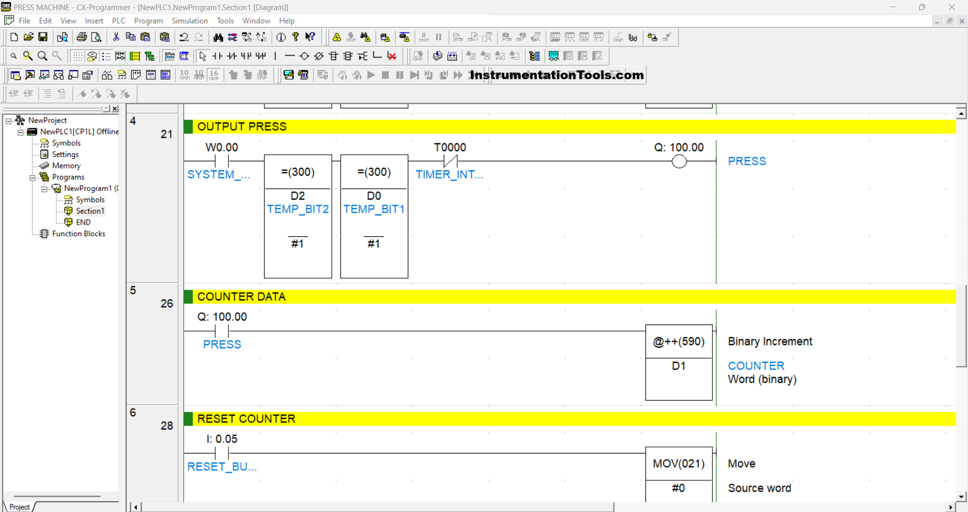

RUNG 4 (OUTPUT PRESS)
When the NO contact of the memory bit SYSTEM_ON (W0.00) becomes in the HIGH state and the value in the memory word TEMP_BIT1 (D0), TEMP_BIT2 (D2) is Equal To “1”, then the output PRESS (100.00) will be ON.
If the NC contact of the TIMER_INTERLOCK (T0000) Timer is in the HIGH state, then the PRESS (100.00) output will be OFF.

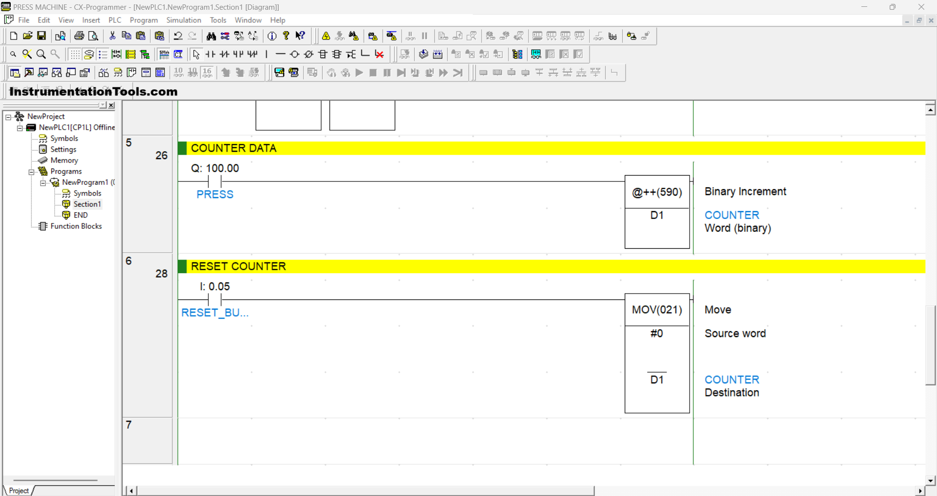

RUNG 5 (COUNTER)
When the NO contact from the PRESS (100.00) output is ON, the value in the memory word COUNTER (D1) will increase (+1).
RUNG 6 (RESET COUNTER)
When the RESET_BUTTON (0.04) button is Pressed, the value in the memory word COUNTER (D1) will be reset to zero “0”. Because the Move instruction moves the zero “0” value to the memory word COUNTER (D1).
