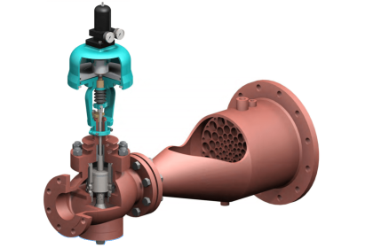

What is Desuperheater?
 The Process of Controlling the temperature of the Super-heated Steam by spraying water of High Purity through the Spray Nozzles. The Device Used is called De-Superheater or Attemperator.

In This method, the Attemperation spray water of high purity is introduced into the Superheated Steam line through a Spray Nozzle.
The Water rapidly evaporates and mixes with the Steam to reduce the Temperature.
This system provides a Quick Response and Sensitive means of Temperature control of the main steam.
