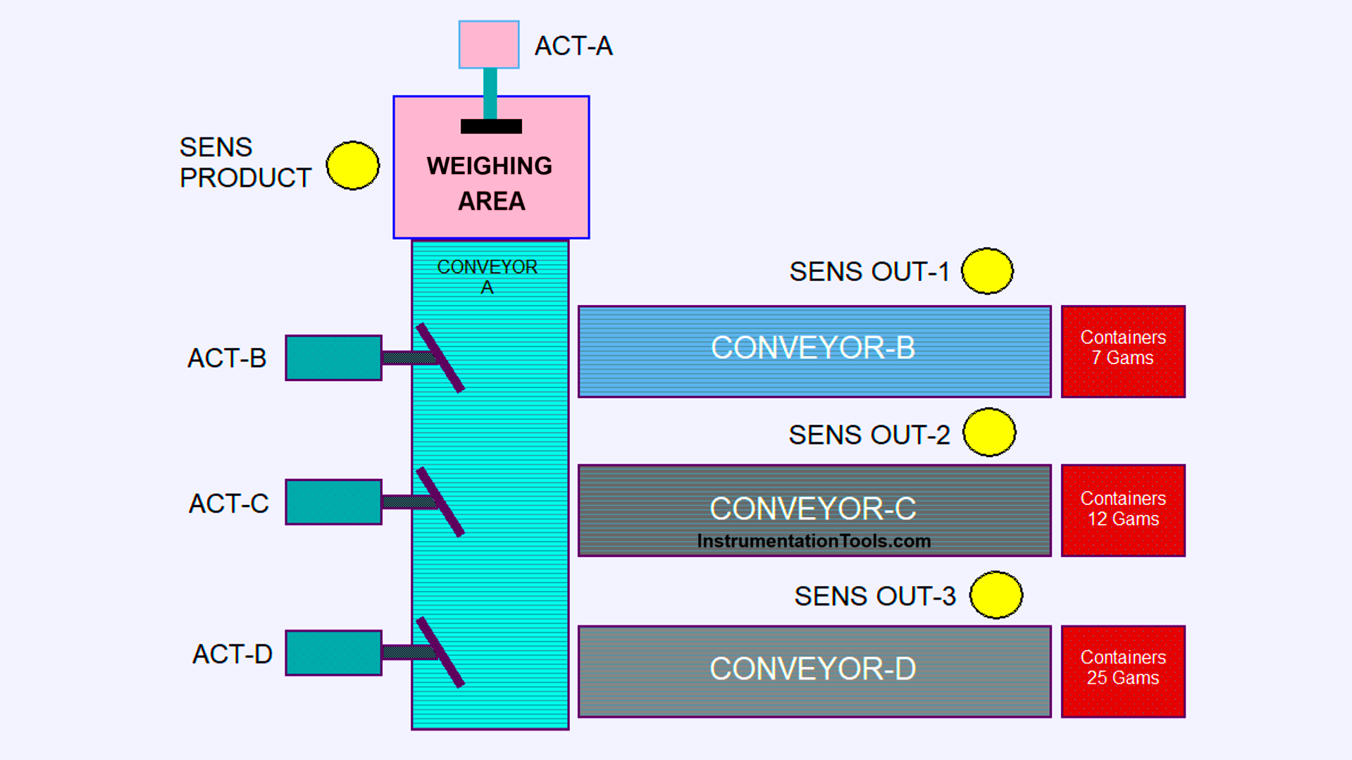

This article discusses product sorting as per their weight classification using the Siemens TIA-Portal. The system is designed to separate products and place them into containers according to their weight categories. The products are classified into three weight categories: 7 grams, 12 grams, and 25 grams. The process begins with weighing the products, followed by transporting them using a conveyor to the appropriate container. This PLC system also includes a feature to count the number of sorted products, with an option to reset the product counter data.

3. Initial Transportation:
- Actuator A is activated to push the product onto Conveyor A.
- Conveyor A starts moving to transport the product.
4. Product Routing:
- The product’s weight data is compared with the predefined threshold values.
- Based on the comparison results:
- If the product’s weight ≤ 7 grams, Actuator B is activated.
- If 7 grams < product’s weight ≤ 12 grams, Actuator C is activated.
- If the product’s weight > 12 grams, Actuator D is activated.
5. Final Transportation:
- The activated actuator pushes the product onto the appropriate conveyor line.
- Appropriate conveyors are activated to send product to the collection containers.

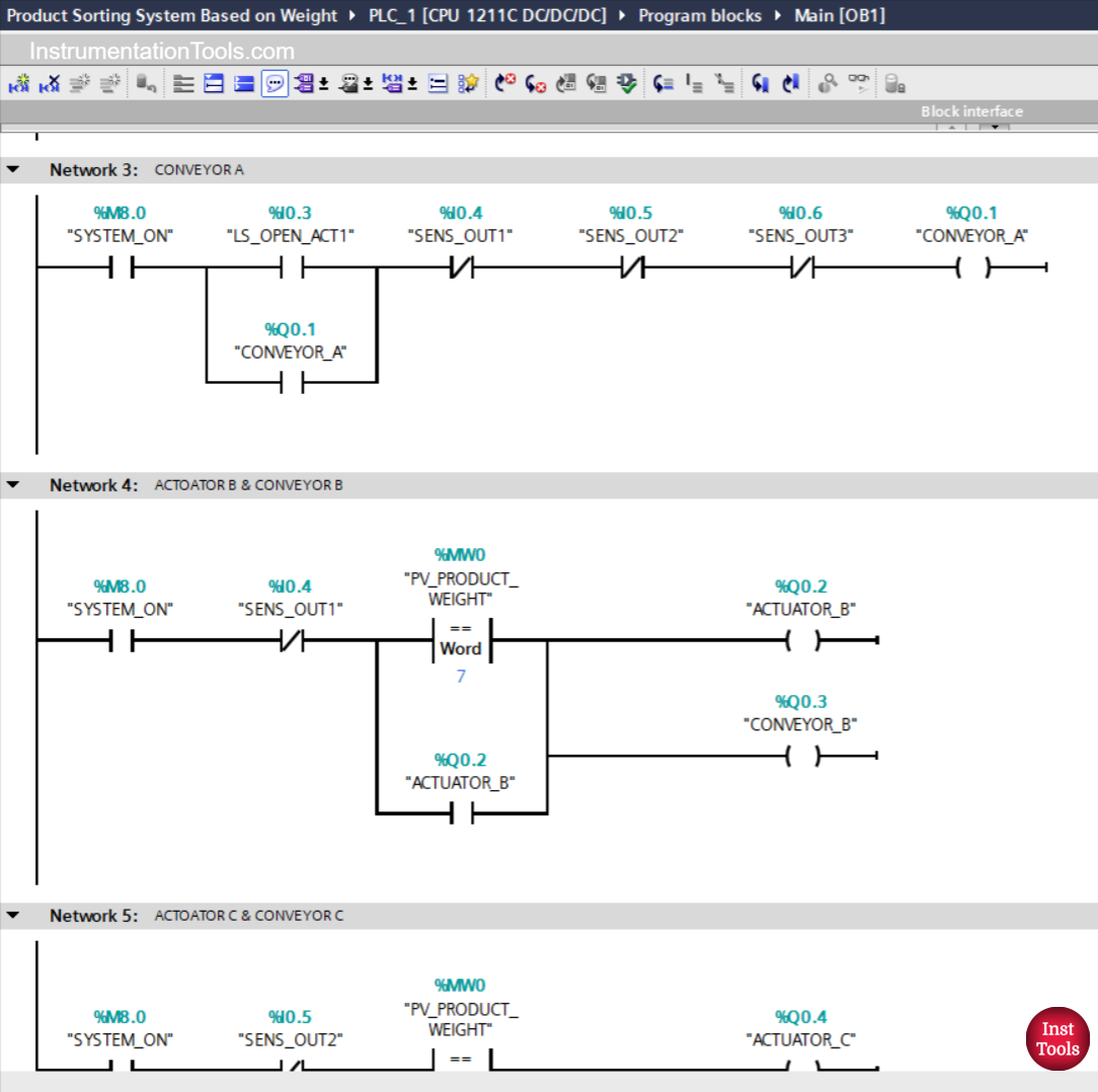

NETWORK 3 (CONVEYOR A ON)
In this network, when the NO contact of the memory bit SYSTEM_ON (M8.0) and Limit Switch LS_OPEN_ACT1 (I0.3) are in the HIGH state, the output CONVEYOR_A (Q0.1) will be ON. Even though the NO contact of the Limit Switch LS_OPEN_ACT1 (I0.3) is in the LOW state, the CONVEYOR_A (Q0.1) output will remain ON because it uses Latching.
If one of the NC contacts of the SENS_OUT1 (I0.4), SENS_OUT2 (I0.5), SENS_OUT3 (I0.6) Sensors is in the HIGH state, then the CONVEYOR_A (Q0.1) output will be OFF.
NETWORK 4 (ACTUATOR B & CONVEYOR B)
In this Network, if the NO contact of the memory bit SYSTEM_ON (M8.0) in the HIGH state and the memory word PV_PRODUCT_WEIGHT (MW0) is Equal To “7”, then the output ACTUATOR_B (Q0.2) and CONVEYOR_B (Q0.3) will be ON. The ACTUATOR_B (Q0.2) and CONVEYOR_B (Q0.3) outputs will remain ON even if the memory word PV_PRODUCT_WEIGHT (MW0) is Not Equal To “7”. Because it uses Latching.
When the NC contact of the SENS_OUT1 (I0.4) sensor is in the HIGH state, the ACTUATOR_B (Q0.2) and CONVEYOR_B (Q0.3) outputs will be OFF.

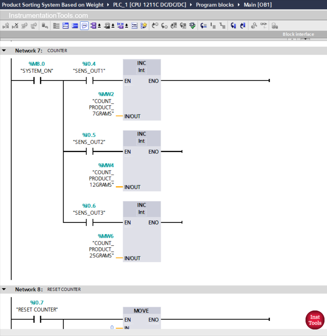

NETWORK 7 (COUNTER)
In this Network, the value in the memory word COUNT_PRODUCT_7GRAMS (MW2) will increase by (+1) if the NO contact of the memory bit SYSTEM_ON (M8.0) and Sensor SENS_OUT1 (I0.4) are in the HIGH state.
The value in the memory word COUNT_PRODUCT_12GRAMS (MW4) will increase by (+1) if the SENS_OUT2 (I0.5) Sensor is in the HIGH state.
The value in the memory word COUNT_PRODUCT_25GRAMS (MW6) will increase by (+1) if the SENS_OUT3 (I0.6) sensor is in the HIGH state.

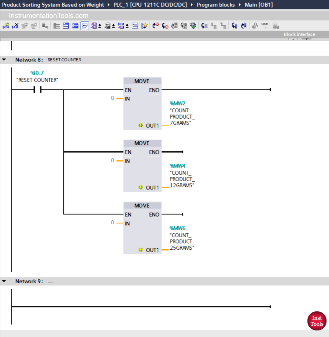

NETWORK 8 (RESET COUNTER)
In this Network, the values in the memory words COUNT_PRODUCT_7GRAMS (MW2), COUNT_PRODUCT_12GRAMS (MW4), and COUNT_PRODUCT_25GRAMS (MW6) will become zero “0” if the RESET COUNTER (I0.7) button is pressed.

The required conditions of waiting are not satisfied in the program; the program is working on the equality == condition, but the program requirement is a range.
