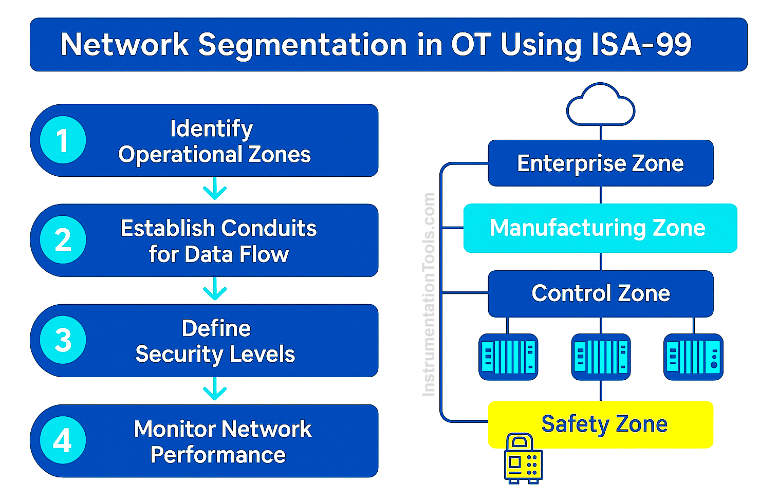

1. First, identify groups of PLCs and SCADA systems that have similar functions and criticality. Based on that, make groups of such devices. This will give a clear identity of the segments to be networked differently.
2. This activity completes your action in the zones. A zone is a group of physical and logical devices sharing the same purpose of operation. Each zone should reflect a logical grouping based on criticality and function.
3. A conduit is a communication path that connects different zones. Conduits can be implemented using firewalls, VPNs, or data diodes. The conduit ensures that data flow between zones is secure and only authorized access is allowed. Each conduit must be configured appropriately based on the data flow needs and security requirements.

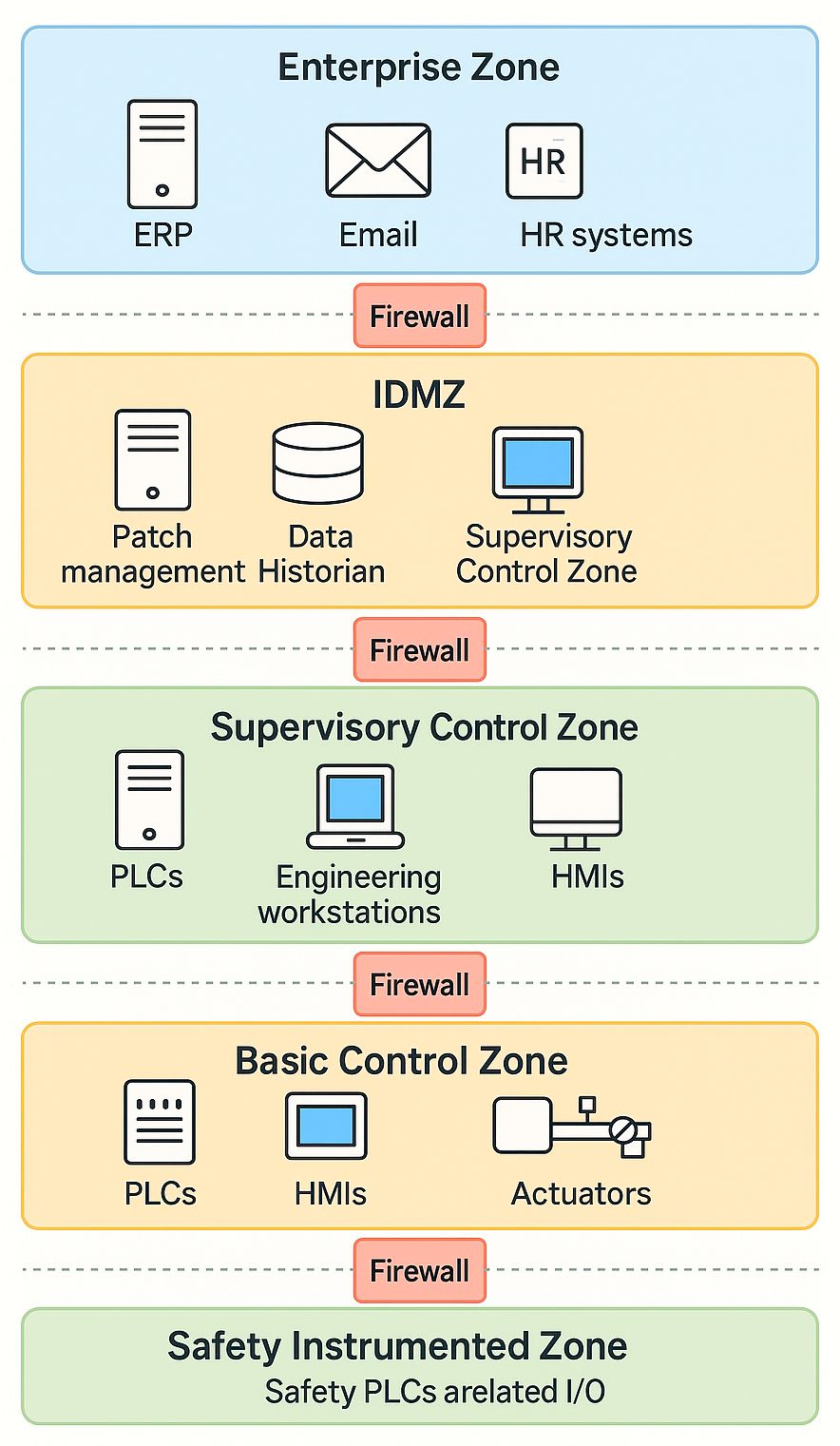

4. Once zones and conduits are identified, assign roles to each:
- Enterprise Zone (Business Network, ERP, MES)
- Supervision Zone (SCADA, HMI systems)
- Control Zone (PLC, RTU, DCS systems)
- Safety Instrumented Zone (SIS controllers, sensors, actuators)
Understand the industrial Ethernet protocols (Modbus TCP/IP, Profinet, Ethernet/IP, etc.) and their compatibility in each segment.
5. Define each zone with a security level from SL1 to SL4:
- SL1: Protection against casual violations
- SL2: Protection against intentional violations using simple means
- SL3: Protection against sophisticated attackers
- SL4: Protection against highly sophisticated and targeted attacks
Assign the security level based on a thorough risk assessment.
Example Layout
Refer to the image below for a conceptual diagram of OT network segmentation. The diagram will typically illustrate hierarchical segmentation starting from the Enterprise Zone at the top to the SIS Zone at the bottom, showing secured conduits between zones according to ISA-99.
