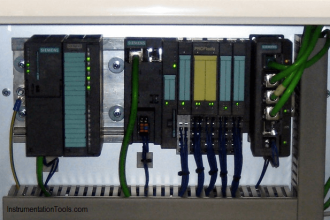

When you are writing a PLC program, the very first thing that you have to do is map the inputs and outputs (IO). PLC digital and analog IO’s must be given proper tag conventions because that defines their proper use in the remainder of the program further.
What does it mean to map I/O in PLC?Types of I/O mapping in PLCMapping I/O tags at hardware configurationMapping I/O tags manually in the program
If the IO’s are not mapped and named properly according to actual field instruments, then the programmer will get confused in developing the logic afterward. There are some common and general methods which need to be followed for doing proper IO mapping in a PLC program. In this post, we will see the techniques for IO mapping in PLC.
