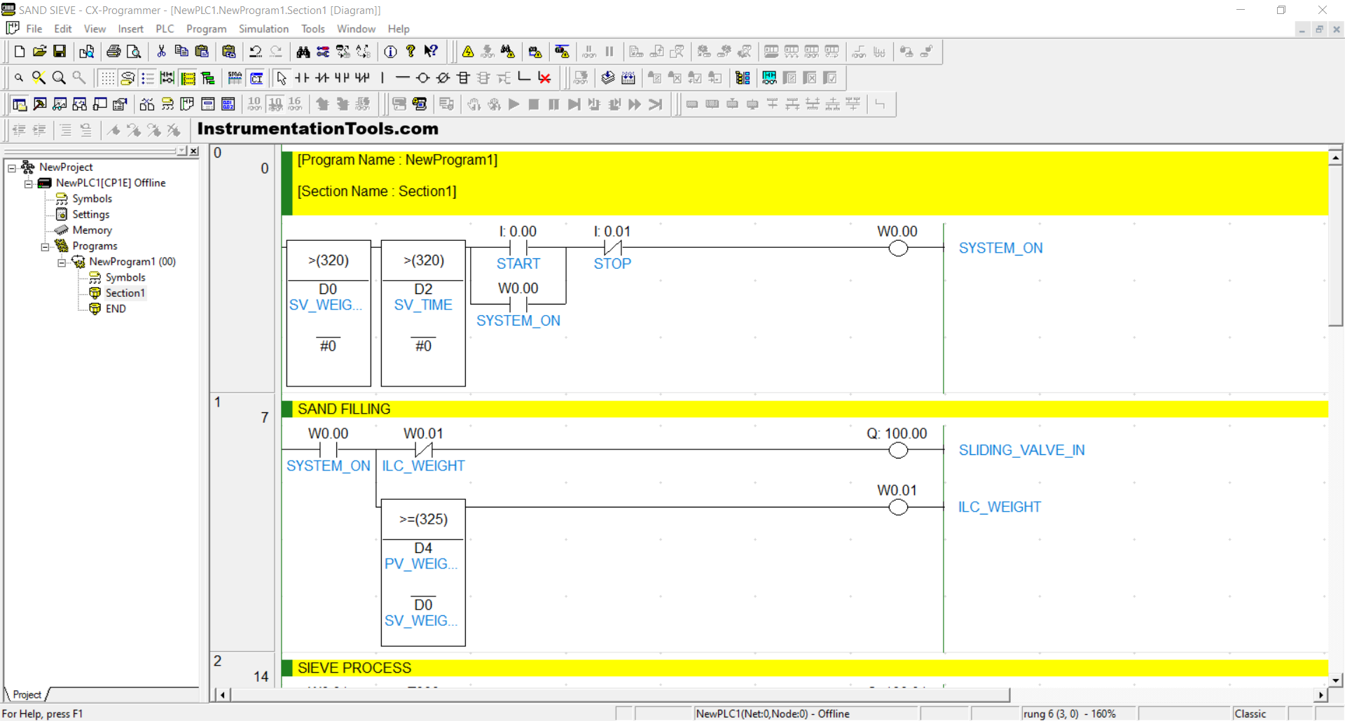

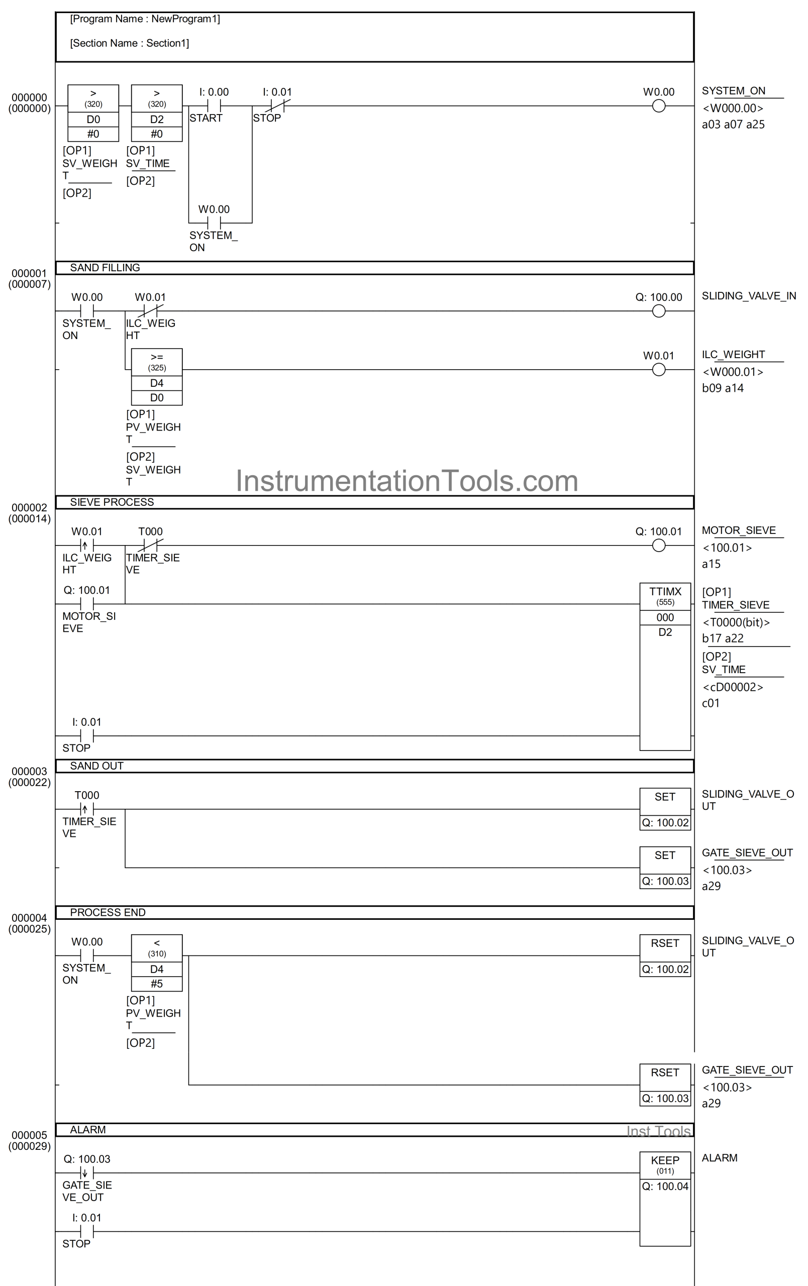

RUNG 0 (START SYSTEM)
In this Rung, if the START (0.00) button is pressed and the value in the memory words SV_WEIGHT (D0) and SV_TIME (D2) is greater than zero “0”, then the memory bit SYSTEM_ON (W0.00) will be in the HIGH state. Because it uses Latching, the memory bit SYSTEM_ON (W0.00) will remain in the HIGH state even though the START(0.00) button has been released.
The memory bit SYSTEM_ON (W0.00) will be in the LOW state if the STOP (0.01) button is pressed.
RUNG 1 (SAND FILLING)
In this Rung, if the NO contact of the memory bit SYSTEM_ON (W0.00) is in the HIGH state, then the SLIDING_VALVE_IN (100.00) output will be OPEN.
When the value in the memory word PV_WEIGHT(D4) is greater than or equal to SV_WEIGHT (D0), the memory bit ILC_WEIGHT (W0.01) will be in the HIGH state, and the SLIDING_VALVE_IN (100.00) output will be CLOSED due to the Interlock.
RUNG 2 (SIEVE PROCESS)
In this Rung, if the NO contact of the memory bit ILC_WEIGHT (W0.01) is in the HIGH state, then the MOTOR_SIEVE (100.01) output will be ON. Because it uses Latching, the MOTOR_SIEVE (100.01) output will remain ON even though the memory bit ILC_WEIGHT (W0.01) is in the LOW state.
The timer TIMER_SIEVE (T000) will start counting, and after it has finished counting, the MOTOR_SIEVE (100.01) output will be OFF due to the interlock.
RUNG 3 (SAND OUT)
When the NO contact of the TIMER_SIEVE (T000) timer is in the HIGH state, then the SLIDING_VALVE_OUT (100.02) and GATE_SIEVE_OUT (100.03) outputs will be OPEN.
Because it uses the SET instruction, the outputs SLIDING_VALVE_OUT (100.02) and GATE_SIEVE_OUT (100.03) will remain OPEN even though the NO contact of the TIMER_SIEVE (T000) timer is in the LOW state.
RUNG 4 (PROCESS END)
In this Rung, when the NO contact of the memory bit SYSTEM_ON (W0.00) is in the HIGH state and the value of the memory word PV_WEIGHT (D4) is less than “5”, the SLIDING_VALVE_OUT (100.02) and GATE_SIEVE_OUT (100.03) outputs will be CLOSED because of the RSET instruction.
RUNG 5 (ALARM)
When the NO contact of GATE_SIEVE_OUT (100.03) is in the HIGH state, the ALARM (100.04) output will be ON and will only be OFF if the STOP (0.01) button is pressed.
