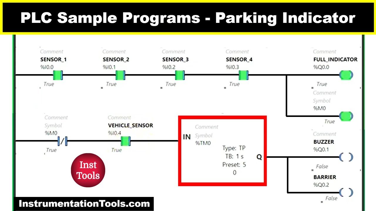

Problem Statement
We are using Five Sensors to control the Full Indicator, Buzzer, and Barrier.
When all parking spots are occupied, a full indicator should be turned ON and also barrier should not be lifted. If the parking spot is vacant and when the vehicle is at the gate, then the buzzer will turn ON and the barrier will be lifted, both for 5 seconds.

Inputs and Outputs
Digital Inputs:
Sensor 1: I0.0
Sensor 2: I0.1
Sensor 3: I0.2
Sensor 4: I0.3
Digital Outputs:
Full Indicator: Q0.0
Buzzer: Q0.1
Barrier: Q0.2

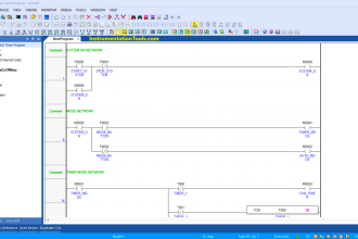

Programming
Parking Garage Indicator PLC Automation
Logic Explained
We have used Normally Open Contacts for Sensor 1 (I0.0), Sensor 2 (I0.1), Sensor 3 (I0.2), Sensor 4 (I0.3) and Vehicle Sensor (I0.4).
In Rung 0:
  1. Normally Open Contacts are used for Sensor 1 (I0.0), Sensor 2 (I0.1), Sensor 3 (I0.2), and Sensor 4 (I0.3) to Turn ON the output Full Indicator (Q0.0) and Memory Bit (M0).
In Rung 1:
  1. Normally Closed Contact is used for Memory Bit  (M0) to Turn ON the outputs Buzzer (Q0.1) and Barrier (Q0.2).
  2. Normally Open Contact is used for the Vehicle Sensor (I0.4) to Turn ON the output Buzzer (Q0.1) and Barrier (Q0.2).
  3. Timer TP is used to Turn ON the outputs Buzzer (Q0.1) and Barrier (Q0.2) for a limited time.
Simulation Results
Test our PLC program and analyze the simulation results.
When Sensor 1 (I0.0), Sensor 2 (I0.1), Sensor 3 (I0.2), and Sensor 4 (I0.3) get activated in Rung0 (All parking spots occupied).
PLC Example on Parking Garage Indicator
Then the output Full indicator (Q0.0) and Memory Bit (M0) turn ON as Normally Open Contacts used for Sensor 1 (I0.0), Sensor 2 (I0.1), Sensor 3 (I0.2), Sensor 4 (I0.3) will be in True state and allows the signal to pass through it and the output Full indicator (Q0.0) and Memory Bit (M0) will turn ON.
When the parking spot is vacant and the sensor detects a vehicle
When one or more than one sensor in Rung0 gets deactivated (one or more than one parking spot is vacant) (e.g Sensor 2 {I0.1} second spot), the output Full indicator (Q0.0) and Memory Bit (M0) turns OFF as Normally Open Contact used for Sensor 2 (I0.1) will be in False state and does not allow the signal to pass through it and the output Full indicator (Q0.0) and Memory Bit (M0) will turn OFF.
Parking Lot Control with PLC Simulator
When Memory Bit (M0) turns OFF in Rung0, Normally Closed Contact used for Memory Bit (M0) in Rung1 will be in a False state and allow the signal to pass through it.
So, When Memory Bit (M0) in Rung1 is in False State and Vehicle Sensor (I0.1) gets activated (Sensor detects Vehicle ), the output Buzzer (Q0.1) will turn ON.
The output Barrier (Q0.2) will also turn ON (Barrier will be lifted) but only for 5 seconds as Timer Function Block type TP is used to turn ON the outputs Buzzer (Q0.1) and Barrier (Q0.2) for a limited time.
The time is set to 5 seconds. After 5 seconds, the outputs Buzzer (Q0.1) and Barrier (Q0.2) will turn OFF.
