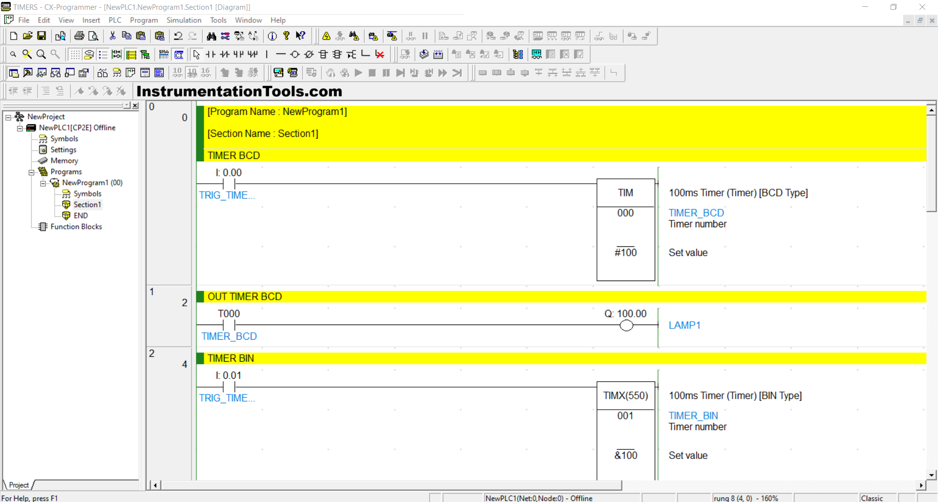

1. TIM Instruction
The TIM instruction is a countdown-type timer with a maximum preset time range of 0–9999.
  1. This instruction counts time in BCD (Binary Coded Decimal) format, so the preset time parameter must be written with the “#” prefix.
  2. The TIM instruction has only one input parameter to activate the instruction and will turn Off if it does not receive a trigger signal.
  3. TIM operates with a time interval of 0.1 seconds (100 ms) and does not retain historical time data.
  4.  In this program, the timer’s preset time is set to 10 seconds by writing #100, and it will turn On Lamp 1.

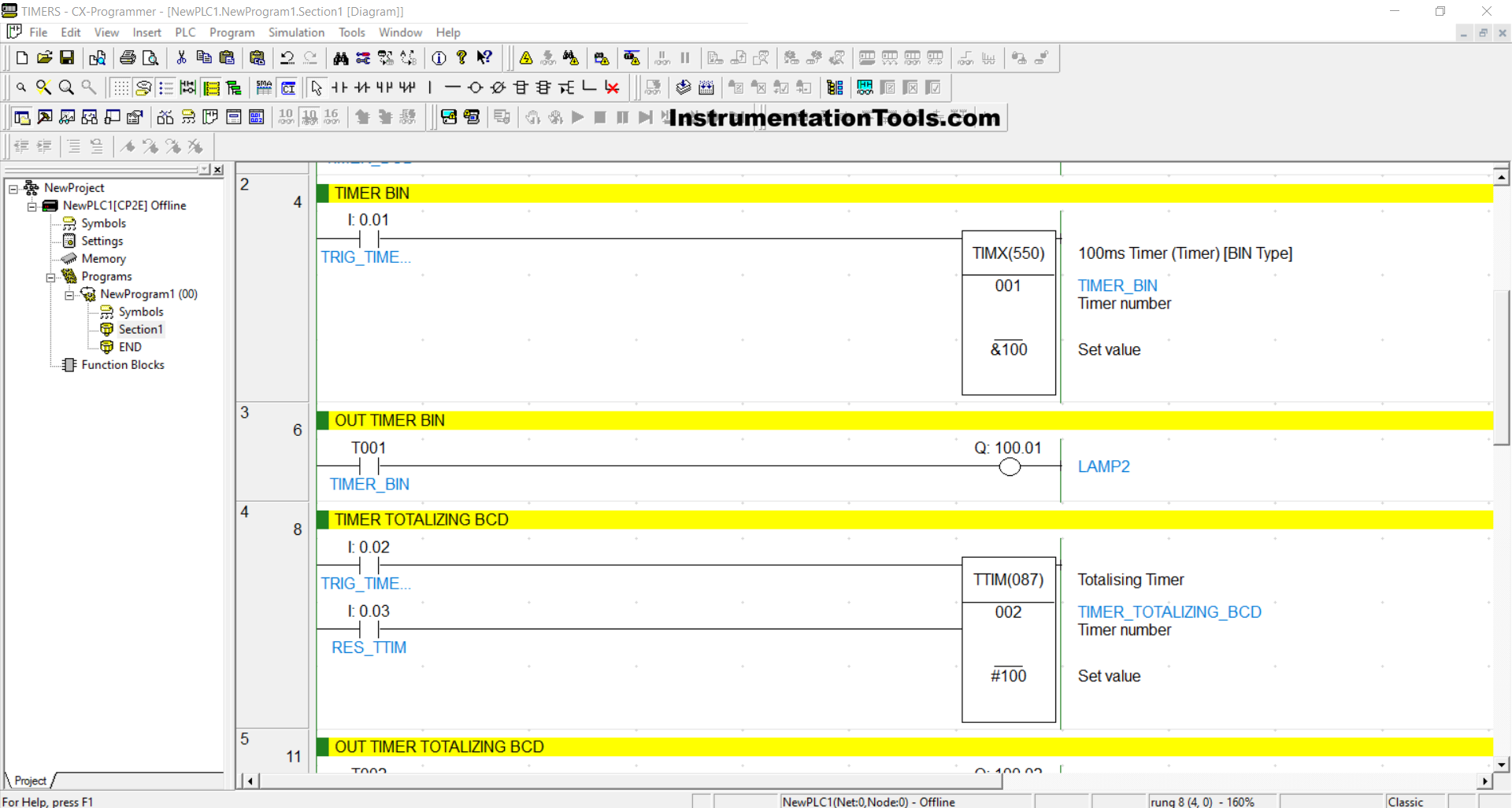

2. TIMX(550) Instruction
The TIMX(550) instruction is a countdown-type timer with a maximum preset time of 0–65535 in decimal format or #0000–#FFFF in hexadecimal format.
  1. The preset time must begin with an “&” if written in decimal format or with a “#” if written in hexadecimal.
  2. The TIMX instruction has only one input parameter to activate the instruction and will turn Off without a trigger signal.
  3. TIMX has a time interval of 0.1 seconds (100 ms) and cannot store time history.
  4. In this program, the timer is set to 10 seconds using the value &100, and it will turn on Lamp 2.
3. TTIM(087) Instruction
The TTIM(087) instruction is a count-up timer, also known as a Totalizing Timer, with a maximum preset time of 0–9999.
  1. This instruction also uses BCD (Binary Coded Decimal) format, requiring the preset time to be written with the “#” prefix.
  2. TTIM(087) has two input parameters: one to activate the instruction and one to reset the stored timer history.
  3. TTIM(087) operates with a 0.1 second (100 ms) interval and can save time history.
  4. In this program, the preset time is set to 10 seconds using #100, and it will turn On Lamp 3.

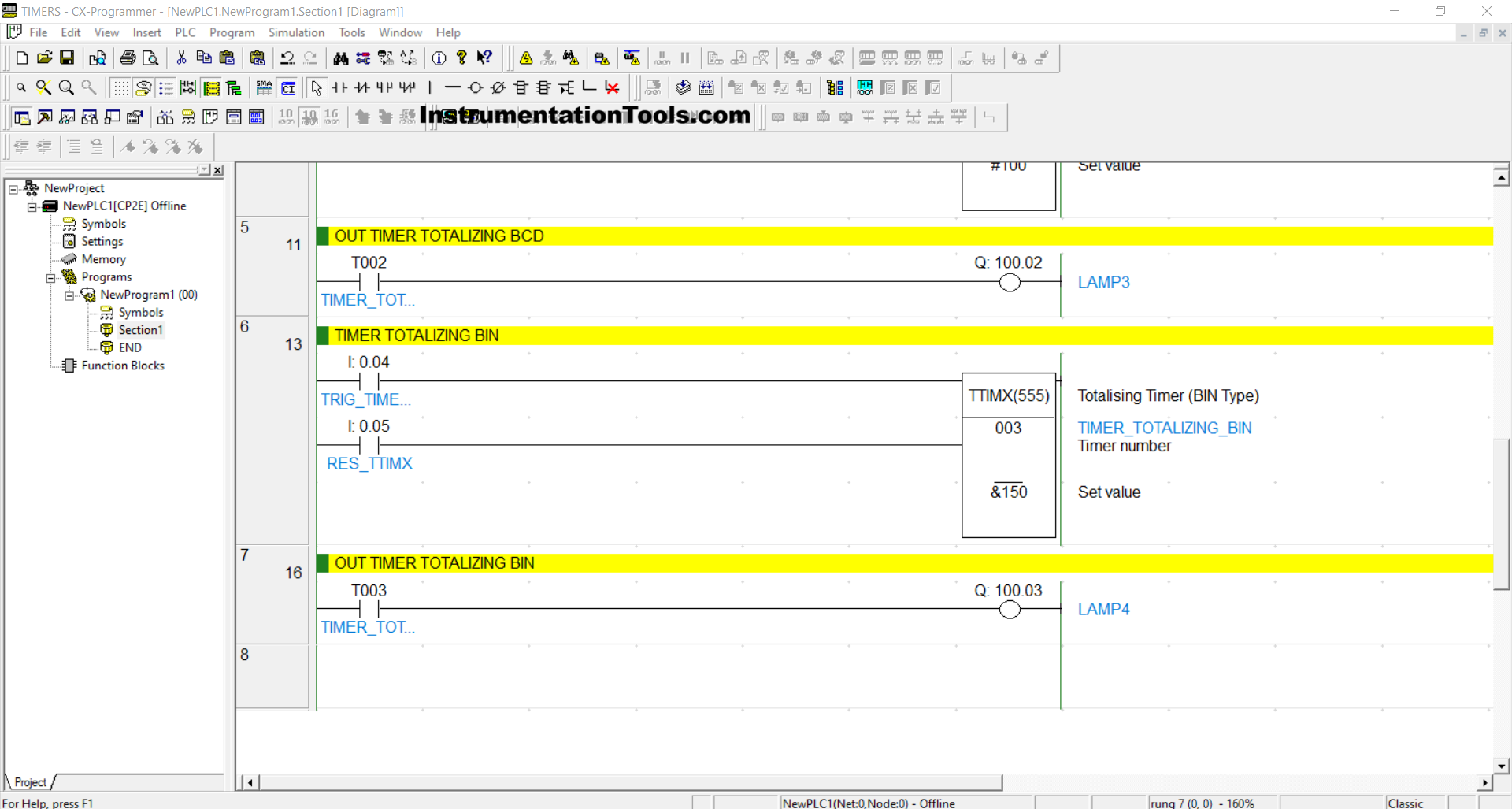

4. TTIMX(555) Instruction
The TTIMX(555) instruction is a count-up timer, also known as a Totalizing Timer, with a maximum preset time of 0–65535 in decimal or #0000–#FFFF in hexadecimal.
  1. The preset value must be prefixed with “&” for decimal or “#” for hexadecimal format.
  2. TTIMX(555) includes two input parameters: one to activate the instruction and one to reset the timer’s stored history.
  3. This timer operates at 0.1 second (100 ms) intervals and can save time history.
  4. In this program, the timer is set to 15 seconds using &150, and it will turn On Lamp 4.

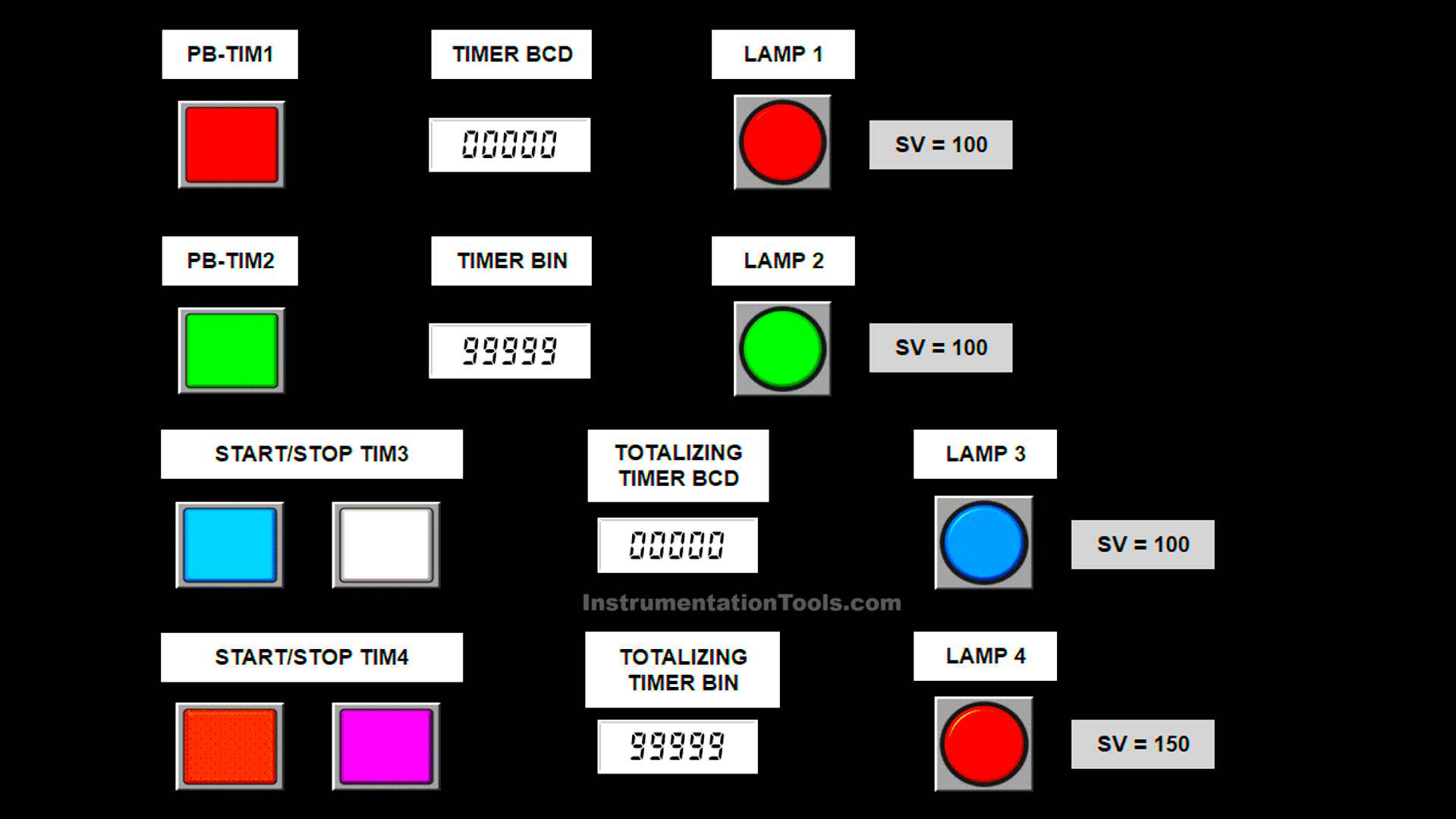

In the video below, we simulated this PLC program of various timers and results displayed.
Omron PLC Timers Simulation

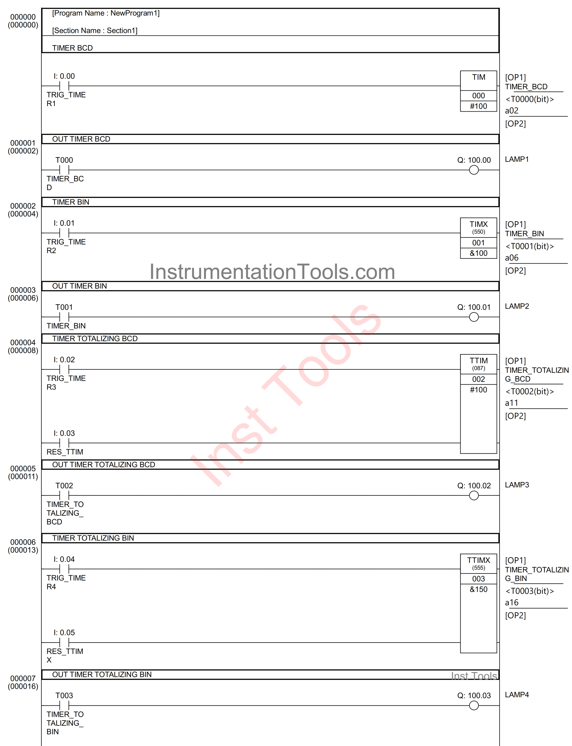

RUNG 0 (TIMER BCD)
In this Rung, if the TRIG_TIMER1 (0.00) button is pressed, then the TIMER_BCD (T000) timer instruction will start counting down for “10” seconds, and when it has finished counting, the TIMER_BCD (T000) timer instruction will be ON.
The TIMER_BCD (T000) timer instruction will be OFF if the TRIG_TIMER1 (0.00) button has been released.
RUNG 1 (OUT TIMER BCD)
In this Rung, the LAMP1 (100.00) output will be ON if the NO contact of TIMER_BCD (T000) is in the HIGH state.
How to Use TIM and TIMX in Omron PLC Programming
RUNG 2 (TIMER BIN)
In this Rung, if the TRIG_TIMER2 (0.01) button is pressed, then the TIMER_BIN (T001) timer instruction will start counting down for “10” seconds, and when it has finished counting, the TIMER_BIN (T001) timer instruction will be ON.
The TIMER_BIN (T001) timer instruction will be OFF if the TRIG_TIMER2 (0.01) button has been released.
RUNG 3 (OUT TIMER BIN)
In this Rung, the LAMP2 (100.01) output will be ON if the NO contact of TIMER_BIN (T001) is in the HIGH state.
RUNG 4 (TIMER TOTALIZING BCD)
In this Rung, if the TRIG_TIMER3 (0.02) button is pressed, then the TIMER_TOTALIZING_BCD (T002) timer instruction will start counting up to “10” seconds, and when it has finished counting, the TIMER_TOTALIZING_BCD (T002) timer instruction will turn ON.
The TIMER_TOTALIZING_BCD (T002) timer instruction will only turn OFF if the RST_TTIM (0.03) button has been pressed.
Practical Timer Application in Omron PLC
RUNG 5 (OUT TIMER TOTALIZING BCD)
In this Rung, the output LAMP3 (100.02) will be ON if the NO contact of TIMER_BCD (T002) is in the HIGH state.
RUNG 6 (TIMER TOTALIZING BIN)
In this Rung, if the TRIG_TIMER4 (0.04) button is pressed, then the TIMER_TOTALIZING_BIN (T003) timer instruction will start counting up to “15” seconds, and when it has finished counting, the TIMER_TOTALIZING_BIN (T003) timer instruction will be ON.
The TIMER_TOTALIZING_BIN (T003) timer instruction will only be OFF if the RST_TTIMX (0.05) button has been pressed.
RUNG 7 (OUT TIMER TOTALIZING BCD)
In this Rung, the LAMP4 (100.03) output will be ON if the NO contact of TIMER_BIN (T003) is in the HIGH state.
