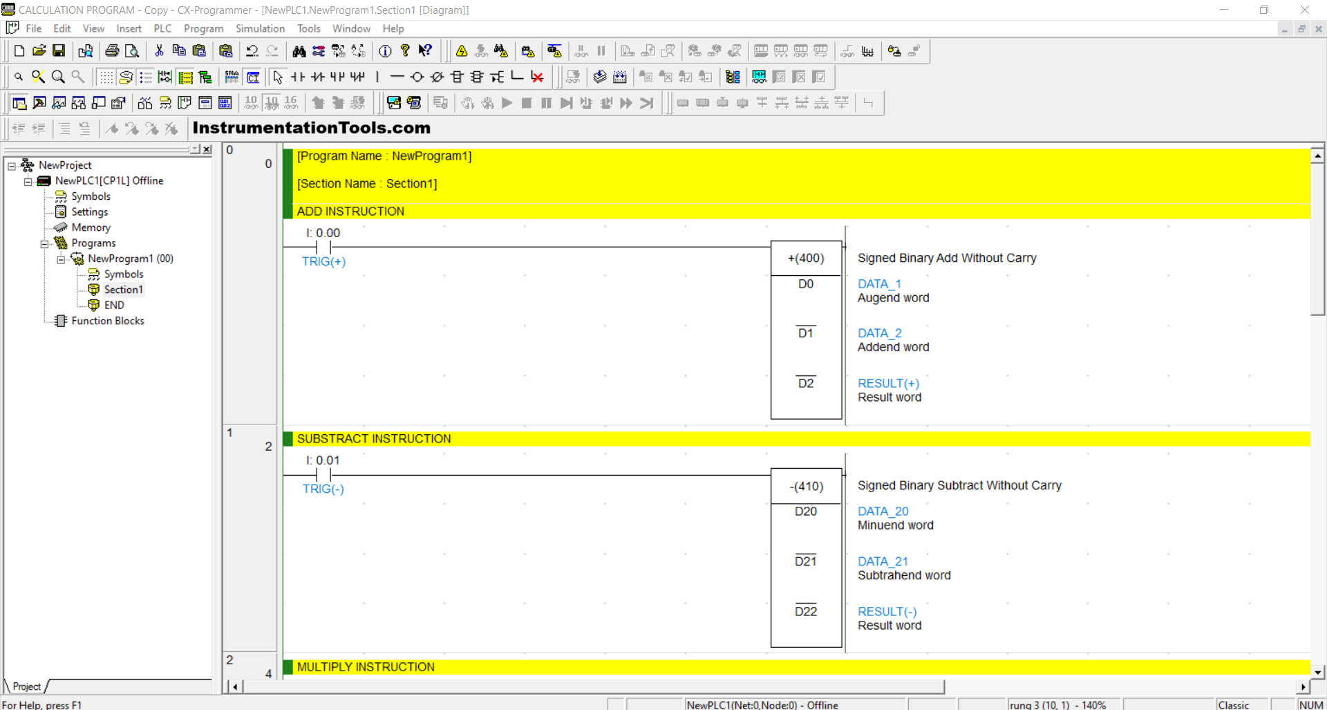

Using Add, Subtract, Multiply, and Divide in CX-Programmer

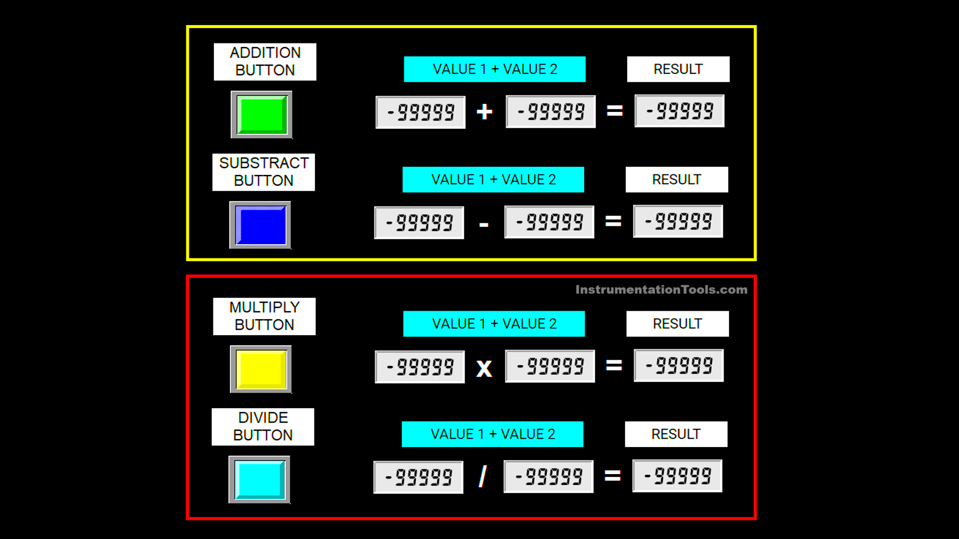

Simulation Video
In the video below, we simulated the Omron PLC math program and showed you the results.
Math Instruction Programming in OMRON PLC

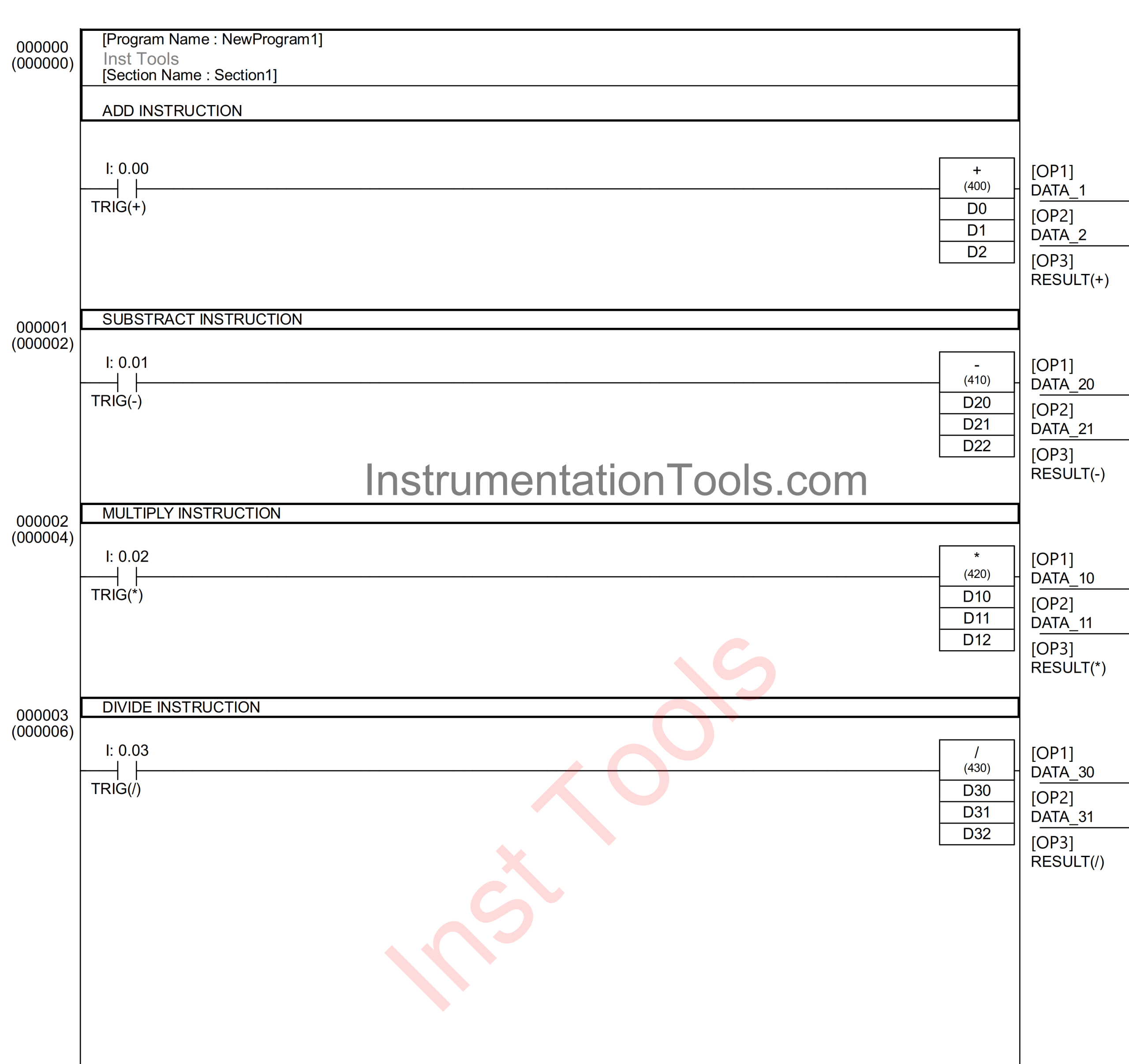

PLC Calculation Logic in OMRON
RUNG 0 (ADD INSTRUCTION)
In this Rung, if the TRIG(+) (0.00) button is pressed, then the +(400) instruction will add the value in the DATA_1 (D0) memory word with the value in the DATA_2 (D1) memory word and the calculation result will be entered into the RESULT(+) (D2) memory word.
RUNG 1 (SUBSTRACT INSTRUCTION)
In this Rung, if the TRIG(-) (0.01) button is pressed, then the -(410) instruction will subtract the value in the DATA_20 (D20) memory word with the value in the DATA_21 (D21) memory word and the calculation result will be entered into the RESULT(-) (D22) memory word.
Simple PLC Arithmetic Instruction Tutorial
RUNG 2 (MULTIPLY INSTRUCTION)
In this Rung, if the TRIG(*) (0.02) button is pressed, then the *(420) instruction will multiply the value in the DATA_10 (D10) memory word with the value in the DATA_11 (D11) memory word and the calculation result will be entered into the RESULT(*) (D12) memory word.
RUNG 3 (DIVIDE INSTRUCTION)
In this Rung, if the TRIG(/) (0.03) button is pressed, then the /(430) instruction will divide the value in the DATA_30 (D30) memory word with the value in the DATA_31 (D31) memory word and the calculation result will be entered into the RESULT(/) (D32) memory word.
