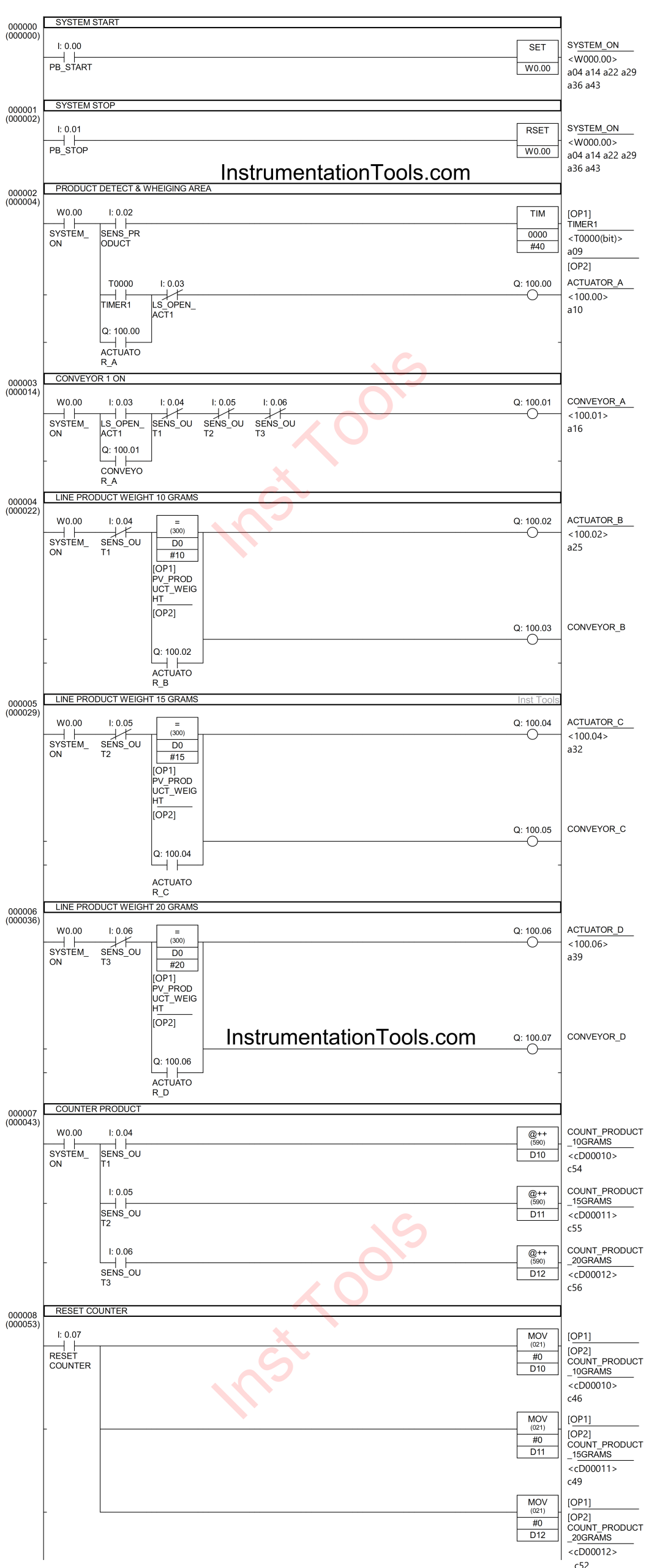

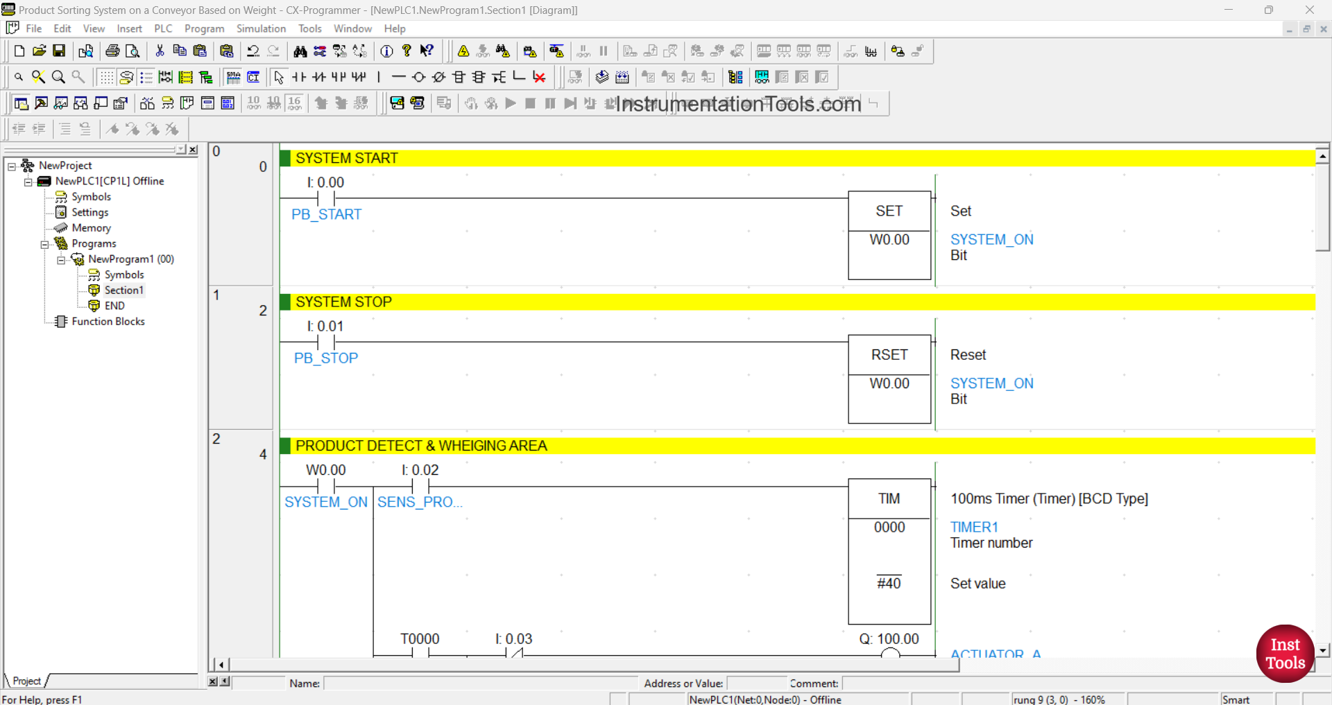

RUNG 0 (SYSTEM START)
In this rung, if the PB_START (0.00) button is pressed, the memory bit SYSTEM_ON (W0.00) will be in the HIGH state. Because it uses the SET instruction, the memory bit SYSTEM_ON (W0.00) will remain in the HIGH state even though the PB_START (0.00) button has been released.
RUNG 1 (SYSTEM STOP)
In this rung, if the PB_STOP (0.01) button is pressed, the memory bit SYSTEM_ON (W0.00) will be in the LOW state. Because it uses the RSET instruction, the memory bit SYSTEM_ON (W0.00) will remain in the LOW state even though the PB_STOP (0.00) button has been released.
RUNG 2 (PRODUCT DETECT & WHEIGING AREA)
In this Rung, if the NO contact of the memory bit SYSTEM_ON (W0.00) and the SENS_PRODUCT (0.02) Sensor are in the HIGH state, then the TIMER1 (T0000) timer will start counting up to 4 seconds.
After Timer TIMER1 (T0000) has finished counting, Output ACTUATOR_A (100.00) will be ON. The ACTUATOR_A (100.00) output will be OFF when the NC contact of the Limit Switch LS_OPEN_ACT1 (0.03) is in the HIGH state.
RUNG 3 (CONVEYOR 1 ON)
In this Rung, the CONVEYOR_A (100.01) output will be ON when the NO contact of the Limit Switch LS_OPEN_ACT1 (0.03) is in the HIGH state. Because it uses Latching, the CONVEYOR_A (100.01) output will remain ON even though the NO contact of the Limit Switch LS_OPEN_ACT1 (0.03) is in the LOW state.
The CONVEYOR_A (100.01) output will be OFF if one of the NC contacts of the SENS_OUT1 (0.04), SENS_OUT2 (0.05), SENS_OUT3 (0.06) sensors is in the HIGH state.

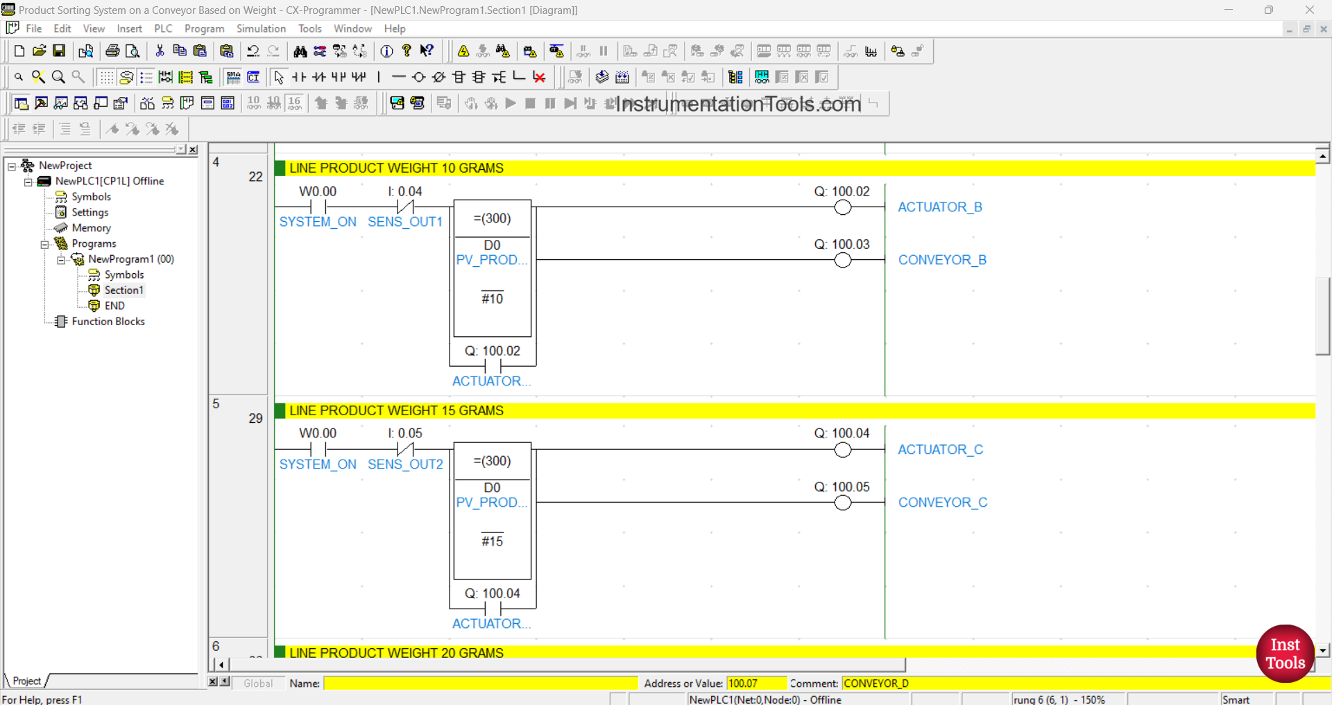

RUNG 4 (LINE PRODUCT WEIGHT 10 GRAMS)
In this Rung, the outputs ACTUATOR_B (100.02) and CONVEYOR_B (100.03) will be ON when the NO contact of the memory bit SYSTEM_ON (W0.00) in the HIGH state and the memory word PV_PRODUCT_WEIGHT (D0) is Equal To “10”. Because it uses Latching, the output ACTUATOR_B (100.02) and CONVEYOR_B (100.03) will remain ON even though the memory word PV_PRODUCT_WEIGHT (D0) is Not Equal To “10”.
The ACTUATOR_B (100.02) and CONVEYOR_B (100.03) outputs will be OFF if the NC contact of the SENS_OUT1 (0.04) sensor is in the HIGH state.
RUNG 5 (LINE PRODUCT WEIGHT 15 GRAMS)
In this Rung, the outputs ACTUATOR_C (100.04) and CONVEYOR_C (100.05) will be ON when the NO contact of the memory bit SYSTEM_ON (W0.00) is in the HIGH state and the memory word PV_PRODUCT_WEIGHT (D0) is Equal To “15”. Because it uses Latching, the output ACTUATOR_C (100.04) and CONVEYOR_C (100.05) will remain ON even though the memory word PV_PRODUCT_WEIGHT (D0) is Not Equal To “15”. Output ACTUATOR_C (100.04) and CONVEYOR_C (100.05) will be OFF if contact NC of Sensor SENS_OUT2 (0.05) is in state HIGH state.
RUNG 6 (LINE PRODUCT WEIGHT 20 GRAMS)
In this Rung, the outputs ACTUATOR_D (100.06) and CONVEYOR_D (100.07) will be ON when the NO contact of the memory bit SYSTEM_ON (W0.00) in the HIGH state and the memory word PV_PRODUCT_WEIGHT (D0) is Equal To “20”. because it uses Latching, the output ACTUATOR_D (100.06) and CONVEYOR_D (100.07) will remain ON even though the memory word PV_PRODUCT_WEIGHT (D0) is not equal to “20”.
The ACTUATOR_D (100.06) and CONVEYOR_D (100.07) outputs will be OFF if the NC contact of the SENS_OUT3 (0.06) sensor is in the HIGH state.

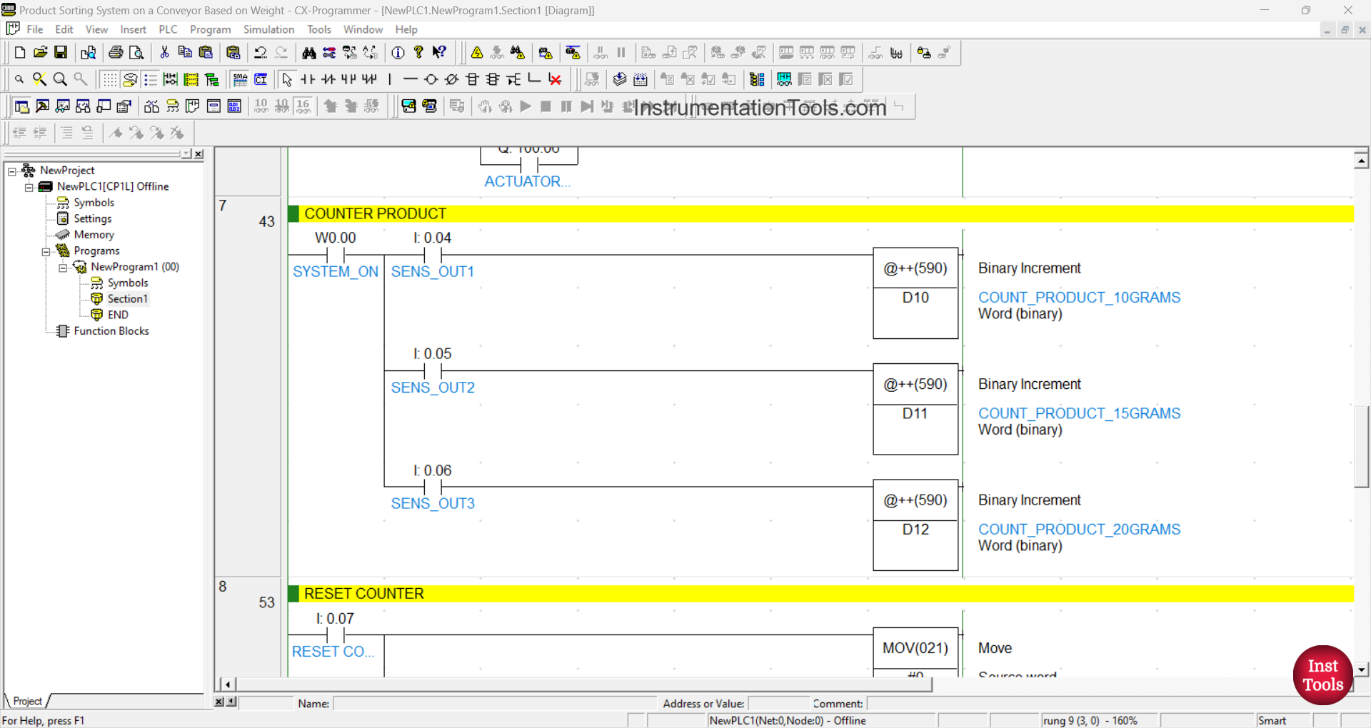

RUNG 7 (COUNTER PRODUCT)
In this Rung, when the NO contact of the memory bit SYSTEM_ON (W0.00) and Sensor SENS_OUT1 (0.04) are in the HIGH state, the value in the memory word COUNT_PRODUCT_10GRAMS (D10) will increase by (+1).
If Sensor SENS_OUT2 (0.05) is in the HIGH state, then the value in the memory word COUNT_PRODUCT_15GRAMS (D11) will increase by (+1).
If the SENS_OUT3 (0.06) sensor is in the HIGH state, then the value in the memory word COUNT_PRODUCT_20GRAMS (D12) will increase by (+1).
RUNG 8 (RESET COUNTER)
In this rung, when the RESET COUNTER (0.07) button is pressed, the values in the memory words COUNT_PRODUCT_10GRAMS (D10), COUNT_PRODUCT_15GRAMS (D11), and COUNT_PRODUCT_20GRAMS (D12) will become zero “0”.
