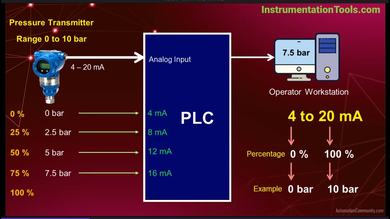

In most environments, the majority of transmitters are wired using a 4–20 mA current loop, possibly with HART.
Normally these are very reliable but can develop problems capable of causing inaccurate readings.
Loop Integrity Diagnostic
In a typical plant environment, a pressure transmitter’s analog current loop may involve a long cable, potentially several hundred feet or more, between the transmitter and the host system I/O connection.
A current loop is very robust, so this does not necessarily pose a challenge if all the elements are intact.
However, a long cable could easily have a dozen termination points from one end to the other as it passes through trays and marshaling cabinets. Screw terminals that have worked loose or become corroded can cause a signal to be lost completely.
A short circuit can also cut off data. The live zero feature of the loop will usually call attention to a full signal loss.
