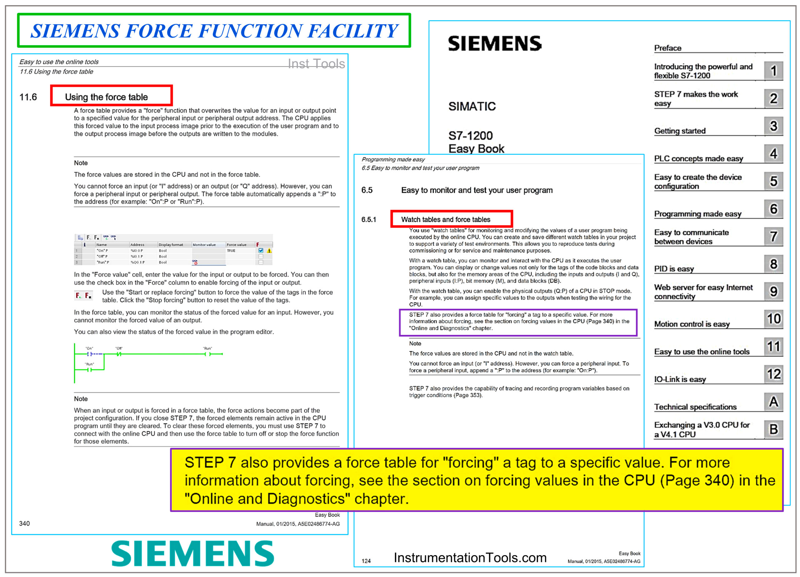

SIEMENS S7 SYSTEM
SIEMENS also provides Force facility, and in the section “Easy to monitor and test your program”, it was explained about watch tables and force tables, and declares that:
“STEP-7 also provides a force table for “forcing” a tag to a specific value. For more information about forcing, see the section on forcing values in CPU (page 340) in the “Online and Diagnostic” chapter.”
As it can be seen on page 340 of the SIEMENS document, the Forcing can be easily done and monitored by the force table. For the Override facility, similarly, it will be provided during the design engineering of the project logic diagram (and considered signal communications with Process Control System), and according to applicable requested project specification requirements.
Figure 3: SIEMENS Force Function Facility.

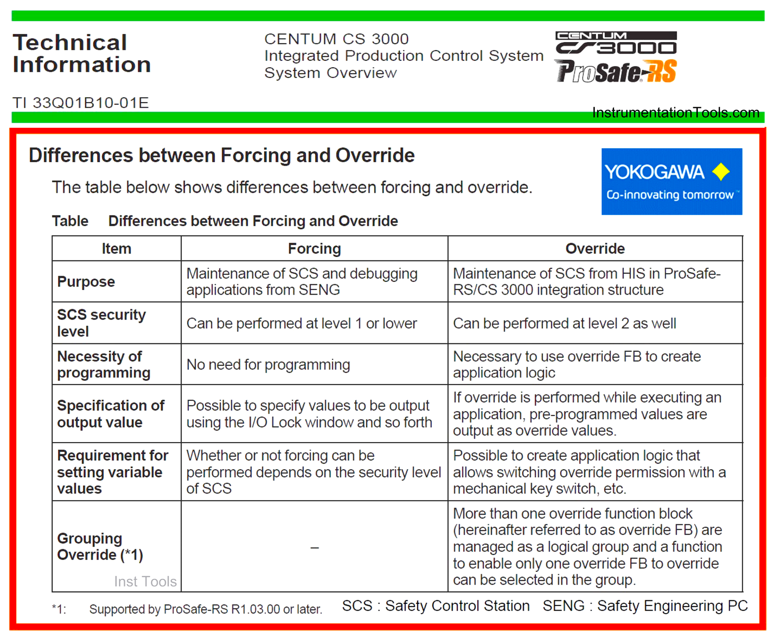

Although YOKOGAWA provides both Forcing and Override Facilities for Prosafe-RS, the differences between the two facilities are clarified in the document too (Figure 7).
Figure 7: Differences between Forcing and Override in Yokogawa Prosafe-RS
As it is clear from the purpose difference, Override is implemented in the integration of Prosafe-RS with the CS-3000 structure. In fact, the Override facility will be more regular and informative, so that it can be used by higher-level process management software like Exaquantum/ OSA (Override Safety Advisor) for improving safety and operator performance. Some of the advantages of hiring OSA can be found in Figure 8.
