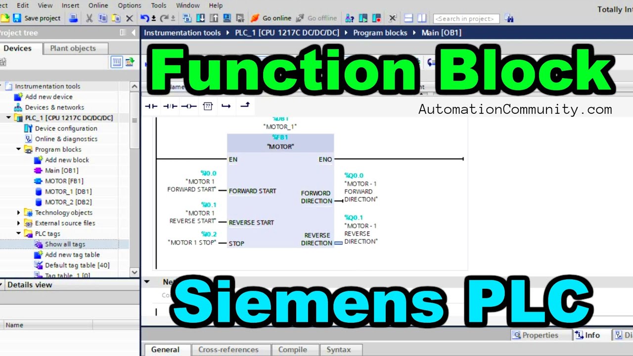

What is a function block in TIA Portal?
Let us first start with a function block. Refer to the image below. A function block is represented by a blue symbol, as shown in the left-hand bar with the name we highlighted, for example, Motor_Avail_Logic. It has the following parameters: input, output, inout, static, temp, and constant. So basically, you can link your own inputs and outputs, and create a logic inside the function block. Once you take a new FB, it will ask you to create a new instance DB or data block. This means that each FB will have its own data block for storing the values. Every instance of an FB is thus defined by its own data block.
In FB, you have the main advantage of retaining the current values inside each of its instances used, which are independent. Due to this, it is ideal for logic that is used multiple times in the same way, and requires storing its last values even after a power off. But as it is a function block, it is of no use in the logic if any of its instance is not used in the program. This is because, like a normal logic section that you write and call in a task configuration, this is not a normal logic section but a function block.

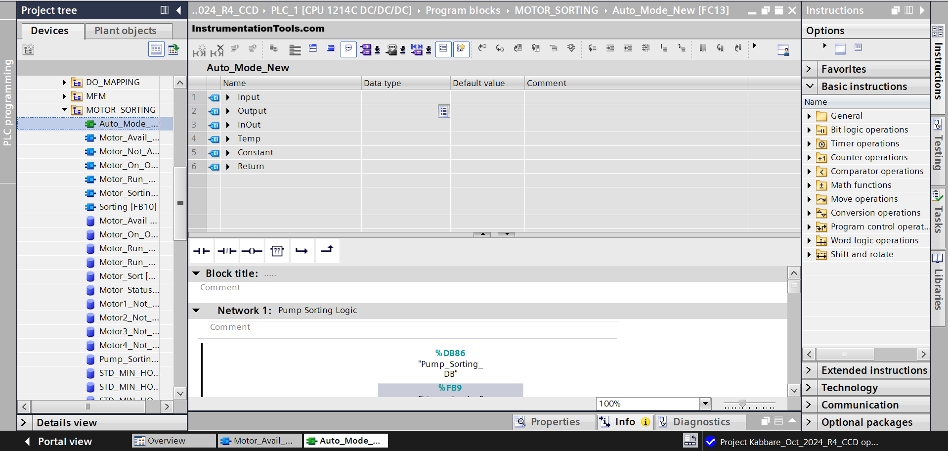

What is a function call in TIA Portal?
Let us now proceed with a function call. Refer to the image below. A function call is represented by a green symbol, as shown in the left-hand bar with the name we highlighted, for example – Auto_Mode_New.
It has the following parameters: input, output, inout, return, temp, and constant. So basically, you can link your own inputs and outputs, and create a logic inside the function call. Once you take a new FC, it will not ask you to create a new instance DB or data block. This means that each FC will not have its own data block for storing the values. Every instance of an FC is thus not defined by its own data block.
In FC, you have the main point of not retaining the current values inside each of its instances, which are independent. Due to this, it is ideal for logic that is used multiple times in the same way, and does not store its last values after power off. But as it is a function call, it is of no use in the logic if it is not called in the task configuration of the CPU. This means that FC is a normal logic section that we use in the program to write logic, and can also as a purpose of a function block with multiple instances, the difference being that it will not have it’s own DB and not be able to store the last hold values inside each of it’s instances.
