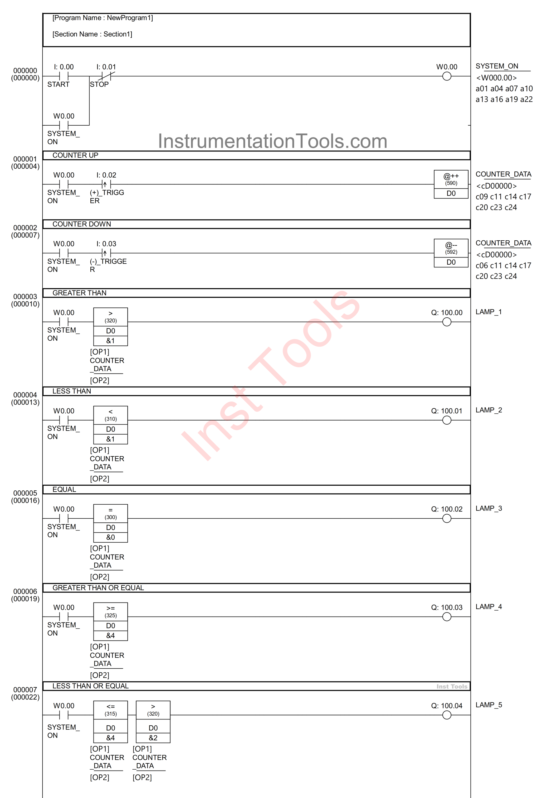

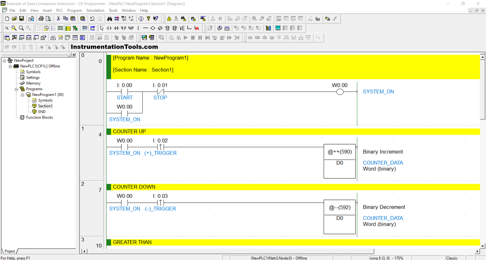

RUNG 0 (SYSTEM_ON)
In this Rung, if the START (0.00) button is pressed, the memory bit SYSTEM_ON (W0.00) will be in a HIGH state. Because it uses Latching, the memory bit SYSTEM_ON (W0.00) will remain in a HIGH state even though the PB_START (0.00) button has been released.
The memory bit SYSTEM_ON (W0.00) will return to a LOW state if the STOP (0.01) button is pressed.
RUNG 1 (COUNTER UP)
In this rung, when the NO contact of the memory bit SYSTEM_ON (W0.00) is in a HIGH state and the (+)_TRIGGER (0.02) button is pressed, the value in the memory word COUNTER_DATA (D0) will increase by +1 due to the use of the Binary Increment / @++ (590) instruction.
The Binary Increment / @++ (590) instruction will add (+1) to the memory word data when triggered.
RUNG 2 (COUNTER DOWN)
In this rung, when the NO contact of the memory bit SYSTEM_ON (W0.00) is in a HIGH state and the (-)_TRIGGER (0.03) button is pressed, the value in the memory word COUNTER_DATA (D0) will decrease by -1 due to the use of the Binary Decrement / @– (592) instruction.
The Binary Decrement / @– (592) instruction will subtract (-1) from the memory word data when triggered.

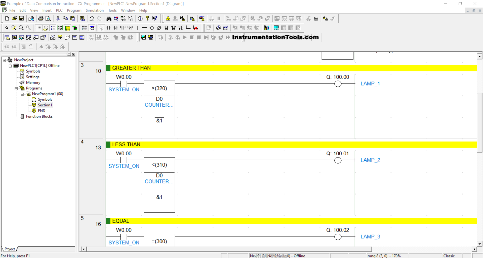

RUNG 3 (GREATER THAN)
In this Rung, if the contact NO of the memory bit SYSTEM_ON (W0.00) is in the HIGH state and the value in the memory word COUNTER_DATA (D0) is Greater Than “1”, then the output LAMP_1 (100.00) will be ON.
RUNG 4 (LESS THAN)
In this Rung, if the NO contact of the memory bit SYSTEM_ON (W0.00) is in the HIGH state and the value in the memory word COUNTER_DATA (D0) is Less Than “1”, then the output LAMP_2 (100.01) will be ON.

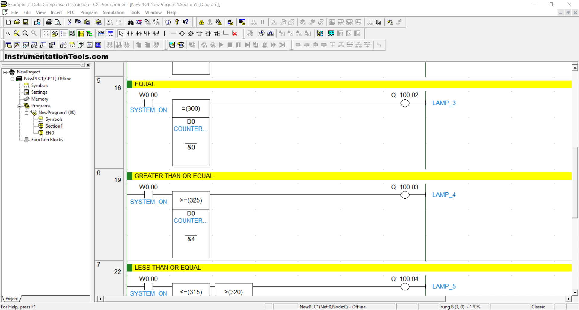

RUNG 5 (EQUAL)
In this Rung, if the contact NO of the memory bit SYSTEM_ON (W0.00) is in the HIGH state and the value in the memory word COUNTER_DATA (D0) is Equal To “0”, then the output LAMP_3 (100.02) will be ON.

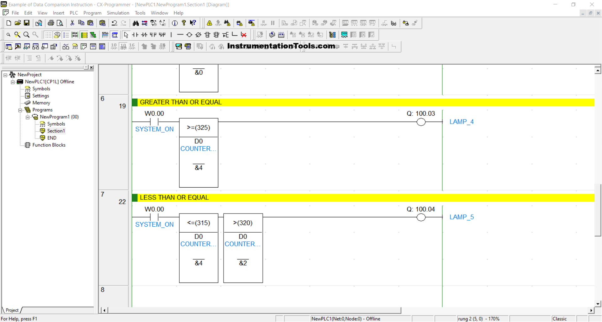

RUNG 6 (GREATER THAN OR EQUAL)
In this Rung, if the NO contact of the memory bit SYSTEM_ON (W0.00) is in the HIGH state and the value in the memory word COUNTER_DATA (D0) is Greater Than or Equal To “4”, then the LAMP_4 (100.03) output will be ON.
RUNG 7 (LESS THAN OR EQUAL)
In this Rung, if the NO contact of the memory bit SYSTEM_ON (W0.00) is in HIGH state and the value of the memory word COUNTER_DATA (D0) is Less Than or Equal To “4” and Greater Than “2”, then the LAMP_5 (100.04) output will be ON.
