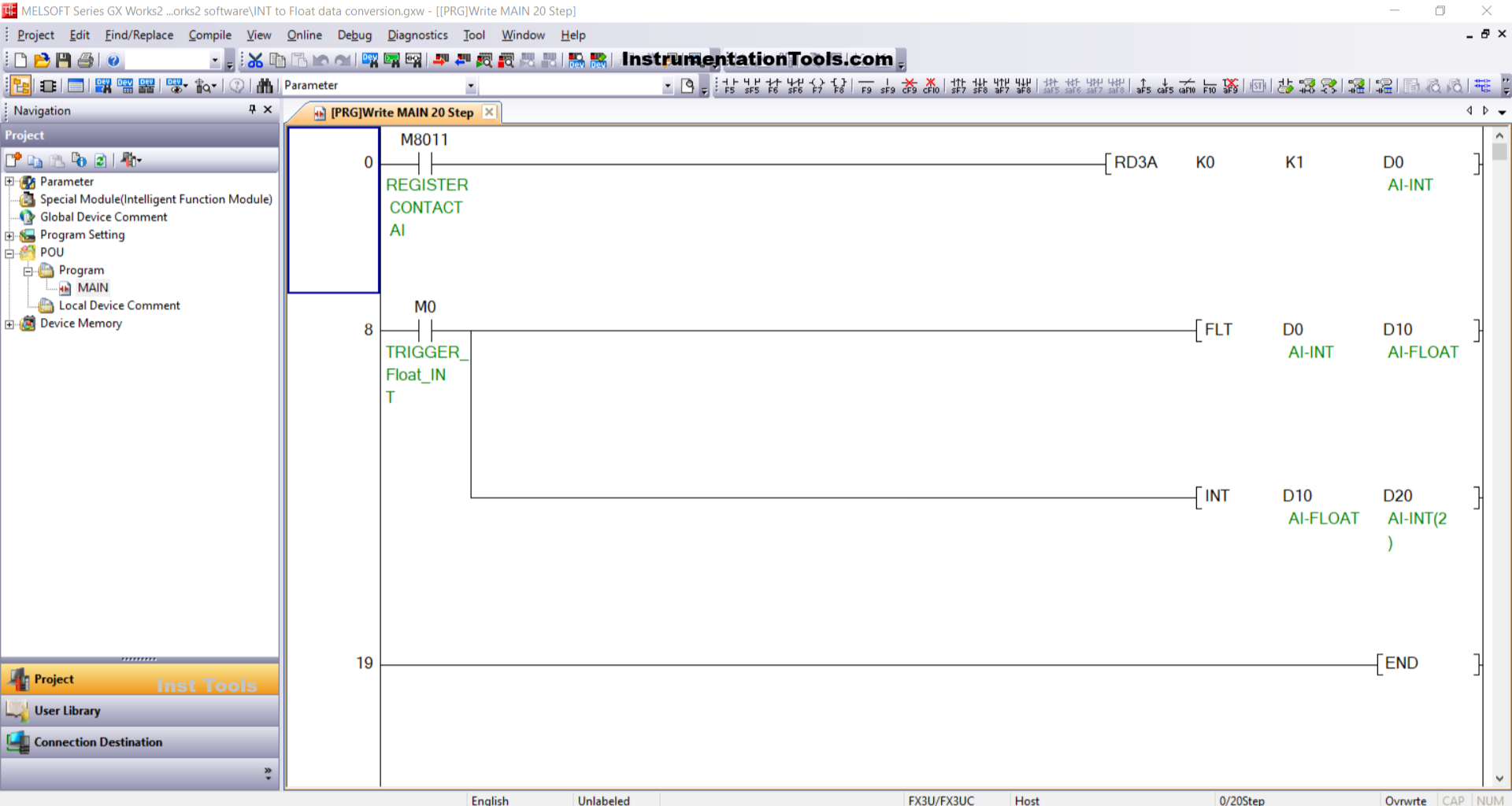

Convert Integer to Float in Ladder Logic
IO Mapping Details
S.No. | Comment | Memory Bit | Memory Word |
1 | TRIGGER_Float_INT | M0 | |
2 | REGISTER CONTACT AI | M8011 | |
3 | AI-INT | D0 | |
4 | AI-FLOAT | D10 | |
5 | AI-INT(2) | D20 |
Mitsubishi PLC Programming

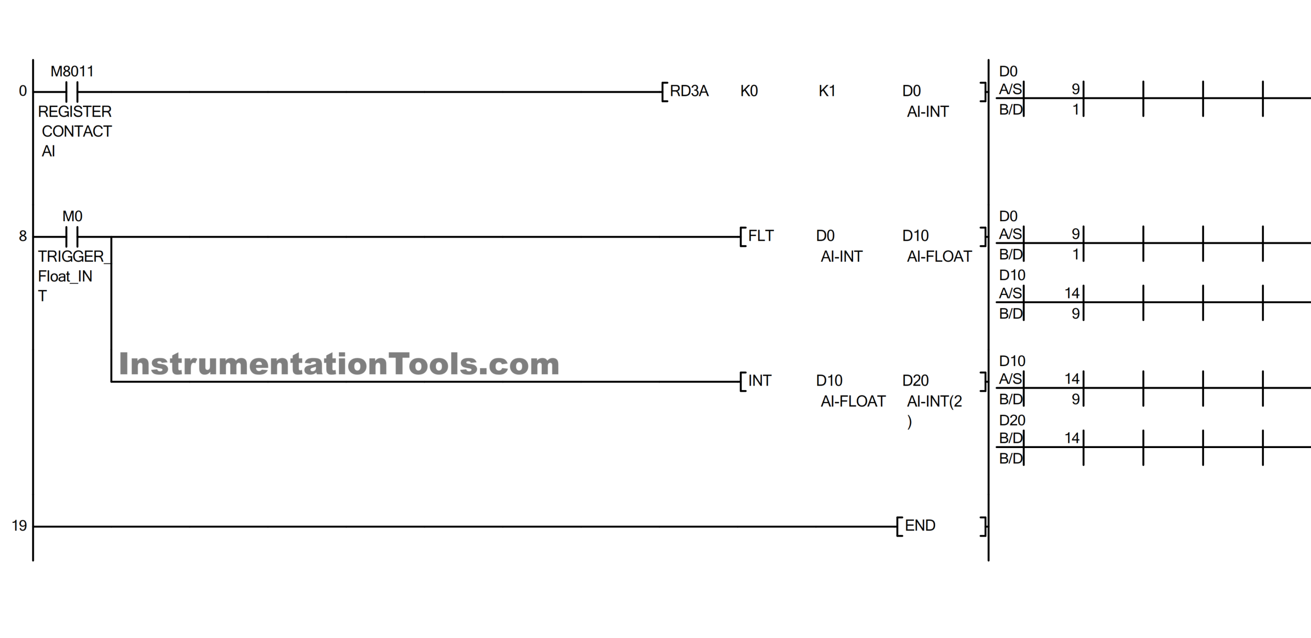

RUNG 0
In this rung, when the NO contact from memory bit REGISTER CONTACT AI (M8011) is in the HIGH state, the RD3A instruction is activated. The RD3A instruction reads the data from Analog Input 1 and stores it into the memory word AI-INT (D0).
RUNG 8
When the NO contact from memory bit TRIGGER_Float_INT (M0) is in the HIGH state, the FLT instruction converts the data from memory word AI-INT (D0) into Float format and stores it in the memory word AI-FLOAT (D10).
Next, the INT instruction will convert the Float format data in the memory word AI-FLOAT(D10) into Integer Format data in the memory word AI-INT(2) (D20).
