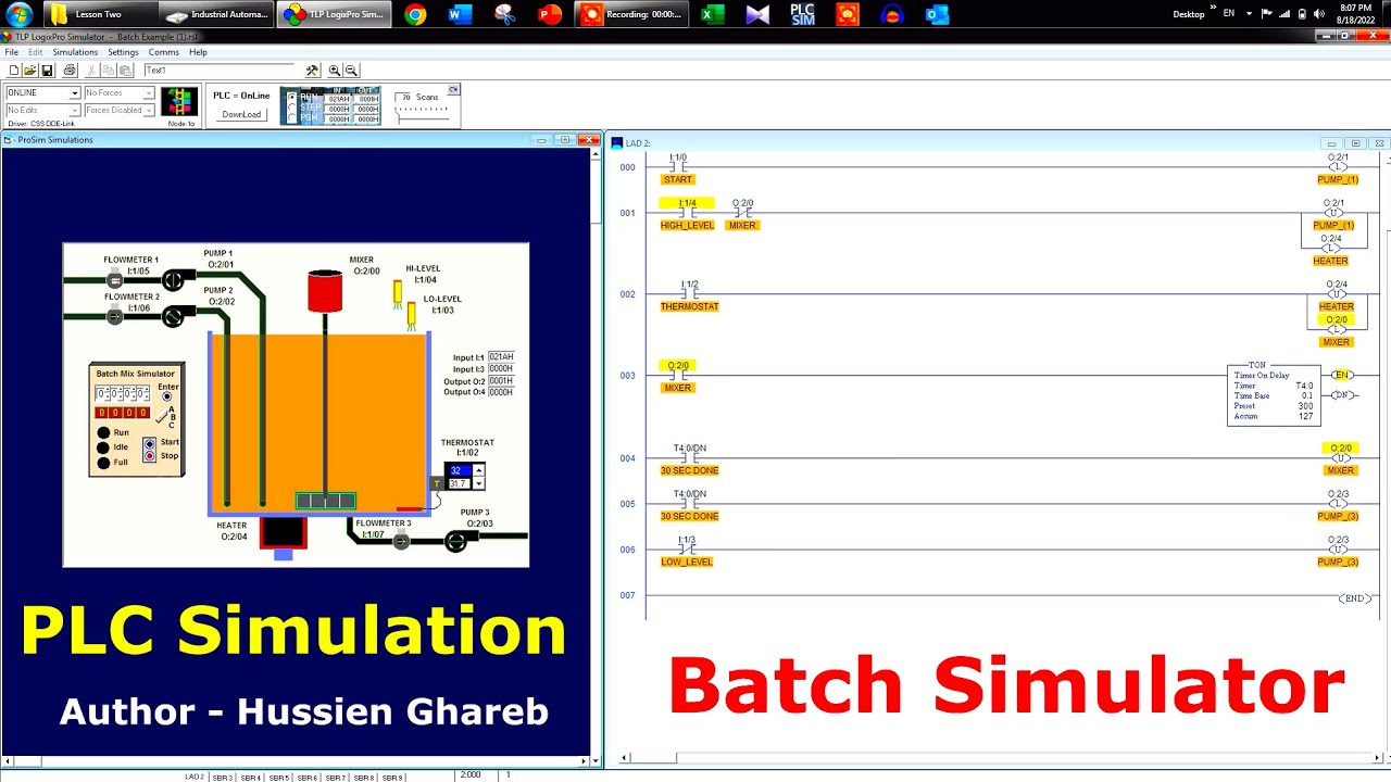

As we discussed earlier in the operation of the batching process, now we are going to start with the first step by summarizing the whole application shown in Fig. (2) in the form of short sentences:
What is meant by the Batching Process
Figure 2
  • By pressing the start push button, “PUMP_ (1)” which is responsible for filling the tank, should turn on to start the filling operation.
  • Once the level of the fluid reaches to the HIGH_LEVEL_SWITCH, “PUMP_ (1)” should turn off. Fig. (1)
  • Then the HEATER should operate till the thermostat reaches the set point.
  • Then using the MIXER for mixing the fluid for 30 Sec.
  • Finally, the whole fluid should be discharged using “PUMP_ (3)”

  • Now by starting with the first condition which is by pressing START, PUMP-(1) should turn on.
As we can see in Fig. (3) for the first rung “000” whenever we press the START button it will energize the Latching coil for the output that is responsible to operate PUMP-(1).
  • Regarding the application AFD, PUMP-(1) should be turned ON till it fills the tank (HIGH_LEVEL energized).
So, for the second rung (001) as you can see when the HIGH_LEVEL switch will indicate the level it will de-energize the filling pump “PUMP-(1)” and also it will latch the HEATER to increase the fluid temperature.
  • And now is the role of the THERMOSTAT when the temperature of the fluid reaches the setpoint temperature that is represented in Fig. (1), the THERMOSTAT NO contact will be closed and it will de-energize the heater operation and it will energize the MIXER to start mixing the fluid as shown in rung No. (002)
  • Notice that there is an interlock between the heater and the mixer represented in Fig. (2) rung No. (001), as you can see there is an NC contact for the mixer on the HEATER coil so the heater can not be turned on when the mixer is ON.
  • Now as shown in rung No. (003) the mixer will initialize a timer (T4:0) to calculate 30 Sec. of working for the mixer then the timer will de-energize the mixer as shown in rung No. (004)
LogixPro Batch Simulator PLC Logic
Figure 3
  • At the same time and after the timer stopped the mixer, it will energize the discharging pump “PUMP-(3)” as shown in rung (005) till the tank get empty and the low-level switch will de-energize the discharging pump as shown in rung No. (006)
  • The whole process will be repeated if we press start again.
