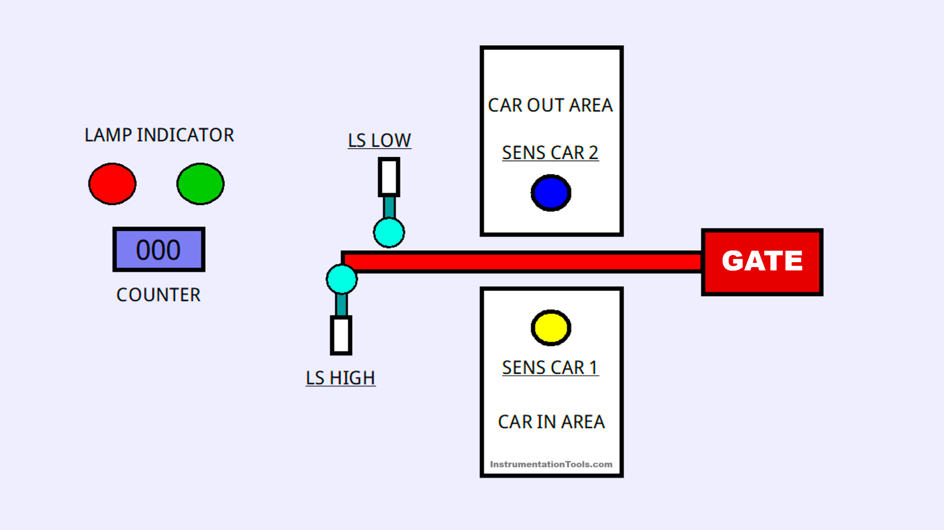

Parking System Steps:
  1. System Initialization:
    • The system is configured with an initial parking capacity of 30 slots.
    • The system is in Standby mode and ready to operate.
  2. Vehicle Entry Process:
    • A vehicle approaches the Entry Gate, and the automatic sensor detects its presence.
    • If parking slots are available, the Green indicator Lamp will turn On, the gate will Open automatically, the vehicle is allowed to enter, and the system will add (+1) to the vehicle Counter.
    • If the parking area is full, the Red indicator Lamp will turn On, and the gate will remain closed.
  3. Vehicle Exit Process:
    • A vehicle approaches the Exit Gate, and the automatic sensor detects its presence.
    • The gate will open automatically, the vehicle exits, and the system will subtract (-1) from the vehicle Counter.
  4. Parking Capacity Management:
    • The system ensures that the number of vehicles inside the parking area does not exceed the maximum capacity.
    • If the parking area is full, the Entry Gate will not Open until a vehicle exits.
  5. Manual Mode:
    • The system can be operated manually using the UP/Down buttons to Open or Close the gate.
  6. Alarm and Indicators:
    • The Green indicator Lamp will turn On if parking slots are available.
    • The Red indicator Lamp will turn On if the parking area is full.

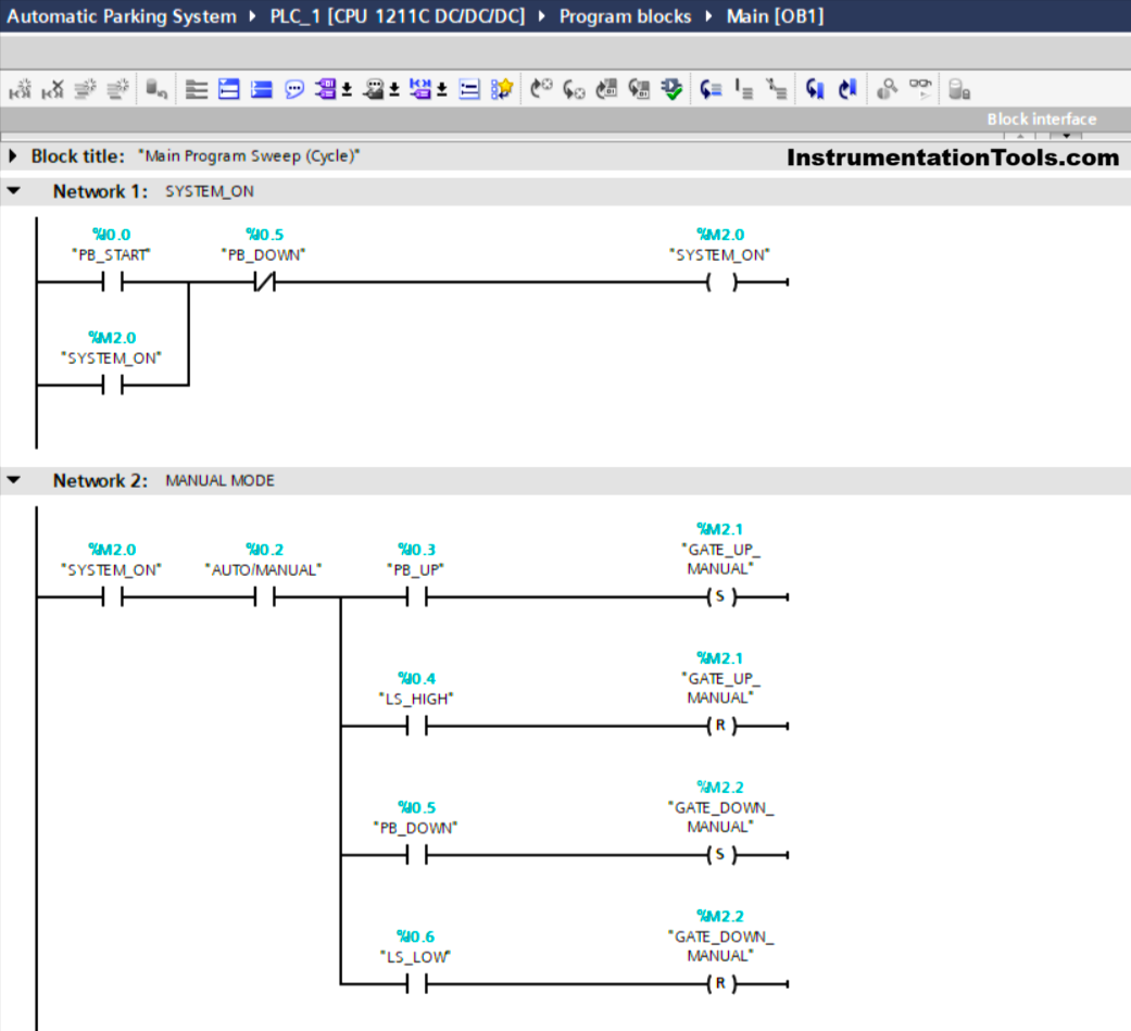

In this network, when the PB_START (I0.0) button is Pressed, the memory bit SYSTEM_ON (M2.0) will be in the HIGH state. The memory bit SYSTEM_ON (M2.0) will remain in the HIGH state even though the PB_START (I0.0) button has been Released. Because it uses Latching.
If the PB_STOP (I0.1) button is Pressed, the memory bit SYSTEM_ON (M2.0) will be in the LOW state.
NETWORK 2 (MANUAL MODE)
In this Network, when the NO contact of the memory bit SYSTEM_ON (M2.0) and the AUTO/MANUAL (I0.2) selector switch are in the HIGH state, and the PB_UP (I0.3) button has been Pressed, the memory bit GATE_UP_MANUAL (M2.1) will be in the HIGH state.
When the limit switch LS_HIGH (I0.4) is in the HIGH state, the memory bit GATE_UP_MANUAL (M2.1) will be in the LOW state.
When the NO contact of the memory bit SYSTEM_ON (M2.0) and AUTO/MANUAL (I0.2) selector switch is in the HIGH state and the PB_DOWN (I0.5) button has been Pressed, the memory bit GATE_DOWN_MANUAL (M2.2) will be in the HIGH state.
When the limit switch LS_LOW (I0.6) is in the HIGH state, the memory bit GATE_DOWN_MANUAL (M2.2) will be in the LOW state.

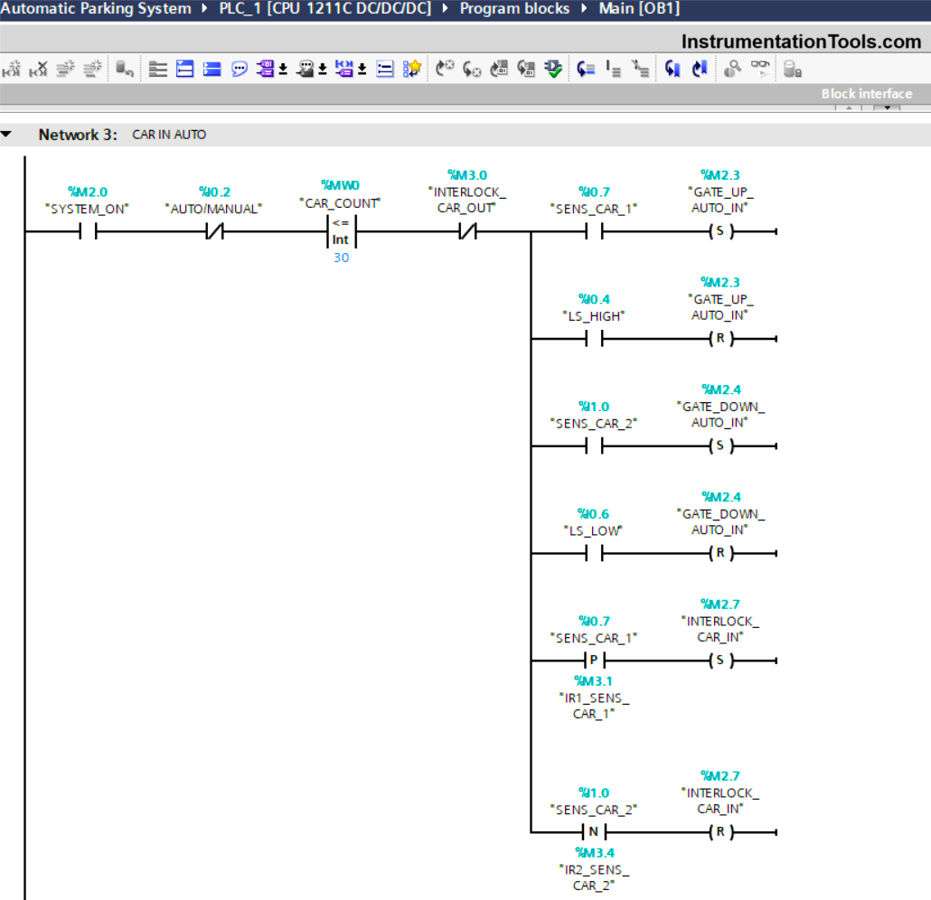

In this network, when the NO contact of the memory bit SYSTEM_ON (M2.0) and the SENS_CAR_1 (I0.7) sensor in the HIGH state and the value of the memory word CAR_COUNT (MW0) is Less Than Or Equal To “30”, then the memory bit GATE_UP_AUTO_IN (M2.3) and INTERLOCK_CAR_IN(M2.7) will be in the HIGH state.
If the NO contact of the limit switch LS_HIGH (I0.4) is in the HIGH state, then the memory bit GATE_UP_AUTO_IN (M2.3) will be in the LOW state.
When the NO contact of the memory bit SYSTEM_ON (M2.0) and the sensor SENS_CAR_2 (I1.0) are in the HIGH state and the value of the memory word CAR_COUNT (MW0) is Less Than Or Equal To “30”, then the memory bit GATE_DOWN_AUTO_IN (M2.4) will be in the HIGH state.
If the NO contact of the limit switch LS_LOW (I0.6) is in the HIGH state, then the memory bit GATE_DOWN_AUTO_IN (M2.4) will be in the LOW state.
When the NO contact of the SENS_CAR_2 (I1.0) sensor changes to the LOW state, the memory bit INTERLOCK_CAR_IN (M2.7) will become LOW state.

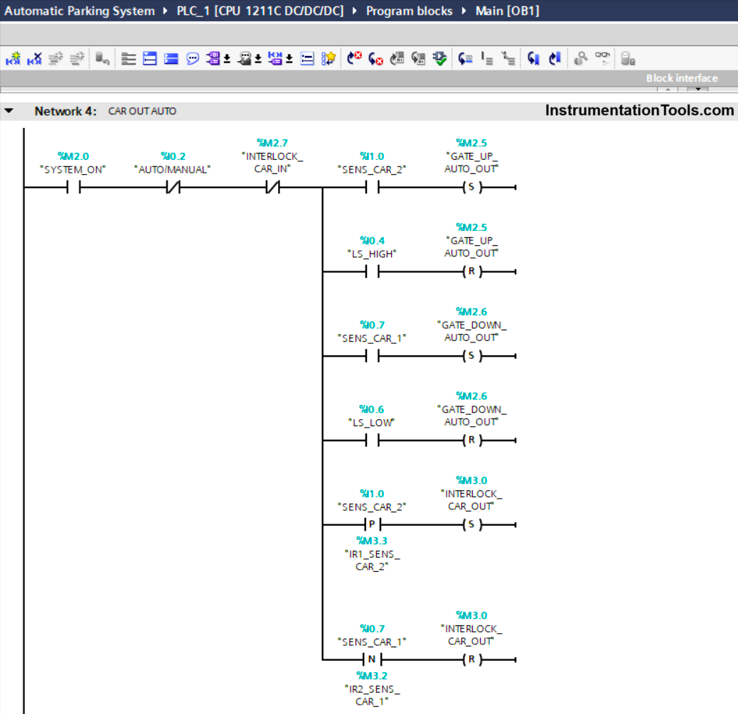

In this network, when the NO contact of the memory bit SYSTEM_ON (M2.0) and the SENS_CAR_2 (I1.0) sensor are in the HIGH state, then the memory bit GATE_UP_AUTO_OUT (M2.5) and INTERLOCK_CAR_OUT (M3.0) will be in the HIGH state. state.
If the NO contact of the limit switch LS_HIGH (I0.4) is in the HIGH state, then the memory bit GATE_UP_AUTO_OUT (M2.5) will be in the LOW state.
When the NO contact of the memory bit SYSTEM_ON (M2.0) and the SENS_CAR_1 (I0.7) sensor are in the HIGH state, the memory bit GATE_DOWN_AUTO_OUT (M2.6) will be in the HIGH state.
If the NO contact of the limit switch LS_LOW (I0.6) is in the HIGH state, then the memory bit GATE_DOWN_AUTO_OUT (M2.6) will be in the LOW state.
When the NO contact of the SENS_CAR_1 (I0.7) sensor changes to the LOW state, the memory bit INTERLOCK_CAR_OUT (M3.0) will become LOW state.

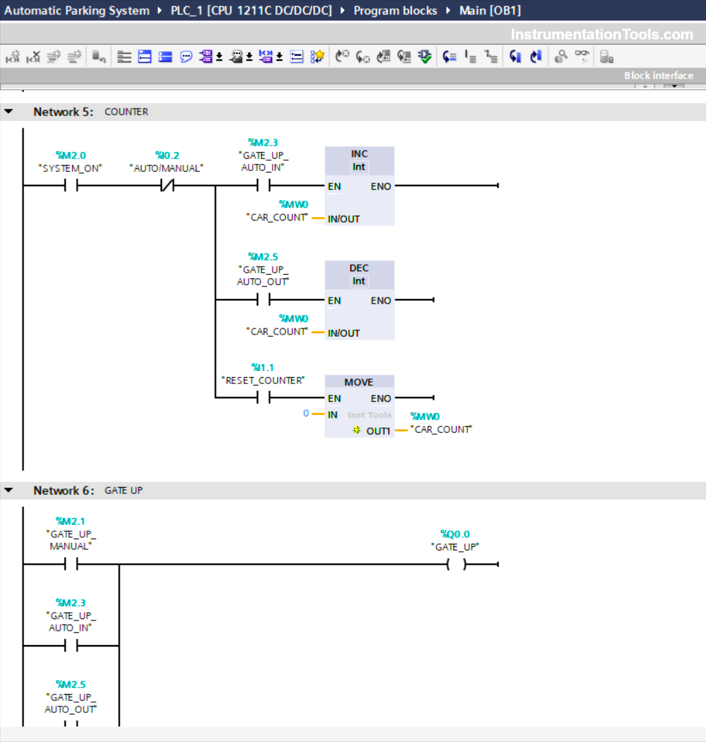

NETWORK 5 (COUNTER)
In this network, the value in the memory word CAR_COUNT (MW0) will increase (+1) if the NO contact of the memory bits SYSTEM_ON (M2.0) and GATE_UP_AUTO_IN (M2.3) are in the HIGH state.
And the value in the memory word CAR_COUNT (MW0) will decrease (-1) if the NO contact of the memory bit SYSTEM_ON (M2.0) and GATE_UP_AUTO_OUT (M2.5) is in the HIGH state.
The value in the memory word CAR_COUNT (MW0) will be reset to the zero value “0” when the NO contact of the memory bit SYSTEM_ON (M2.0) in the HIGH state and the RESET_COUNTER (I1.1) button is Pressed.

NETWORK 6 (GATE UP)

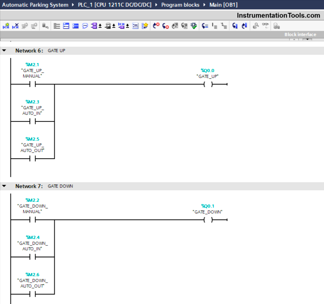

In this Network, the GATE_UP (Q0.0) output will be ON when the NO contact of the memory bits GATE_UP_MANUAL (M2.1) or GATE_UP_AUTO_IN (M2.3), or GATE_UP_AUTO_OUT (M2.5) is in the HIGH state.
NETWORK 7 (GATE DOWN)
In this Network, the GATE_DOWN (Q0.1) output will be ON when the NO contact of the memory bits GATE_DOWN_MANUAL (M2.2) or GATE_DOWN_AUTO_IN (M2.4), or GATE_DOWN_AUTO_OUT (M2.6) is in the HIGH state.

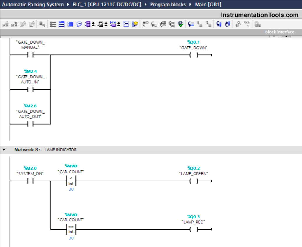

In this network, when the NO contact of the memory bit SYSTEM_ON (M2.0) and the value of the memory word CAR_COUNT (MW0) is Less Than “30”, then the output LAMP_GREEN (Q0.2) will be ON.
When the NO contact of the memory bit SYSTEM_ON (M2.0) and the value of the memory word CAR_COUNT (MW0) is Equal To “30”, then the output LAMP_RED (Q0.3) will be ON.
