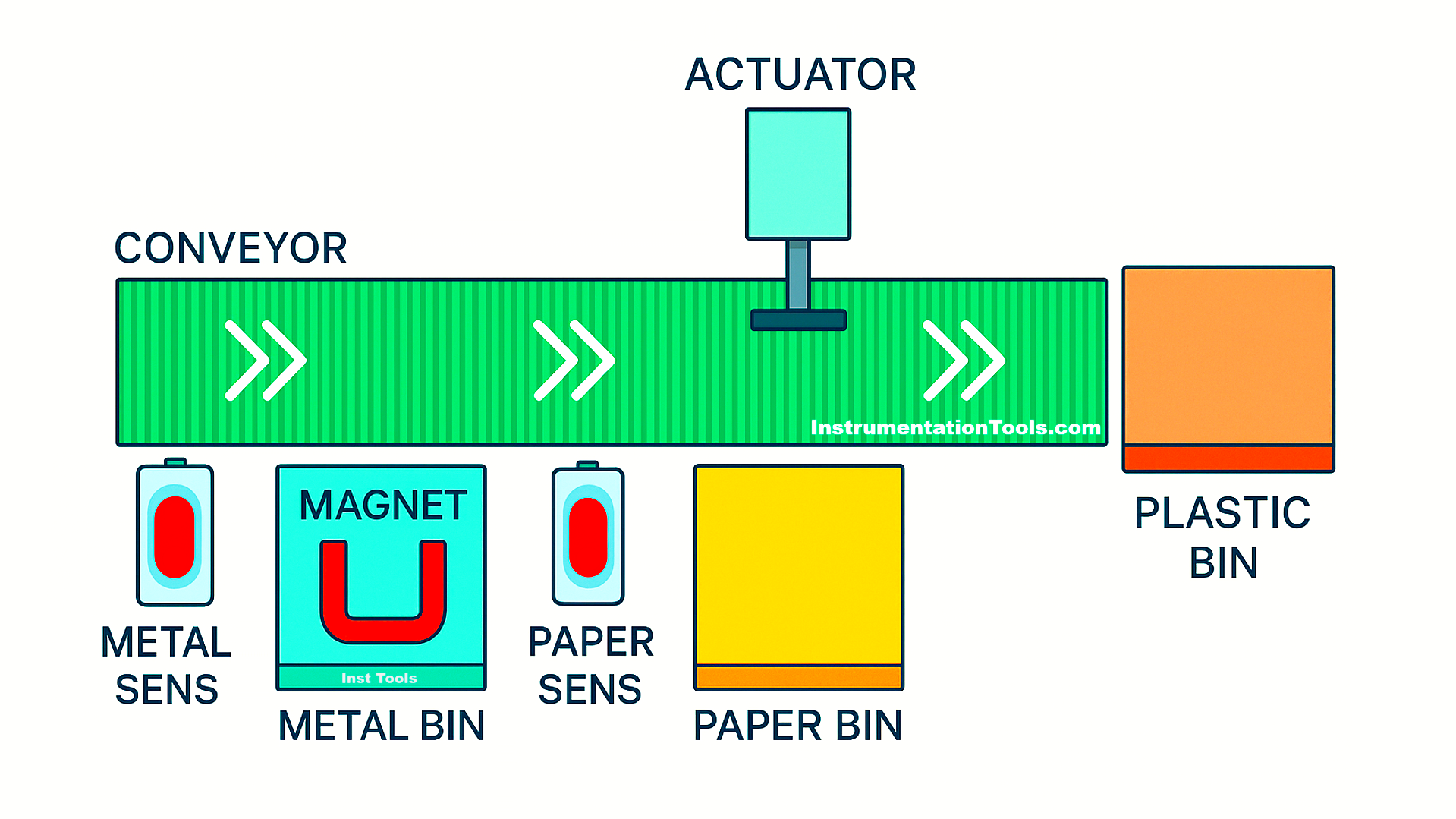

Steps of the Automatic Waste Sorting System:
Waste will be carried by a conveyor.
Waste Type Identification:
- Metal Detector: This sensor will activate when it detects the presence of metal in the waste.
- Color Sensor: This sensor is used to differentiate between plastic and paper based on color.
Waste Sorting Process:
- If metal is detected, a Magnet will pull the waste into a dedicated metal container.
- If paper is detected, an Actuator will push the waste into the paper container.
- If the waste is neither metal nor paper, it will automatically be directed to the plastic container.
Waste Collection and Alarm Indicator:
The collected waste in each container will be weighed.
- An alarm will turn On if the weight of the metal waste reaches 15 kg.
- An alarm will turn On if the weight of the paper waste reaches 17 kg.
- An alarm will turn On if the weight of the plastic waste reaches 25 kg.

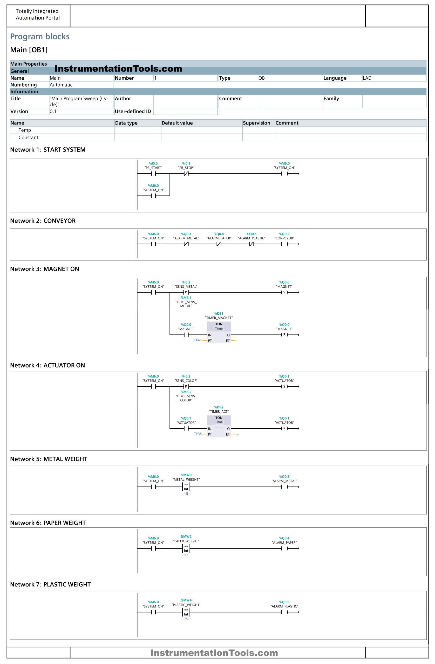

TIA Portal Programming

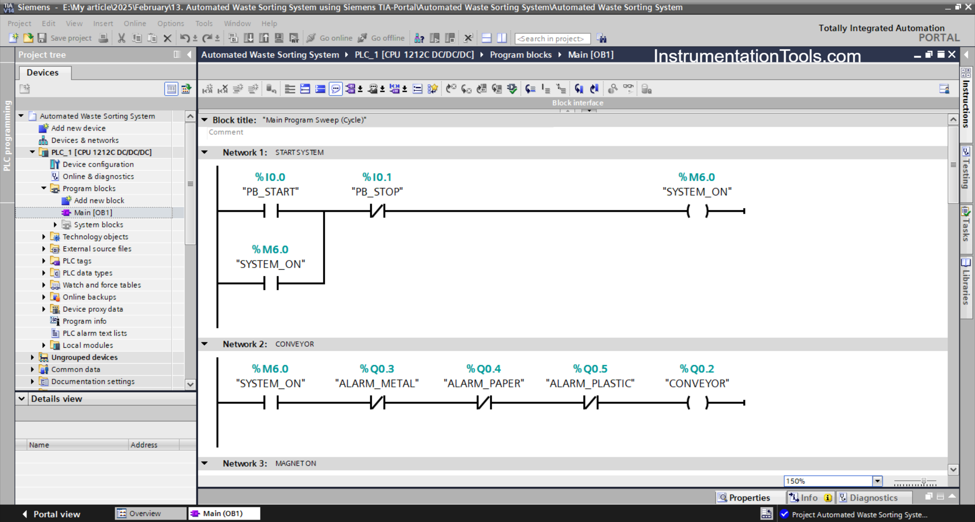

NETWORK 1 (START SYSTEM)
In this network, the memory bit SYSTEM_ON (M6.0) will be in the HIGH state when the PB_START (I0.0) button is Pressed. Because it uses Latching, even though the PB_START (I0.0) button has been Released the memory bit SYSTEM_ON (M6.0) will remain in the HIGH state.
When the PB_STOP (I0.1) button is Pressed, the memory bit SYSTEM_ON (M6.0) will return to the LOW state.
NETWORK 2 (CONVEYOR)
In this network, the CONVEYOR (Q0.2) output will be ON if the NO contact of the memory bit SYSTEM_ON (M6.0) is in the HIGH state.
When any of the NC contacts of ALARM_METAL (Q0.3), ALARM_PAPER (Q0.4), or ALARM_PLASTIC (Q0.5) is in the HIGH state, the CONVEYOR (Q0.2) output will be OFF.

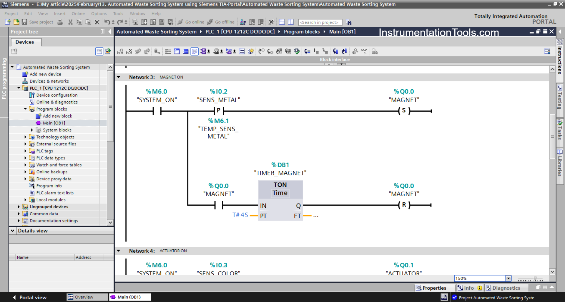

NETWORK 3 (MAGNET ON)
In this network, the MAGNET (Q0.0) output will be ON if the NO contact of the memory bit SYSTEM_ON (M6.0) and the SENS_METAL (I0.2) sensor are in the HIGH state.
Next, the TIMER_MAGNET (DB1) timer will start counting up to 4 seconds, and when the timer has finished counting, the MAGNET (Q0.0) output will turn OFF because the RESET output instruction for MAGNET (Q0.0) has been triggered by the TIMER_MAGNET (DB1) timer.

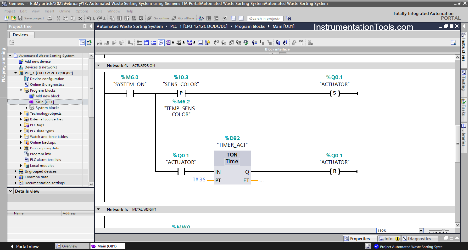

NETWORK 4 (ACTUATOR ON)
In this network, the ACTUATOR (Q0.1) output will be ON when the NO contact of the memory bit SYSTEM_ON (M6.0) and the SENS_COLOR (I0.3) sensor are in the HIGH state.
Next, the TIMER_ACT (DB2) timer will start counting for up to 3 seconds, and after the timer has finished counting, the ACTUATOR (Q0.1) output will turn OFF because the RESET Output Instruction for ACTUATOR (Q0.1) has been triggered by the TIMER_ACT(DB2) timer.

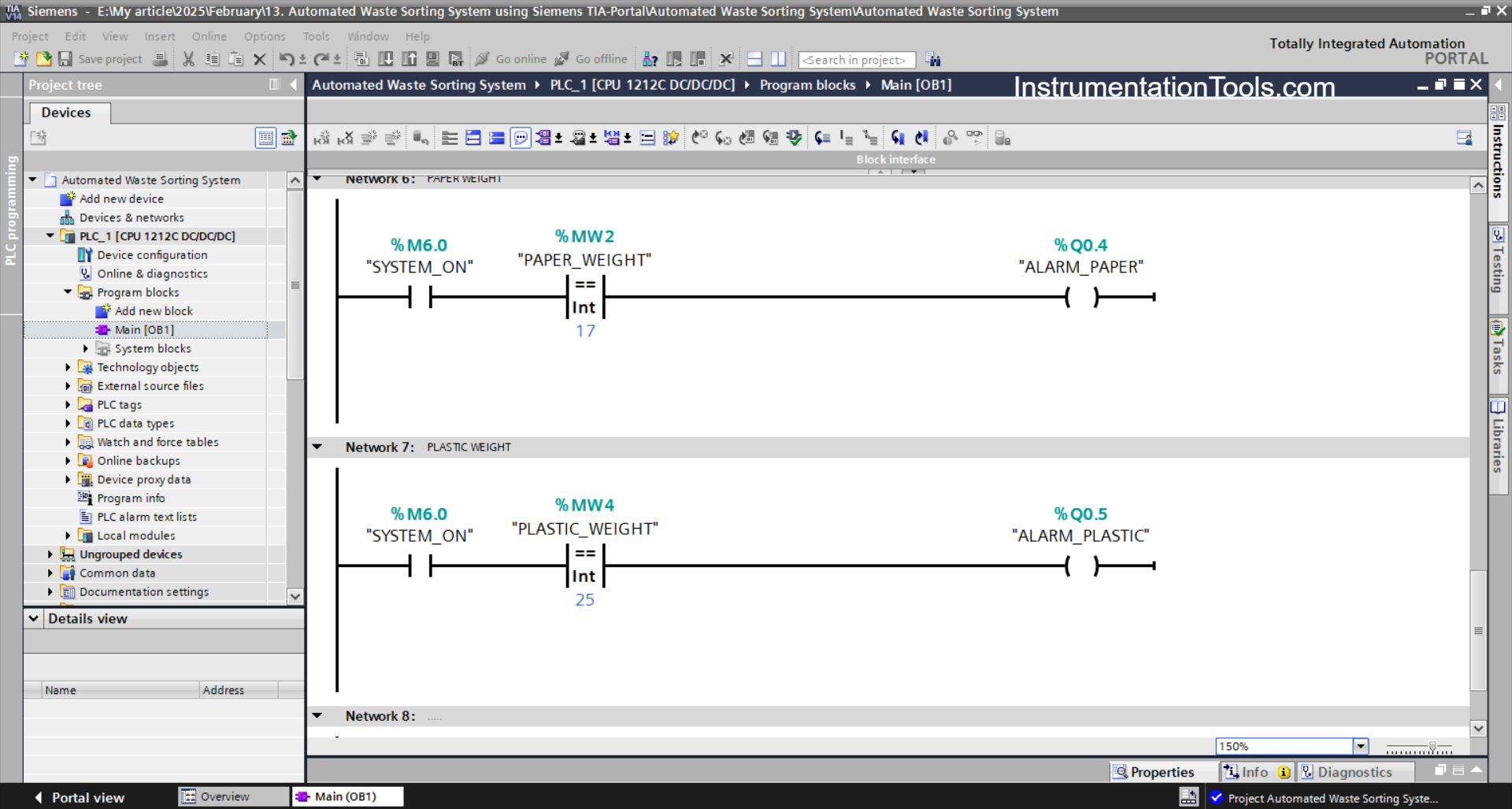

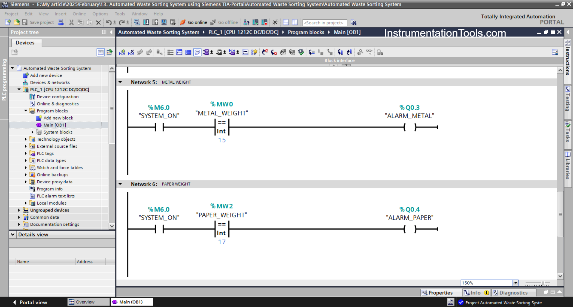

NETWORK 5 (METAL WEIGHT)
The ALARM_METAL (Q0.3) output will be ON if the NO contact of the memory bit SYSTEM_ON (M6.0) in the HIGH state and the value in the memory word METAL_WEIGHT (MW0) is Equal to “15”.
NETWORK 6 (PAPER WEIGHT)
The ALARM_PAPER (Q0.4) output will be ON if the NO contact of the memory bit SYSTEM_ON (M6.0) in the HIGH state and the value in the memory word PAPER_WEIGHT (MW2) is Equal to “17”.
NETWORK 7 (PLASTIC WEIGHT)
The ALARM_PLASTIC (Q0.5) output will be ON when the NO contact of the memory bit SYSTEM_ON (M6.0) in the HIGH state and the value in the memory word PLASTIC_WEIGHT (MW2) is Equal to “25”.
