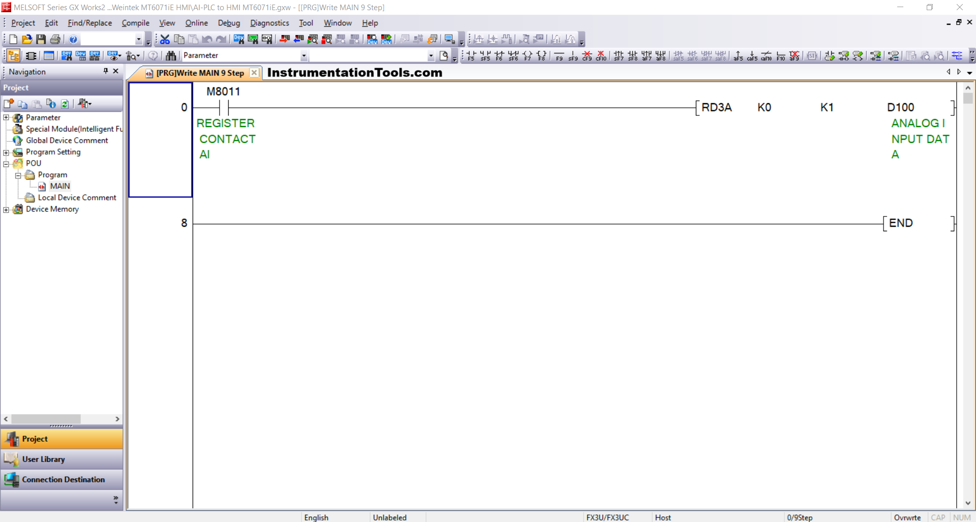

Analog Input Configuration on FX3U-14MT PLC
1. Programming with GX Works2
Create a program in GX Works2 using the RD3A instruction to read analog input values from the PLC’s input channels.
- Module Configuration: Use parameter 0/K0 to reference the internal analog module.
- Analog Input Channel: Specify the input channel to be read, for example, 1/K1.
- Data Storage Address: The analog reading will be stored in word memory (D100) ANALOG INPUT DATA.
- Instruction Trigger: Use a Normally Open (NO) contact from system bit M8011 as the trigger condition for executing RD3A. The M8011 bit turns ON automatically every 250 ms, making it suitable for periodic reading.

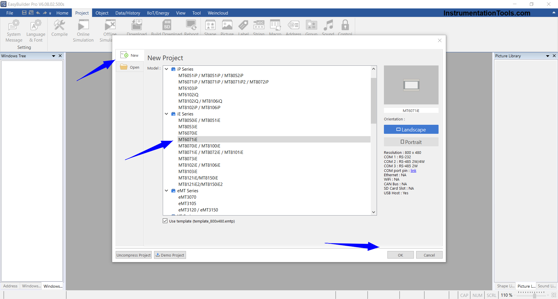

2. Creating a New Project in EasyBuilder Pro
Launch EasyBuilder Pro and:
- Click New Project
- Select device type: MT6071iE
- Click OK to enter the project workspace

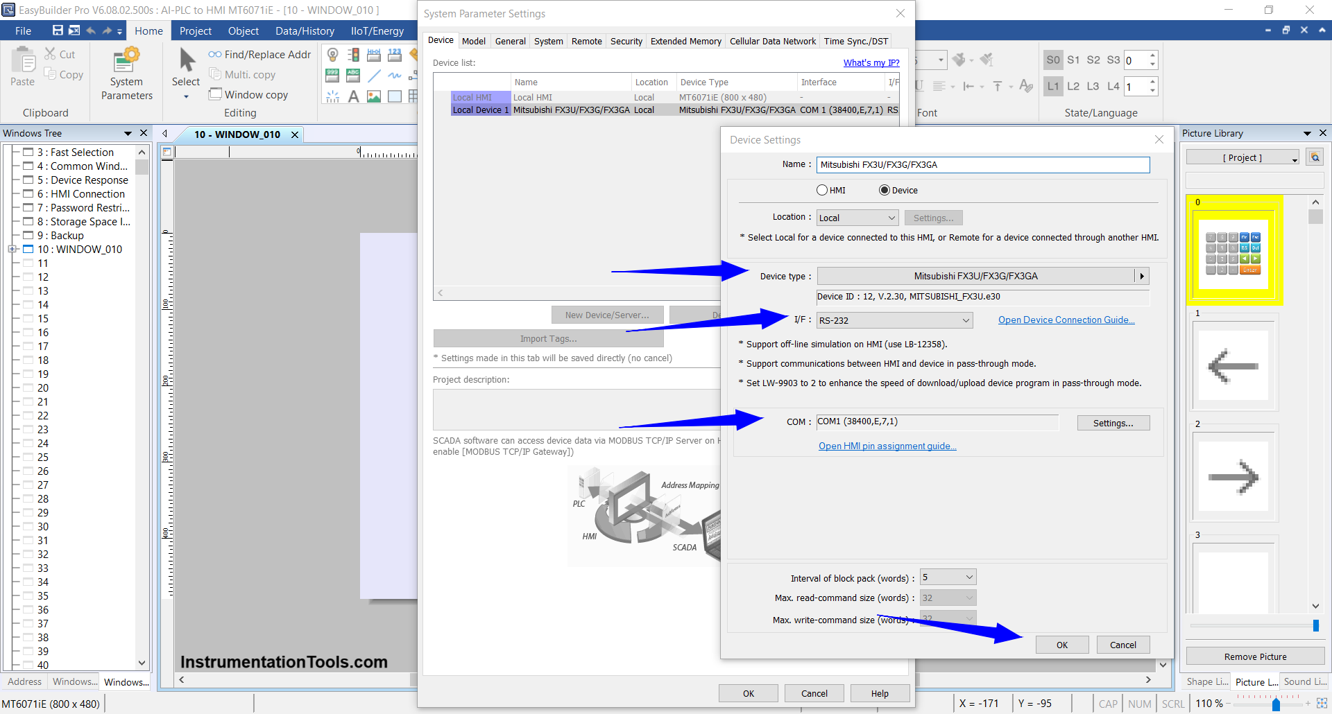

3. Adding the PLC Device
Set up communication between the HMI and PLC via the System Parameter Settings window:
Click New Device/Server
Configure the parameters:
- Port: RS-232
- COM Port: COM1(*)
- Baud Rate & Format: 38400 bps,
- Parity: Even, Data Bits: 7, Stop Bit:1
- Device Type: Mitsubishi FX3U/FX3G/FX3GA
Click OK to save settings

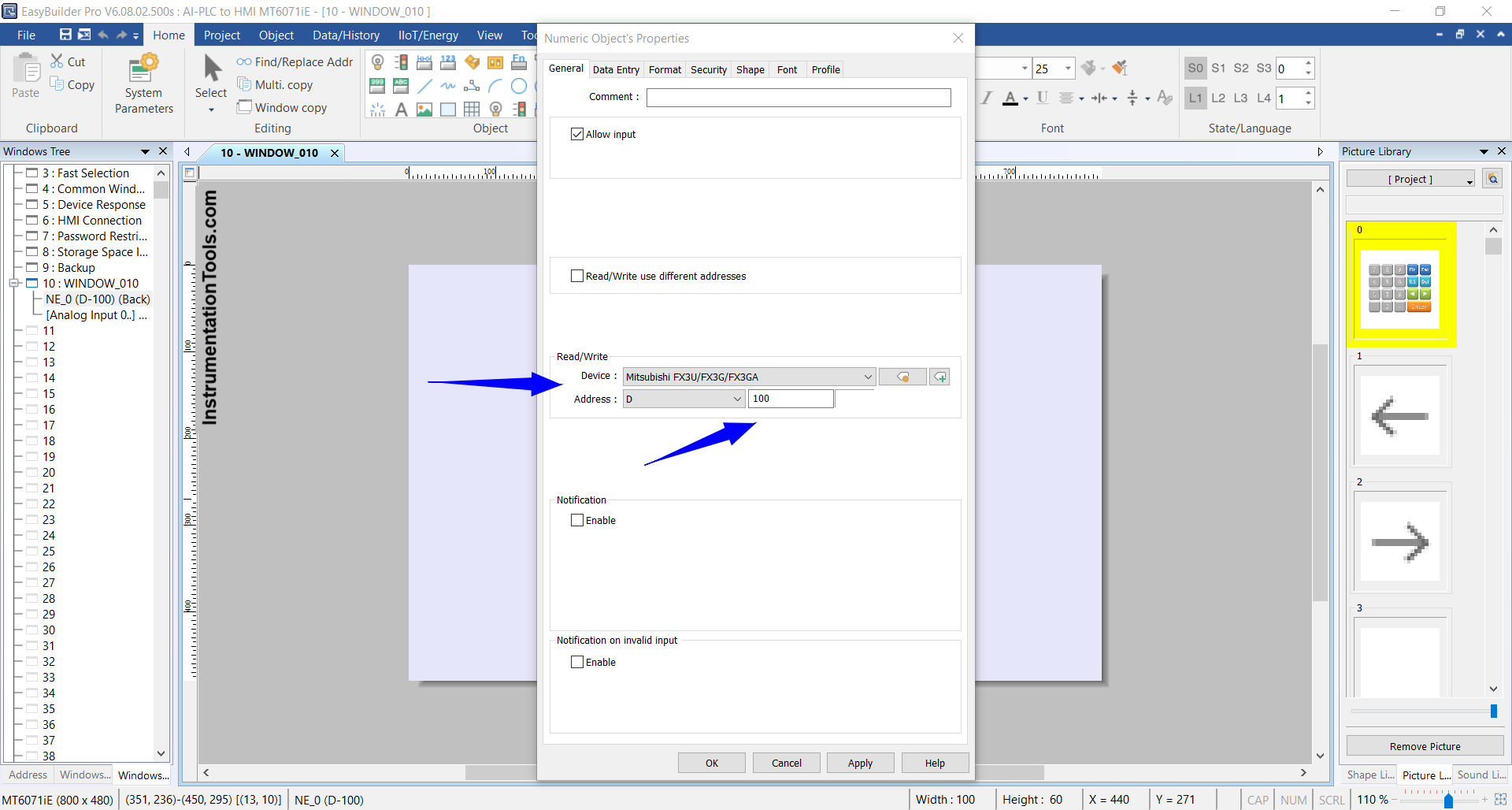

4. Designing the HMI Interface
Add display objects to show analog data from the PLC:
Go to Object → Numeric Display
Set the following:
- Device: Mitsubishi FX3U/FX3G/FX3GA
- Address: D100 (match the PLC’s analog input word memory address)
- Data Format: 16-bit Unsigned
Click OK to place the object on the HMI screen.

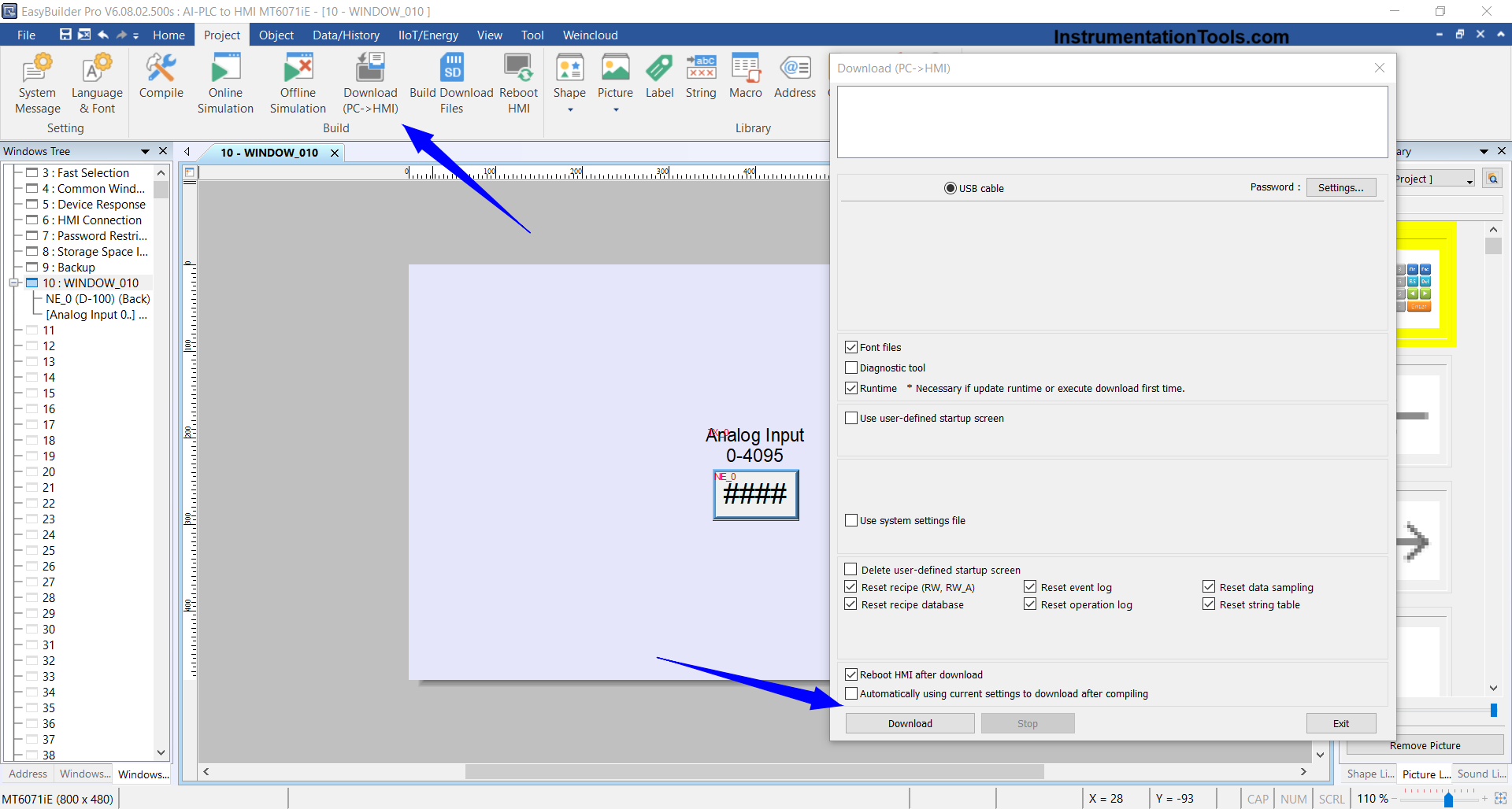

5. Downloading the Project to the HMI
Once the design is complete:
- Go to Project → Download (PC → HMI)
- Ensure the HMI is still connected to the PC via USB
- The project will be transferred from the computer to the HMI

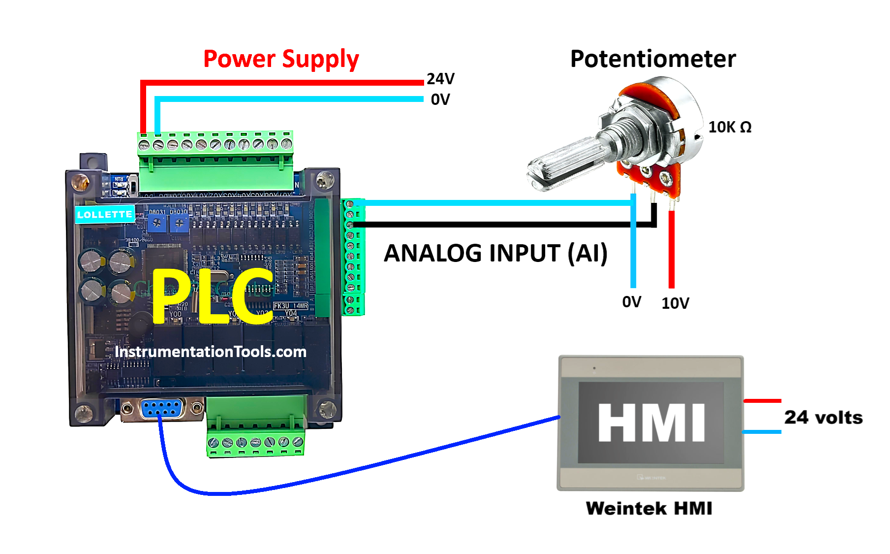

6. Connecting HMI to PLC
After the download process is complete:
Disconnect the Mini USB Type B cable from the HMI
Connect the HMI to the PLC using a DB9 RS-232 Male to Female serial cable:
- Male end to the RS-232 port on the PLC
- Female end to COM1 on the HMI
With this setup, the HMI will be able to display real-time analog input data from the PLC via RS-232 serial communication.
