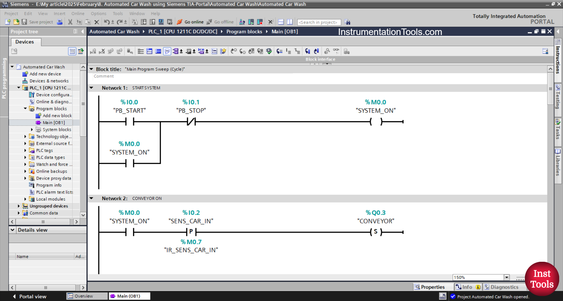

NETWORK 1 (START SYSTEM)
In this network, the memory bit SYSTEM_ON (M0.0) ​​will be in the HIGH state if the PB_START (I0.0) button is pressed. Even though the PB_START (I0.0) button has been released, the memory bit SYSTEM_ON (M0.0) will remain in the HIGH state. Because it uses Latching.
When the PB_STOP (I0.1) button is pressed, the memory bit SYSTEM_ON (M0.0) will be in the LOW state.
NETWORK 2 (CONVEYOR ON)
In this network, the CONVEYOR (Q0.3) output will be ON if the NO contact of the memory bits SYSTEM_ON (M0.0) and the SENS_CAR_IN(I0.2) sensor are in the HIGH state.
Because it uses the SET Output instruction, even though the NO contact of the memory bit SYSTEM_ON (M0.0)Â or the SENS_CAR_IN (I0.2) sensor is in the LOW state, the CONVEYOR (Q0.3) output state will remain ON.

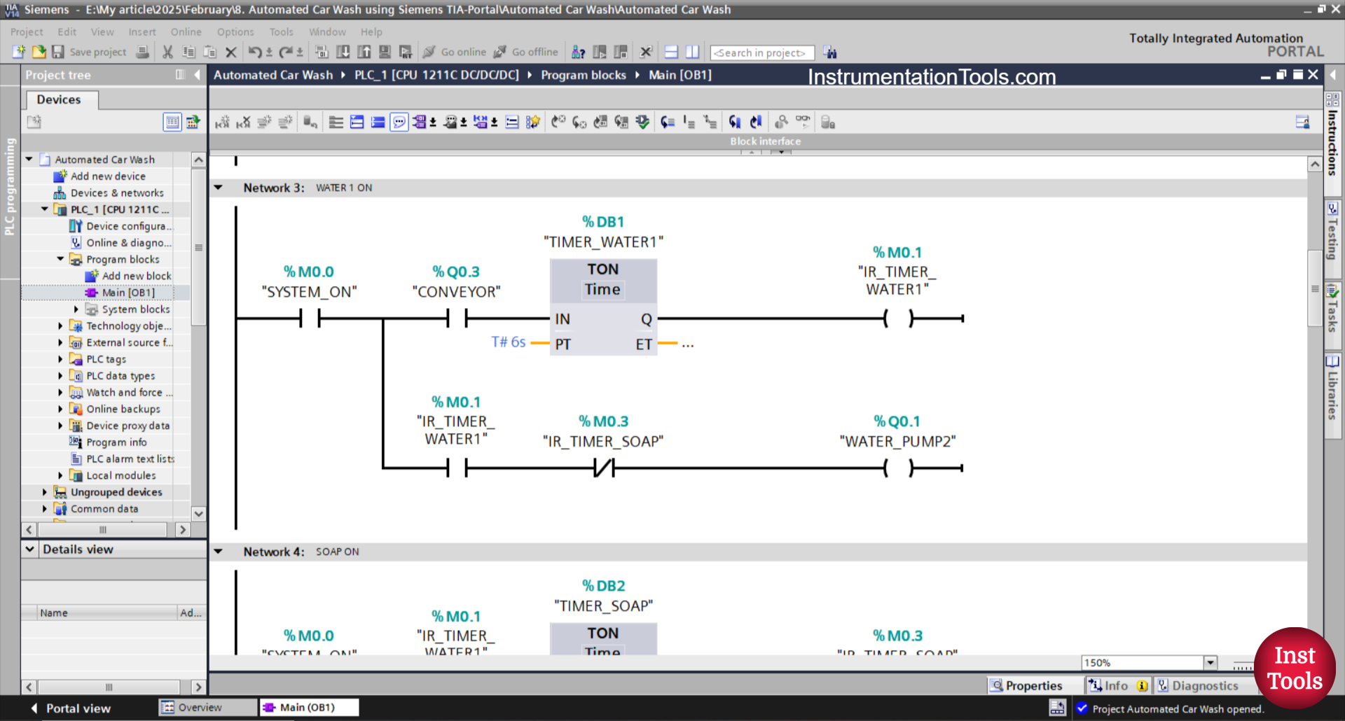

NETWORK 3 (WATER 1 ON)
In this network, the TIMER_WATER1 (DB1) timer will start counting when the NO contacts of the memory bit SYSTEM_ON (M0.0) ​​and CONVEYOR (Q0.3) are in the HIGH state.
The TIMER_WATER1 (DB1) timer will count up to 6 seconds, and after the timer has finished counting, the memory bit IR_TIMER_WATER1 (M0.1) will be in the HIGH state and the output WATER_PUMP1 (Q0.0) will be ON.
When the NC contact of the memory bit IR_TIMER_SOAP (M0.3) is in the HIGH state, the WATER_PUMP1 (Q0.0) output will be OFF.

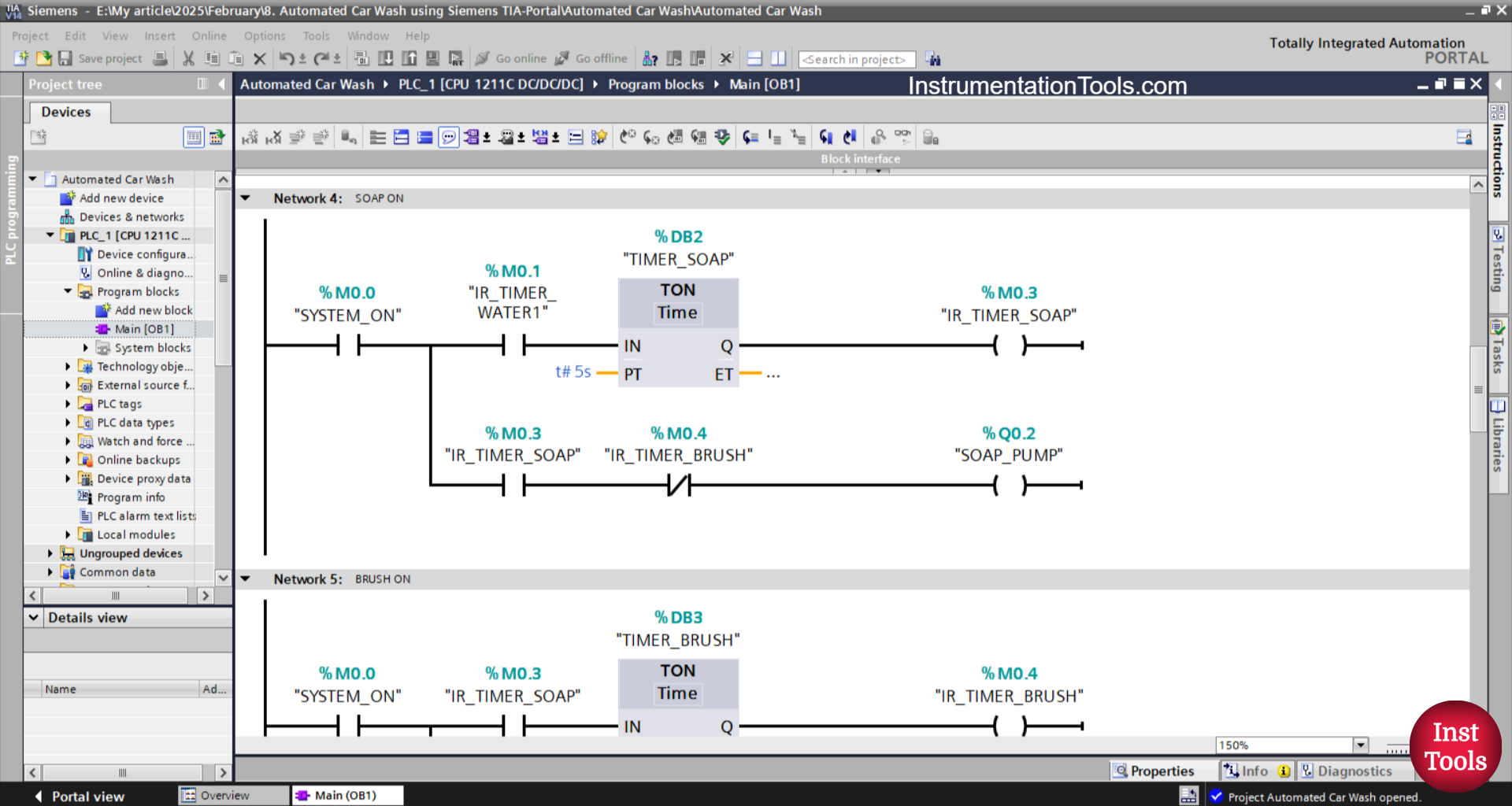

NETWORK 4 (SOAP ON)
In this network, the TIMER_SOAP (DB2) timer will start counting when the NO contacts of the memory bits SYSTEM_ON (M0.0) ​​and IR_TIMER_WATER1 (M0.1) are in the HIGH state.
The TIMER_SOAP (DB2) timer will count up to 5 seconds, and after the TIMER_SOAP (DB2) timer has finished counting, the memory bit IR_TIMER_SOAP (M0.3) will be in the HIGH state and the SOAP_PUMP(Q0.2) output will be ON.
When the NC contact of the memory bit IR_TIMER_BRUSH (M0.4) is in the HIGH state, the SOAP_PUMP (Q0.2) output will be OFF.

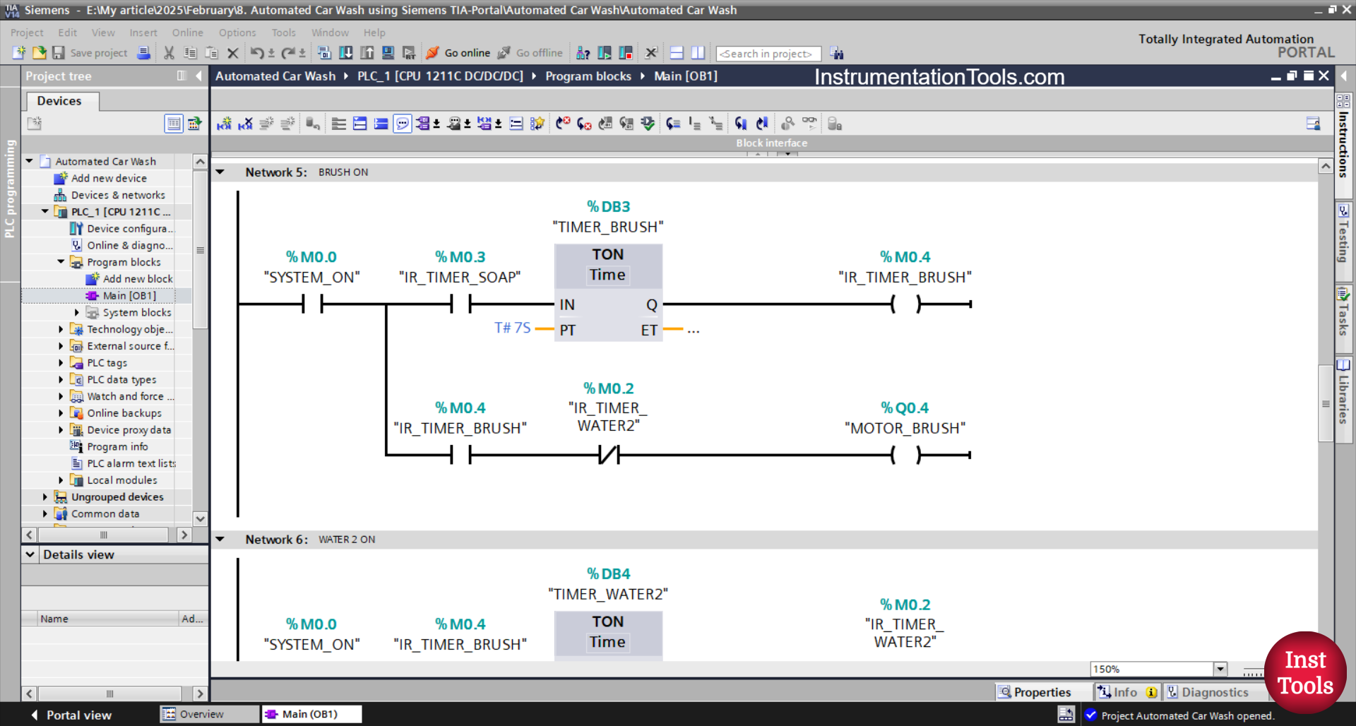

NETWORK 5 (BRUSH ON)
In this network, the TIMER_BRUSH (DB3) timer will start counting when the NO contacts of the memory bits SYSTEM_ON (M0.0) ​​and IR_TIMER_SOAP(M0.3) are in the HIGH state.
The TIMER_BRUSH (DB3) timer will count up to 7 seconds, and after the timer has finished counting, the memory bit IR_TIMER_BRUSH (M0.4) will be in the HIGH state and the MOTOR_BRUSH (Q0.4) output will be ON.
When the NC contact of the memory bit IR_TIMER_WATER2 (M0.2) is in the HIGH state, the MOTOR_BRUSH (Q0.4) output will be OFF.

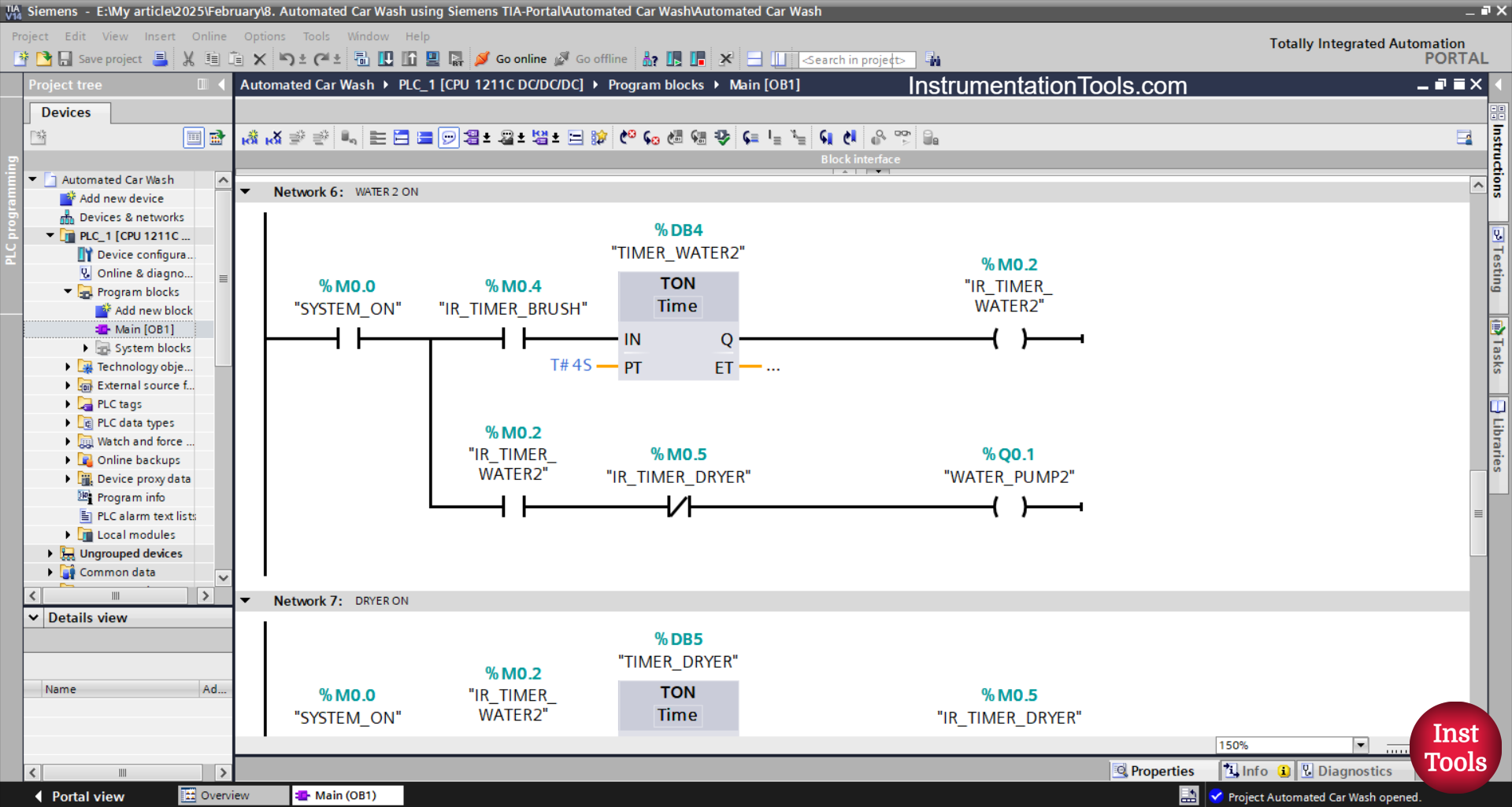

NETWORK 6 (WATER 2 ON)
In this network, the TIMER_WATER2 (DB4) timer will start counting if the NO contacts of the memory bits SYSTEM_ON (M0.0) ​​and IR_TIMER_BRUSH (M0.4) are in the HIGH state.
The TIMER_WATER2 (DB4) timer will count up to 4 seconds, and after the timer has finished counting, the memory bit IR_TIMER_WATER2 (M0.2) will be in the HIGH state and the WATER_PUMP2 (Q0.1) output will be ON.
When the NC contact of the memory bit IR_TIMER_DRYER (M0.5) is in the HIGH state, the output WATER_PUMP2 (Q0.1) will be OFF.

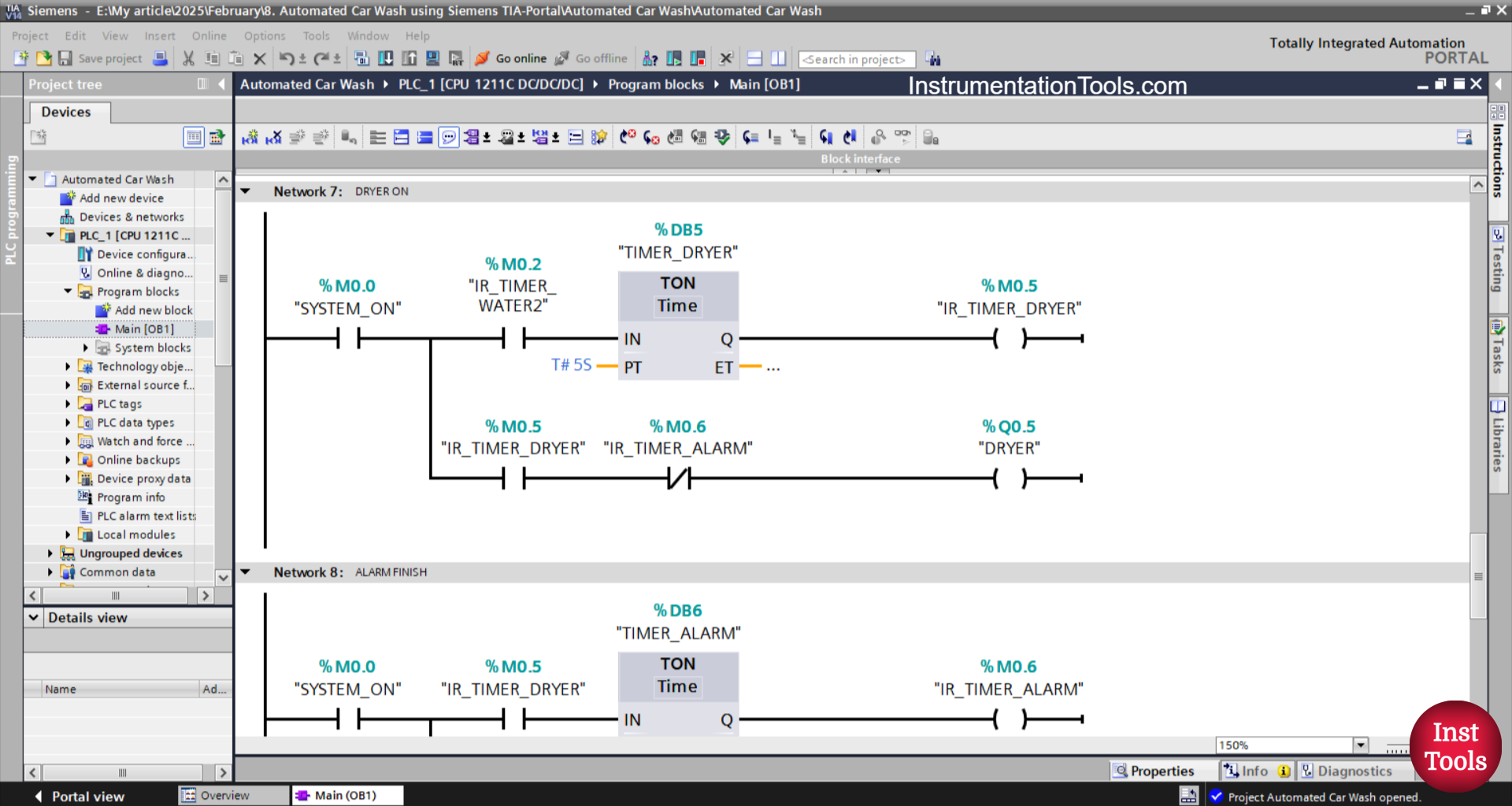

NETWORK 7 (DRYER ON)
The TIMER_DRYER (DB5) timer will start counting if the NO contacts of the memory bits SYSTEM_ON (M0.0) ​​and IR_TIMER_WATER2 (M0.2) are in the HIGH state.
The TIMER_DRYER (DB5) timer will count up to 5 seconds, and after the timer has finished counting, the memory bit IR_TIMER_DRYER (M0.5) will be in the HIGH state and the output WATER_PUMP2 (Q0.1) will be ON.
When the NC contact of the memory bit IR_TIMER_ALARM (M0.6) is in the HIGH state, the DRYER (Q0.5) output will be OFF.

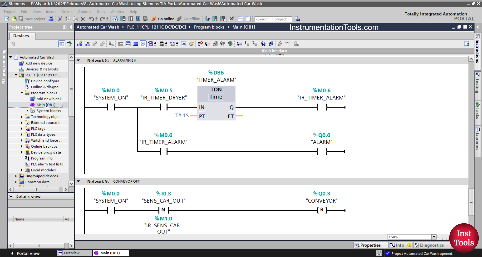

NETWORK 8 (FINISH ALARM)
The TIMER_ALARM (DB6) timer will start counting up to 4 seconds when the NO contacts of the memory bits SYSTEM_ON (M0.0) ​​and IR_TIMER_DRYER (M0.5) are in the HIGH state.
After the TIMER_ALARM (DB6) timer has finished counting, the memory bit IR_TIMER_ALARM (M0.6) will be in the HIGH state and the ALARM (Q0.6) output will be ON.
NETWORK 9 (CONVEYOR OFF)
In this network, the CONVEYOR (Q0.3) output will be OFF when the NO contact of the memory bits SYSTEM_ON (M0.0) ​​ and the SENS_CAR_OUT (I0.3) sensor are in the HIGH state.
