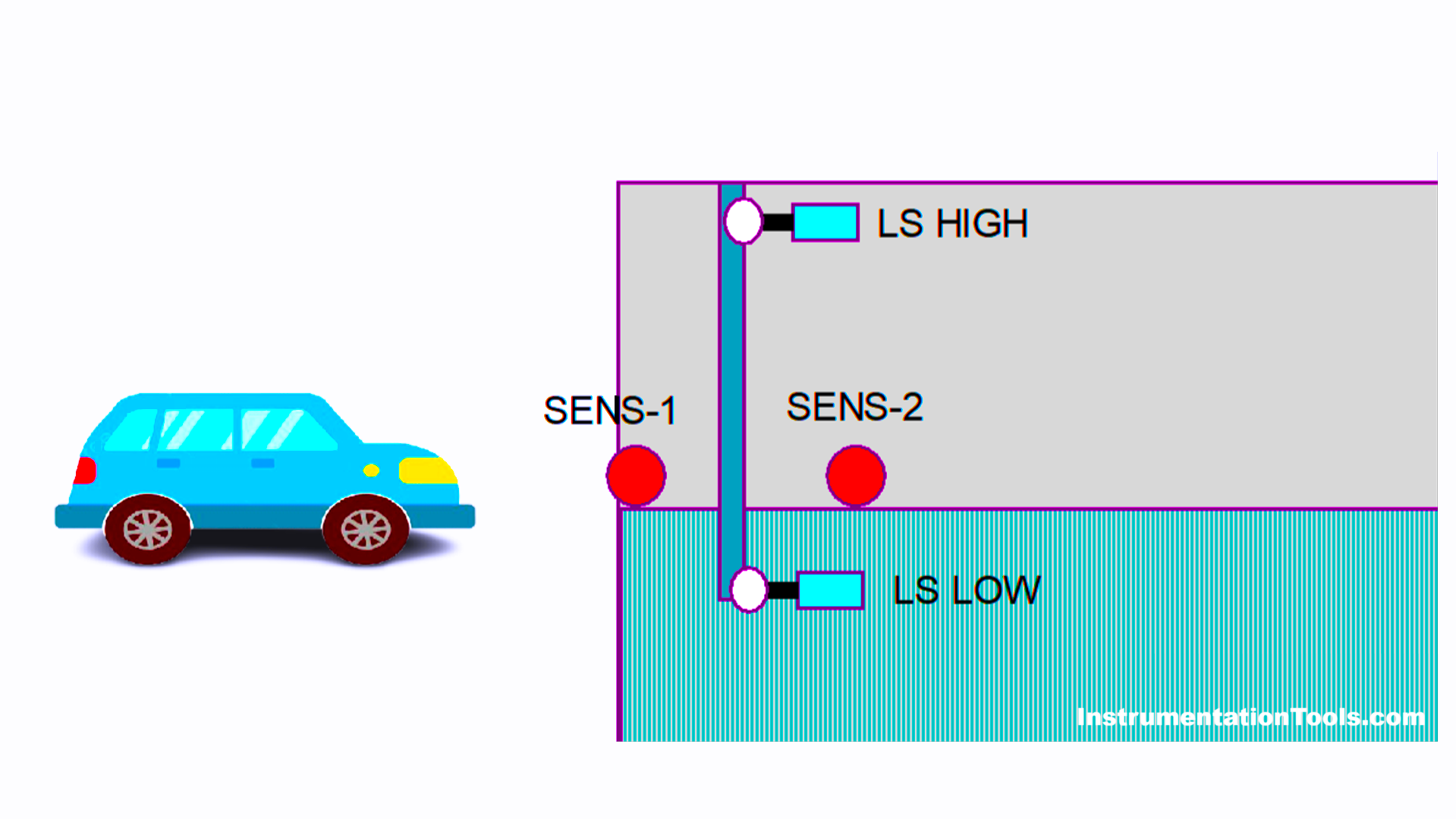

Automatic Mode:
- In automatic mode, the system operates based on input signals from the Limit Switch and Object Sensor. When a vehicle approaches and is detected by the sensor, the system will automatically open the garage door.
- After the vehicle enters or exits, and the sensor no longer detects its presence, the system will automatically close the garage door after a certain delay.
Manual Mode:
- In manual mode, the user can control the garage door directly using the Open or Close button.
- The system will move the door motor according to the command given through the button.
Limit Switch:
- The Limit Switch functions to provide feedback to the system regarding the position of the garage door, whether it is fully open or fully closed.
- This signal is used by the system to regulate the door’s movement, ensuring the door stops at the correct position, whether fully open or fully closed.

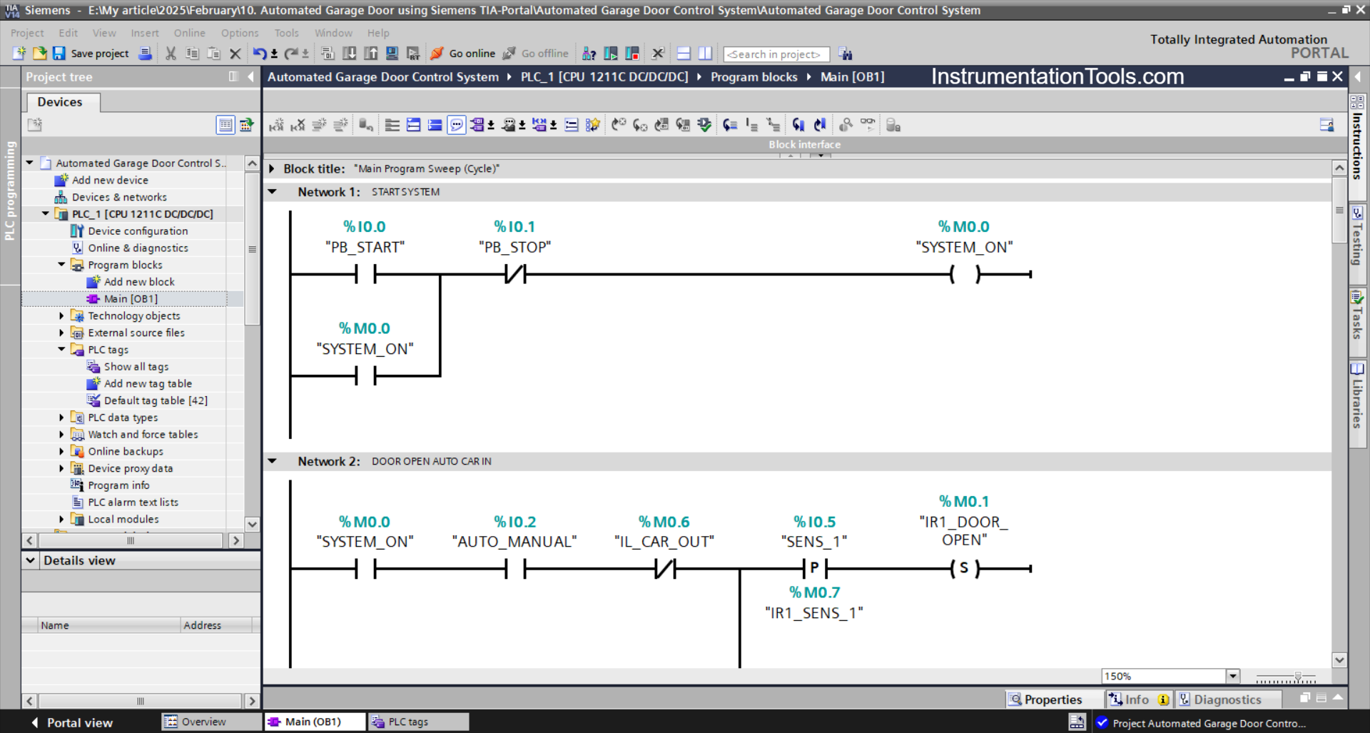

NETWORK 1 (START SYSTEM)
In this network, the memory bit SYSTEM_ON (M0.0) ​​will be in the HIGH state. If the PB_START (I0.0) button is Pressed. Because it uses Latching, the memory bit SYSTEM_ON (M0.0) will remain in the HIGH state even though the PB_START (I0.0) button has been Released.
If the PB_STOP (I0.1) button has been Pressed, the memory bit SYSTEM_ON (M0.0) will return to the LOW state.
NETWORK 2 (DOOR OPEN AUTO CAR IN)
In this network, if the NO contact of the memory bit SYSTEM_ON (M0.0), selector switch AUTO_MANUAL (I0.2), and sensor SENS_1 (I0.5) are in the HIGH state, then the memory bit IR1_DOOR_OPEN (M0.1) will be in the HIGH state.
When the NO contact of the limit switch LS_HIGH (I1.0) is in the HIGH state, the memory bit IR1_DOOR_OPEN (M0.1) will return to the LOW state. Because it uses the RESET output instruction.

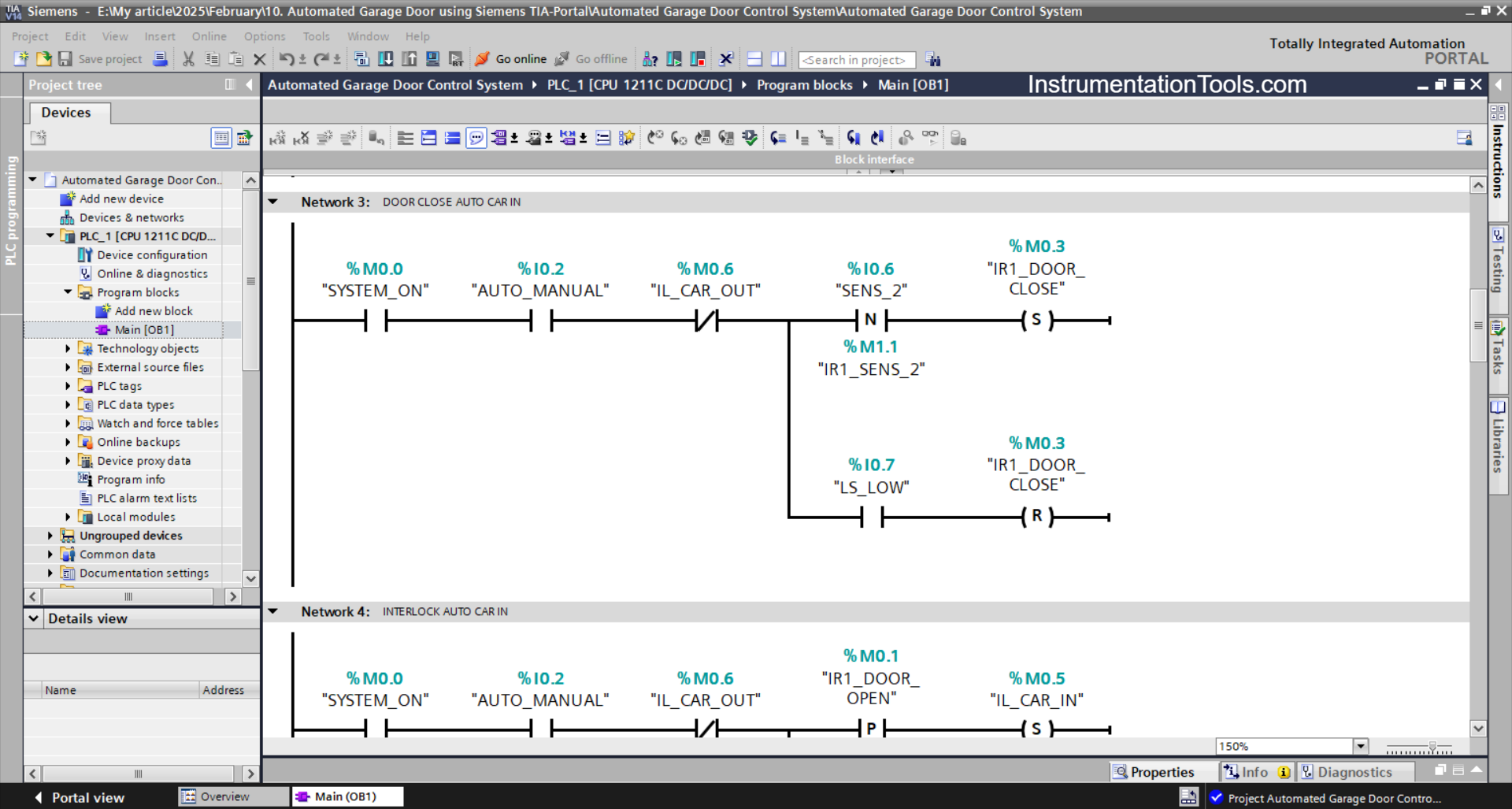

NETWORK 3 (DOOR CLOSE AUTO CAR IN)
In this network, if the NO contacts of the memory bit SYSTEM_ON (M0.0), the AUTO_MANUAL selector switch  (I0.2), and the SENS_2 (I0.6) sensor are in the HIGH state, then the memory bit IR1_DOOR_CLOSE (M0.3 will be in the HIGH state.
When the NO contact of the limit switch LS_LOW (I0.7) is in the HIGH state, the memory bit IR1_DOOR_CLOSE (M0.3) will return to the LOW state. Because it uses the RESET output instruction.

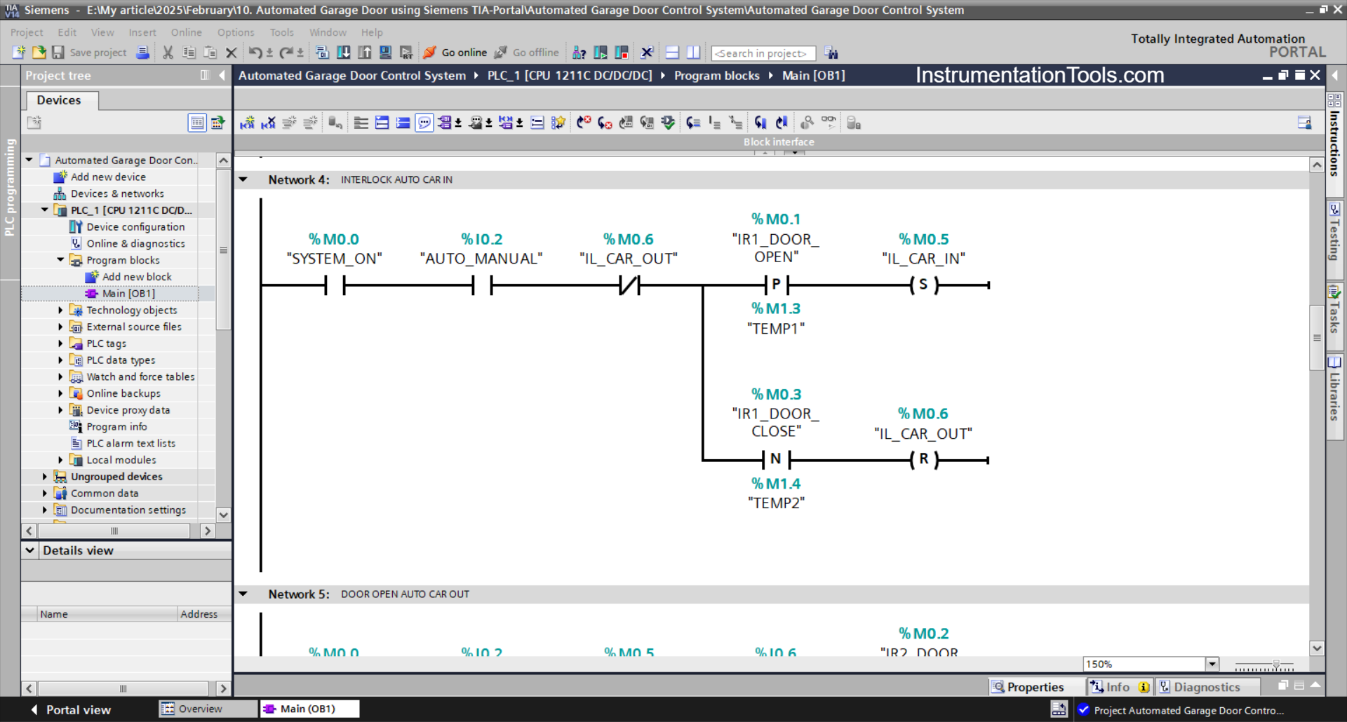

NETWORK 4 (AUTO CAR IN INTERLOCK)
In this network, if the NO contacts of the memory bit SYSTEM_ON (M0.0), IR1_DOOR_OPEN (M0.1), and AUTO_MANUAL (I0.2) are in the HIGH state, then the memory bit IL_CAR_IN (M0.5) will be in the HIGH state.
If the NO contact of the memory bit IR1_DOOR_CLOSE (M0.3) is in the HIGH state, then the memory bit IL_CAR_IN (M0.5) will return to the LOW state. Because it uses the RESET output instruction.

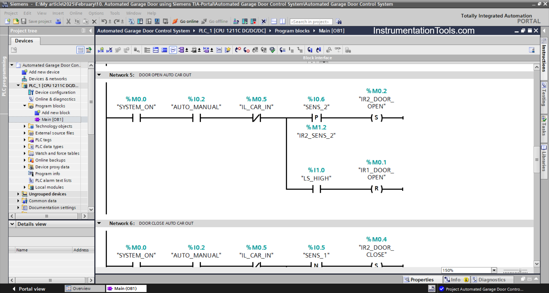

NETWORK 5 (DOOR OPEN AUTO CAR OUT)
In this network, if the NO contact of the bit memory SYSTEM_ON (M0.0), selector switch AUTO_MANUAL (I0.2), and sensor SENS_2 (I0.6) are in the HIGH state, then the memory bit IR2_DOOR_OPEN (M0.2) will be in the HIGH state.
When the NO contact of the limit switch LS_HIGH (I1.0) is in the HIGH state, the memory bit IR2_DOOR_OPEN (M0.2) will be in the LOW state. Because it uses the RESET output instruction.

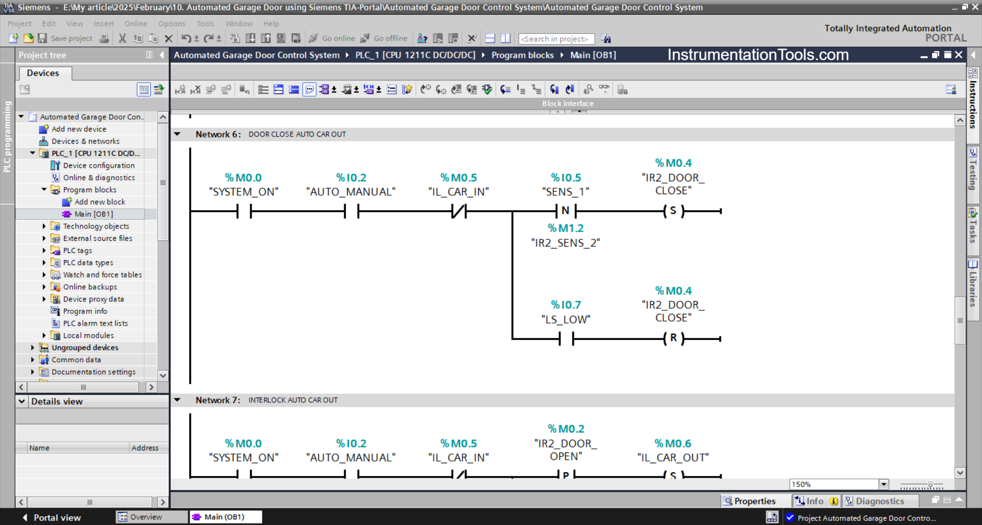

NETWORK 6 (DOOR CLOSE AUTO CAR OUT)
When the NO contact of the memory bit SYSTEM_ON (M0.0) ​​, AUTO_MANUAL selector switch (I0.2), and SENS_1 (I0.5) sensor are in the HIGH state, then the memory bit IR2_DOOR_CLOSE (M0.4) will be in the HIGH state.
The memory bit IR2_DOOR_CLOSE (M0.4) will return to the LOW state if the NO contact of the limit switch LS_LOW (I0.7) is in the HIGH state.

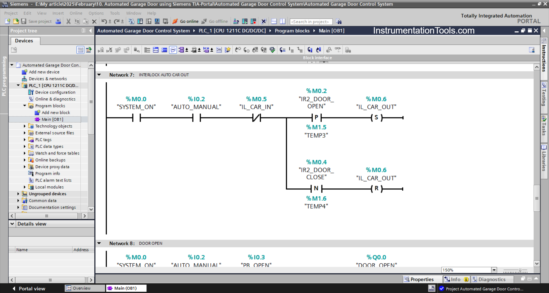

NETWORK 7 (AUTO CAR OUT INTERLOCK)
If the NO contacts of the memory bits SYSTEM_ON (M0.0), IR2_DOOR_OPEN (M0.2), and the selector switch AUTO_MANUAL (I0.2) are in the HIGH state, then the memory bit IL_CAR_OUT (M0.6) will be in the HIGH state.
When the NO contact of the memory bit IR2_DOOR_CLOSE (M0.4) is in the HIGH state, the memory bit IL_CAR_OUT (M0.6) will return to the LOW state.

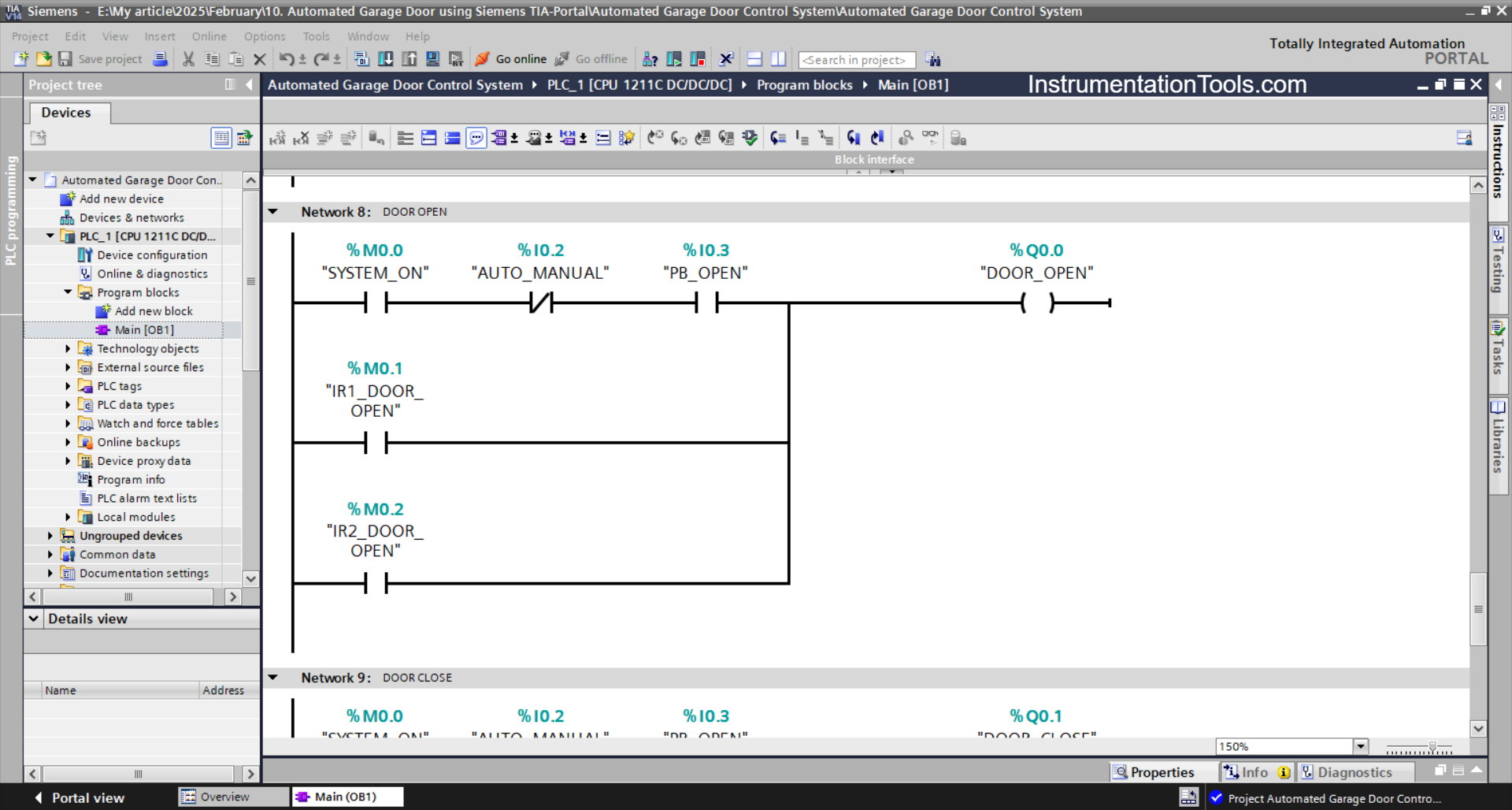

NETWORK 8 (DOOR OPEN)
In this network, when the NO contact of the memory bit SYSTEM_ON (M0.0), and the PB_OPEN (I0.3) button is Pressed, the DOOR_OPEN (Q0.0) output will be ON.
Or, if the NO contact of the memory bits IR1_DOOR_OPEN (M0.1) or IR2_DOOR_OPEN (M0.2) is in the HIGH state, then the output DOOR_OPEN (Q0.0) will be ON.

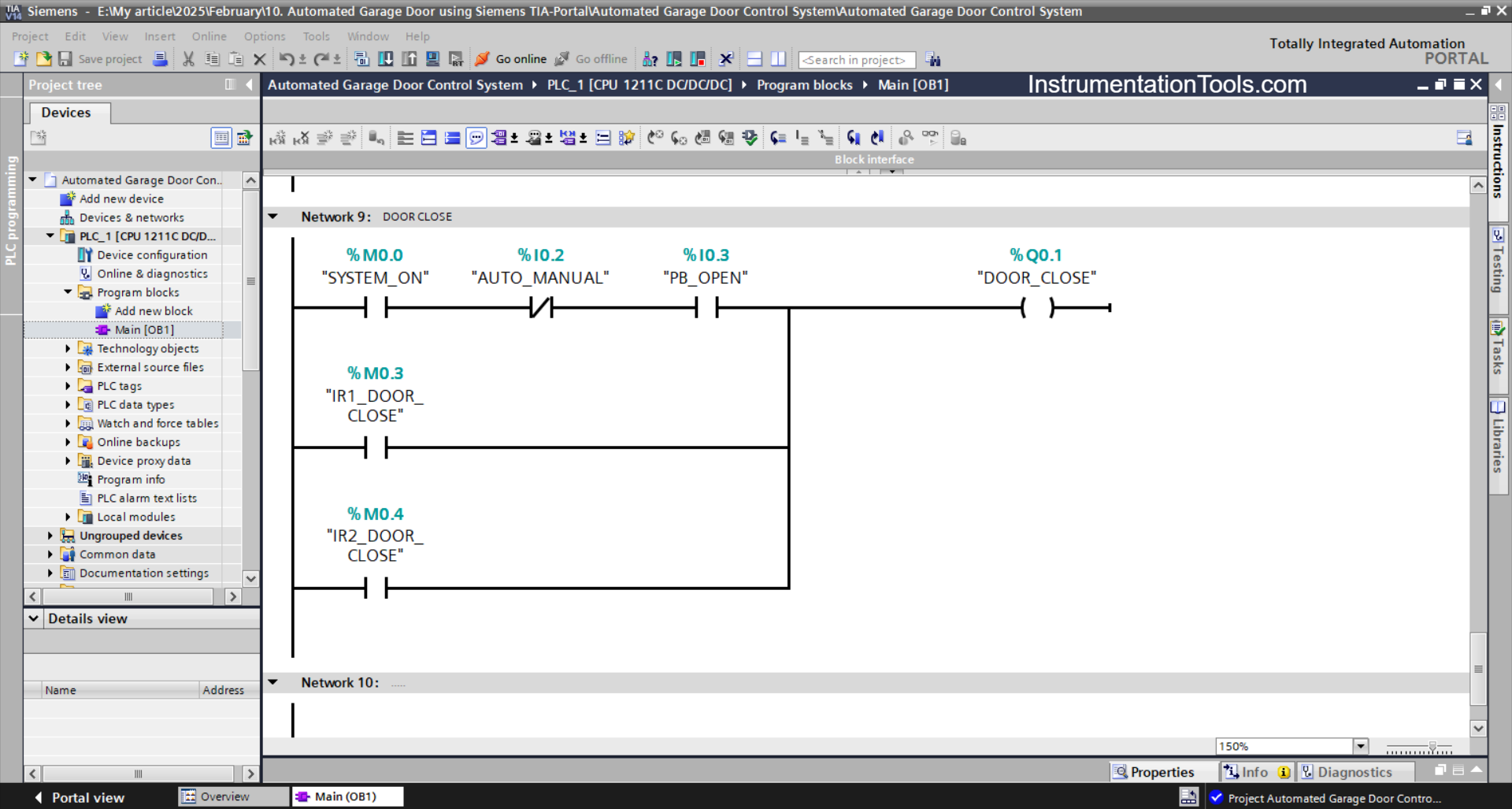

NETWORK 9 (DOOR CLOSE)
In this network, if the NO contact of the memory bit SYSTEM_ON (M0.0), and the PB_CLOSE (I0.4) button is Pressed, then the DOOR_CLOSE (Q0.1) output will be ON.
Or, if the NO contact of the memory bits IR1_DOOR_CLOSE (M0.3) or IR2_DOOR_CLOSE (M0.4) is in the HIGH state, then the output DOOR_CLOSE (Q0.1) will be ON.
