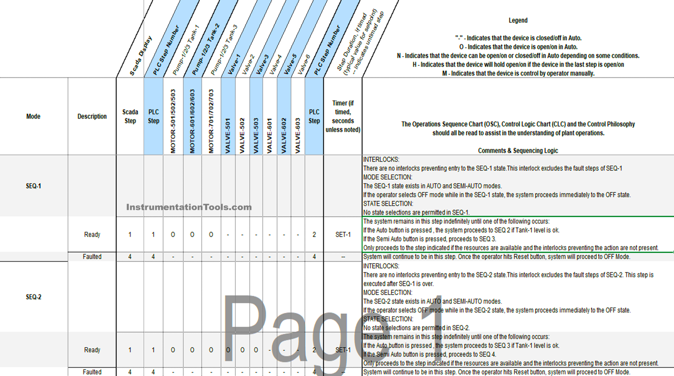

Refer to the image below for an example. Here, you can see that we have defined the names of equipment, mode name, description of the mode, and comments as the header. Basically, we intend to write each step, what outputs will be on or off during that step, how the transition will occur between each step, and the various states inside a particular step (like ready and fault here). Due to this, a programmer knows when the step needs to be executed simply, but in a very wide and broad way.
In the image, as you can see, we have defined two steps – Seq 1 and Seq 2. In them, we have two states – ready and fault. That means we need to define what action happens in each of the states. Then, we have a matrix of outputs, of 3 pumps and 6 valves. This is done to depict which output will remain on or off during a particular state of a sequence. Then, we have set values which will be entered from SCADA, for that particular sequence and step. Finally, we have comments that describe the working of each state, how it will jump to other states, and what interlocks are present for that state to run.
As you can see, the core idea was to explain to the programmer how the steps will be executed. A typical OSC will thus contain – what to do if something goes wrong, what moves the step to the next one, safety and process checks, what outputs are controlled in each step, what inputs are required for a particular step, an ordered list of all steps, what must be true before starting any step, and what modes of operation are present. An operation sequence chart is thus required if the sequence is vast and complex to understand with single-line statements. Such a matrix-type format makes it easy for a programmer to understand the whole system.
