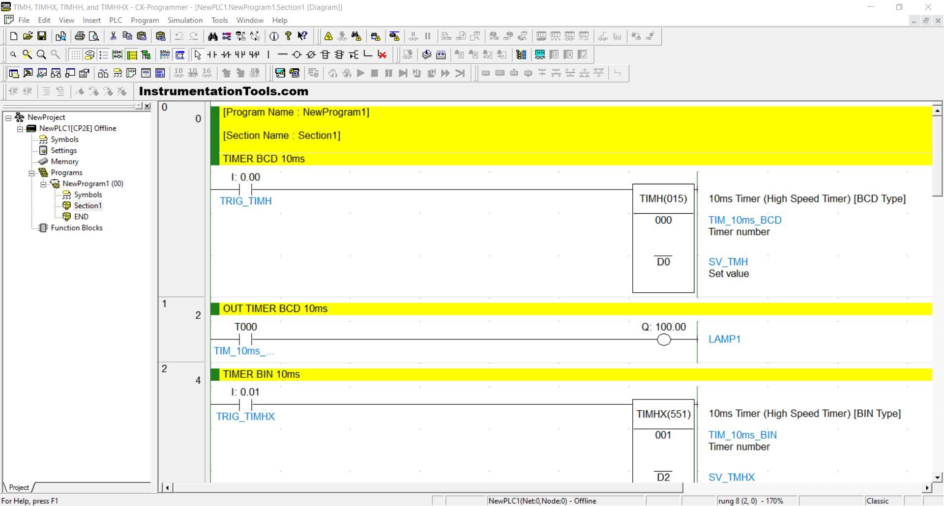

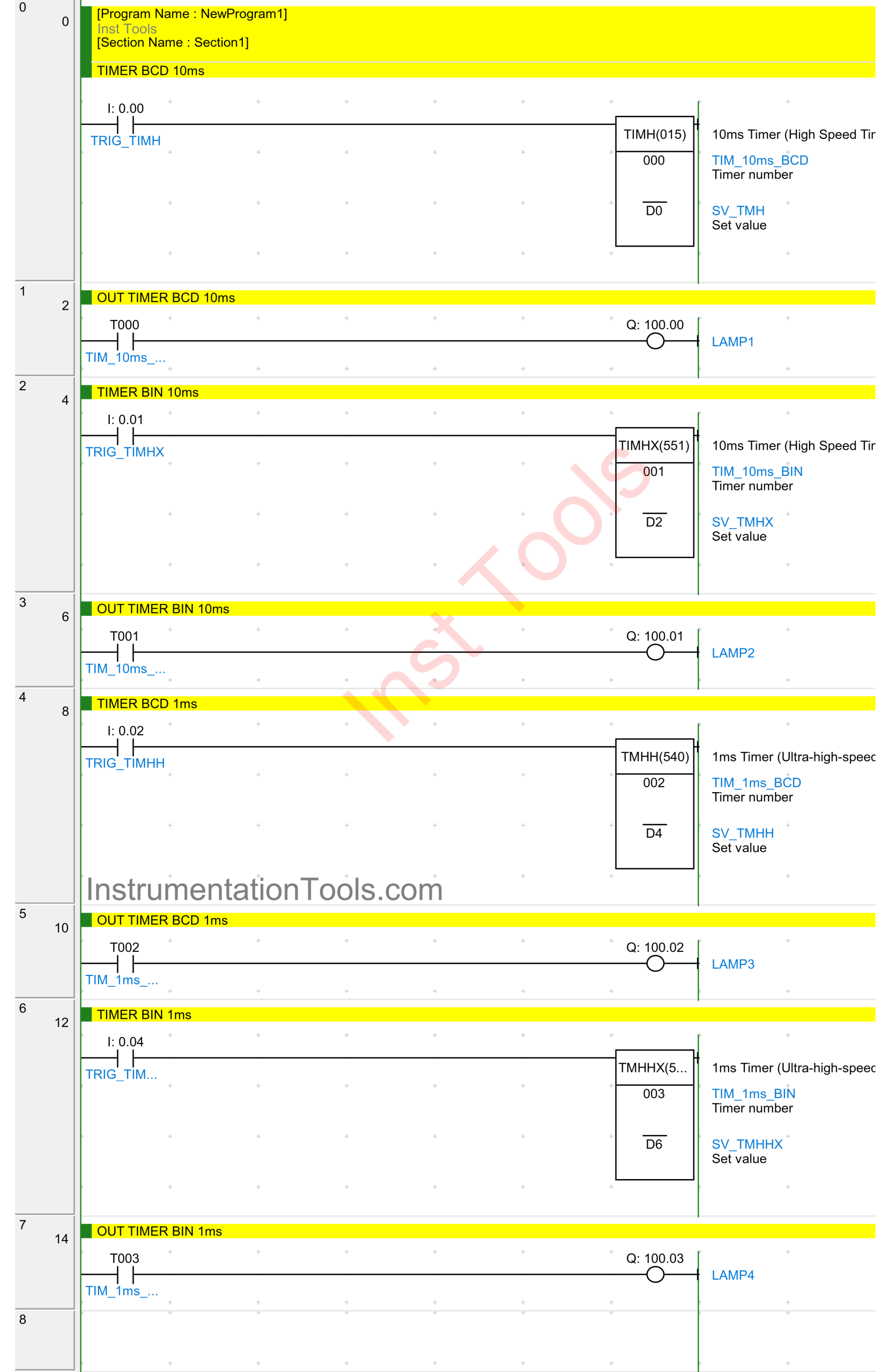

RUNG 0 (TIMER BCD 10ms)
In this Rung, if the TRIG_TIMH (0.00) button is pressed, then the TIMER_10ms_BCD (T000) timer instruction will start counting down according to the value stored in the memory word SV_TMH (D0), and when it has finished counting, the TIMER_10ms_BCD (T000) timer instruction will be ON.
The TIMER_10ms_BCD (T000) timer instruction will be OFF if the TRIG_TIMH (0.00) button has been released.
RUNG 1 (OUT TIMER BCD 10ms)
In this Rung, if the NO contact of TIMER_10ms_BCD (T000) is in the HIGH state, then the LAMP1 (100.00) output will be ON.

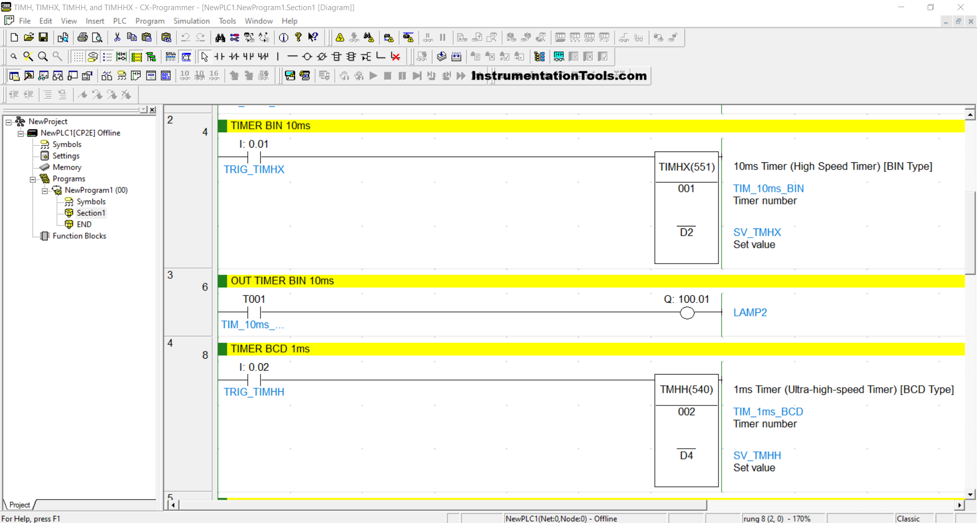

RUNG 2 (TIMER BIN 10ms)
In this Rung, if the TRIG_TIMHX (0.01) button is pressed, then the TIMER_10ms_BIN (T001) timer instruction will start counting down according to the value stored in the memory word SV_TMHX (D2), and when it has finished counting, the TIMER_10ms_BIN (T001) timer instruction will be ON.
If the TRIG_TIMHX (0.01) button has been released, then the TIMER_10ms_BIN (T001) timer instruction will be OFF.
RUNG 3 (OUT TIMER BIN 10ms)
In this Rung, the LAMP2 (100.01) output will be ON if the NO contact of TIMER_10ms_BIN (T001) is in the HIGH state.

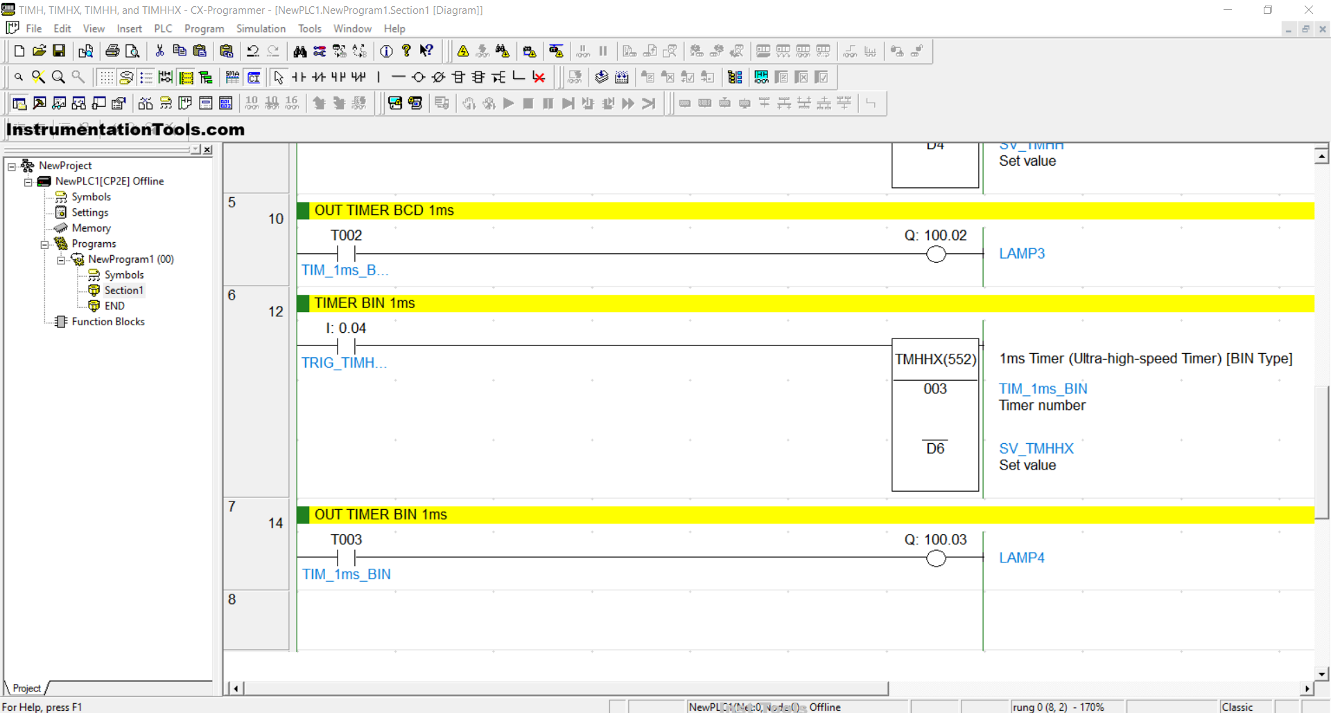

RUNG 4 (TIMER BCD 1ms)
In this Rung, if the TRIG_TIMHH (0.02) button is pressed, the TIMER_1ms_BCD (T002) timer instruction will start counting down according to the value stored in the memory word SV_TMHH (D4). After finishing counting, the TIMER_1ms_BCD (T002) timer instruction will become ON.
The TIMER_1ms_BCD (T002) timer instruction will only be OFF if the TRIG_TIMHH (0.02) button has been released.
RUNG 5 (OUT TIMER BCD 1ms)
In this Rung, the output LAMP3 (100.02) will be ON if the NO contact of TIMER_1ms_BCD (T002) is in the HIGH state.
RUNG 6 (TIMER BIN 1ms)
In this Rung, if the TRIG_TIMHHX (0.04) button is pressed, the TIMER_1ms_BIN (T003) timer instruction will start counting down according to the value stored in the memory word SV_TMHHX (D6). After finishing counting, the TIMER_1ms_BIN (T003) timer instruction will be ON.
The TIMER_1ms_BIN (T003) timer instruction will only be OFF if the TRIG_TIMHHX (0.04) button has been released.
RUNG 7 (OUT TIMER BIN 1ms)
In this Rung, the LAMP4 (100.03) output will be ON if the NO contact of TIMER_BIN (T003) is in the HIGH state.
