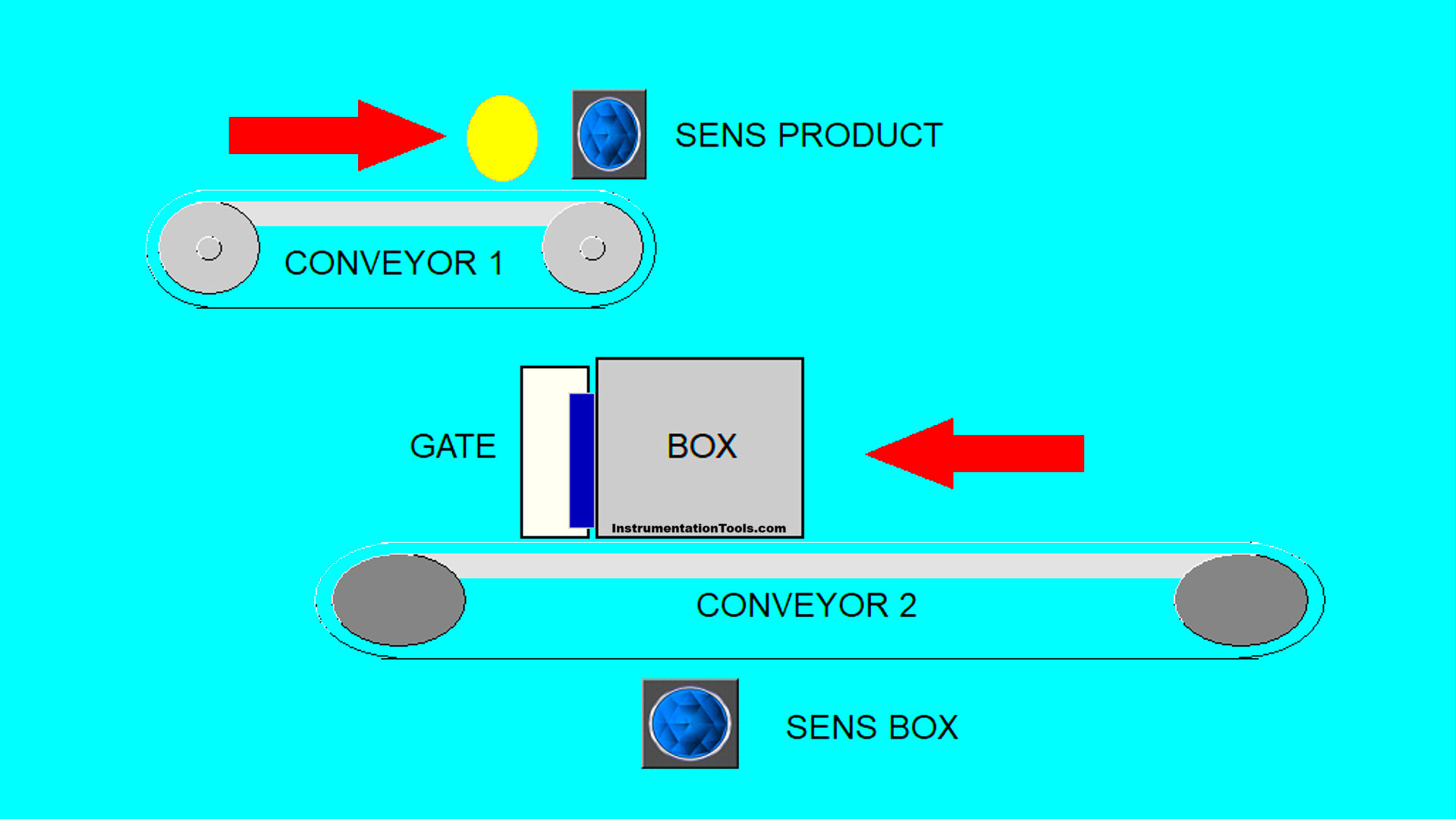

- Conveyor 1 (top) is used to transport products and drop them into a box, while Conveyor 2 (bottom) is positioned below Conveyor 1 and is equipped with a retaining gate to control the movement of the box.
- The box will collect the products dropped by Conveyor 1, while Conveyor 2 operates continuously to move the box forward.
- Once the box is filled with a certain amount of products, the system will stop Conveyor 1, open the gate, and allow the box to continue moving.
- The gate will close again once it detects a new box ready to be filled.
- After the gate is closed, Conveyor 1 will reactivate to drop products into the next box, and this cycle repeats automatically.

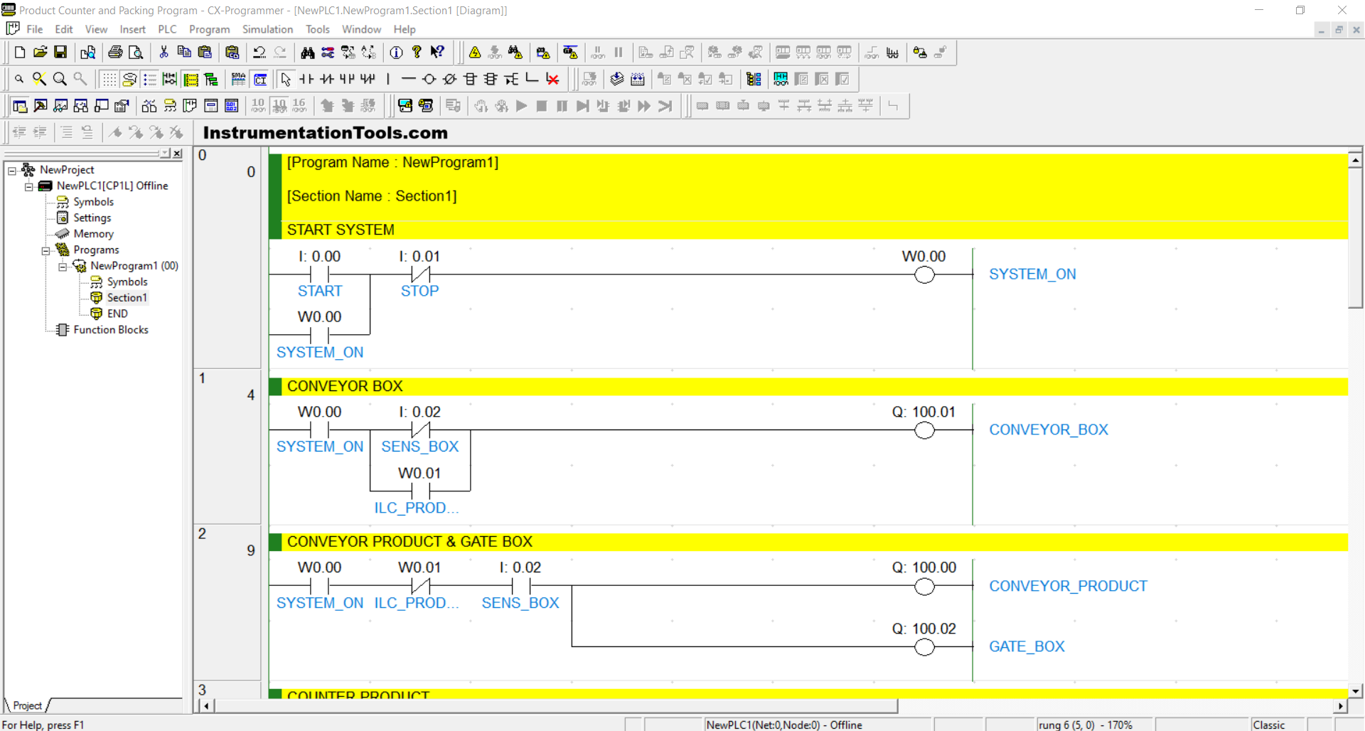

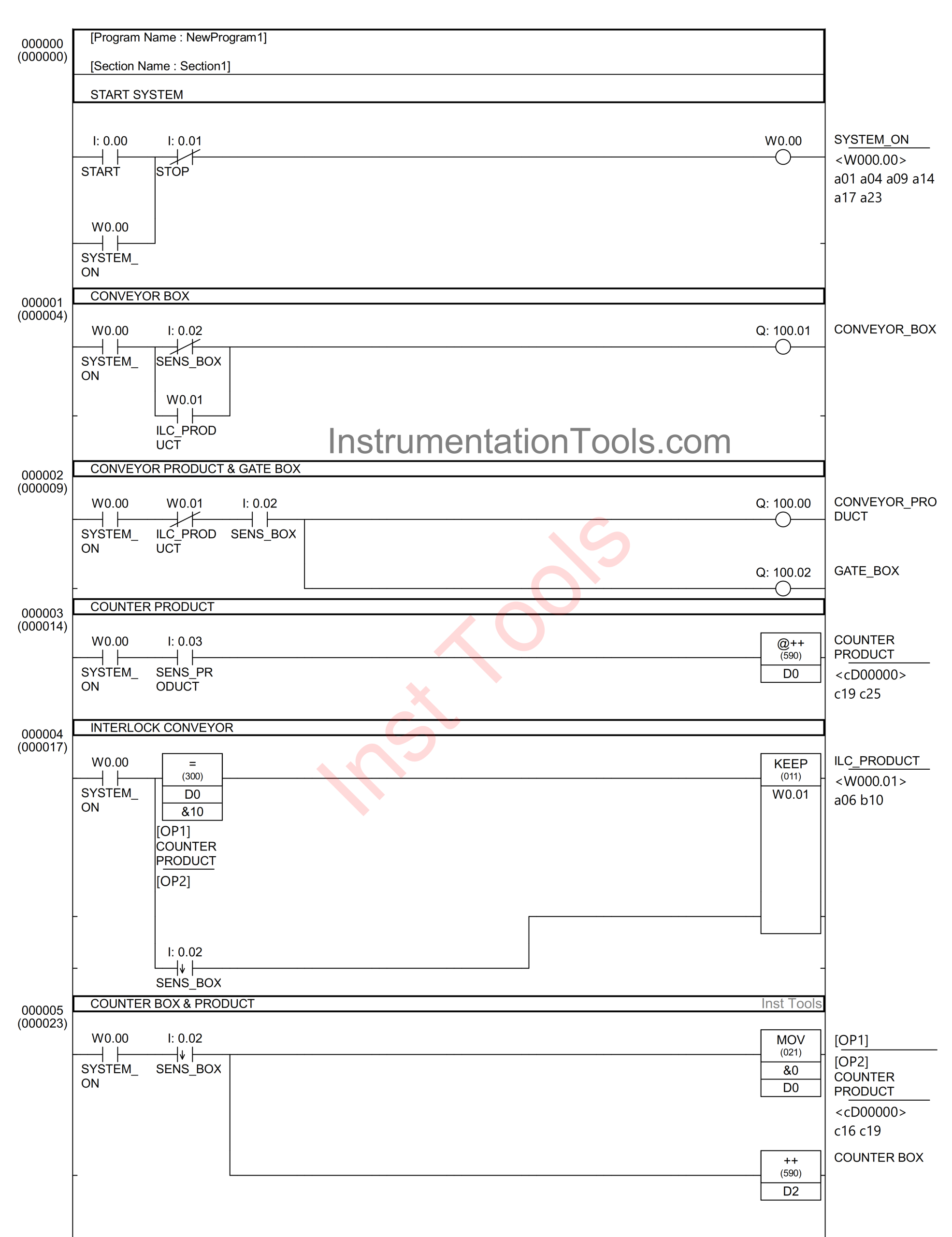

RUNG 0 (START SYSTEM)
In this rung, if the START (0.00) button is pressed, the memory bit SYSTEM_ON (W0.00) will be set to a HIGH state. Because it uses latching, the memory bit SYSTEM_ON (W0.00) will remain in a HIGH state even after the START (0.00) button is released.
The memory bit SYSTEM_ON (W0.00) will return to a LOW state when the STOP (0.01) button is pressed.
RUNG 1 (CONVEYOR BOX)
In this rung, if the NO contact of the memory bit SYSTEM_ON (W0.00) is in a HIGH state and the NC contact of the SENS_BOX (0.02) sensor is also in a LOW state, then the output CONVEYOR_BOX (100.01) will turn ON.
Alternatively, if the NO contacts of the memory bits SYSTEM_ON (W0.00) and ILC_PRODUCT (W0.01) are in a HIGH state, the CONVEYOR_BOX (100.01) output will also turn ON.
RUNG 2 (CONVEYOR PRODUCT & GATE BOX)
If the NO contacts of the memory bit SYSTEM_ON (W0.00) and the SENS_BOX (0.02) sensor are in a HIGH state, then the CONVEYOR_PRODUCT (100.00) and GATE_BOX (100.02) outputs will turn ON.
When the NC contact of the memory bit SYSTEM_ON (W0.00) is in a HIGH state, the CONVEYOR_PRODUCT (100.00) and GATE_BOX (100.02) outputs will turn OFF.

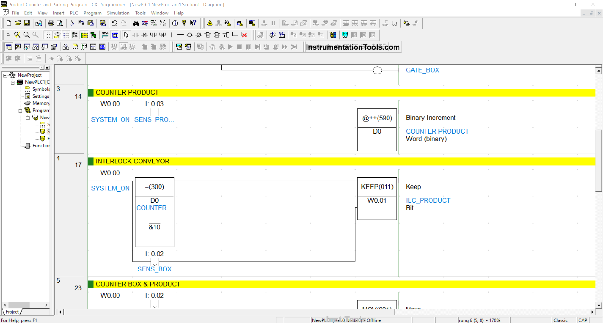

RUNG 3 (PRODUCT COUNTER)
When the NO contact from the memory bit SYSTEM_ON (W0.00) and the sensor SENS_PRODUCT (0.03) are in a HIGH state, the value in the memory word COUNTER_PRODUCT (D0) will increase (+1), because it uses the Binary Increment/@++ (590) instruction.
RUNG 4 (CONVEYOR INTERLOCK)
When the NO contact from the memory bit SYSTEM_ON (W0.00) is in a HIGH state and the value of the memory word COUNTER_PRODUCT (D0) is Equal to “10”, the memory bit ILC_PRODUCT (W0.01) will turn to a HIGH state.
Additionally, when the NO contact from the sensor SENS_BOX (0.02) is in a HIGH state, the memory bit ILC_PRODUCT (W0.01) will change to a LOW state.

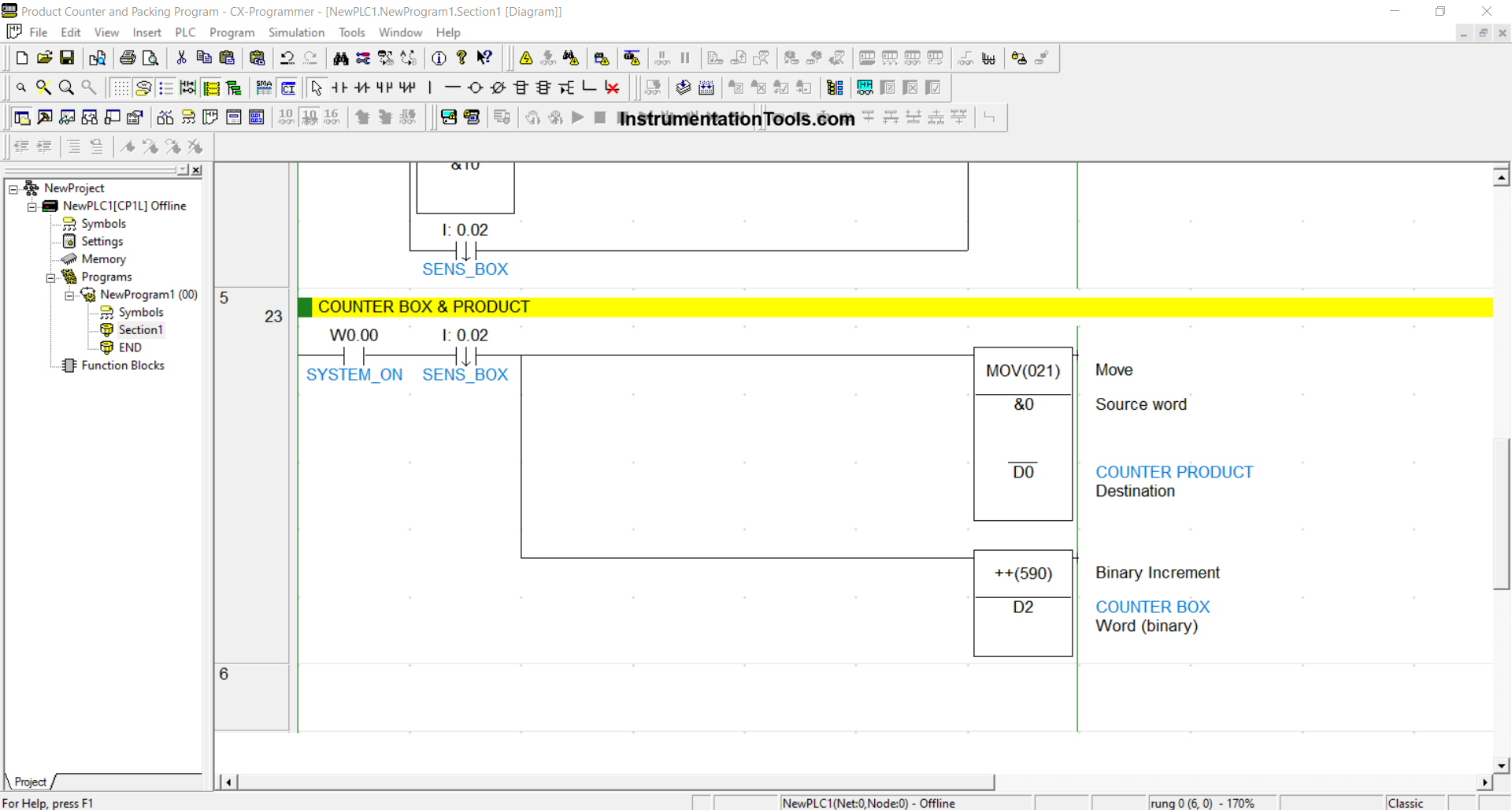

RUNG 5 (COUNTER BOX & PRODUCT)
When the NO contact of the memory bit SYSTEM_ON (W0.00) and the sensor SENS_BOX (0.02) are in a HIGH state, the value in the memory word COUNTER PRODUCT (D0) will be reset to zero “0”.
Additionally, the value in the memory word COUNTER BOX (D2) will increase (+1), because it is using the Binary Increment instruction / @++(590).
