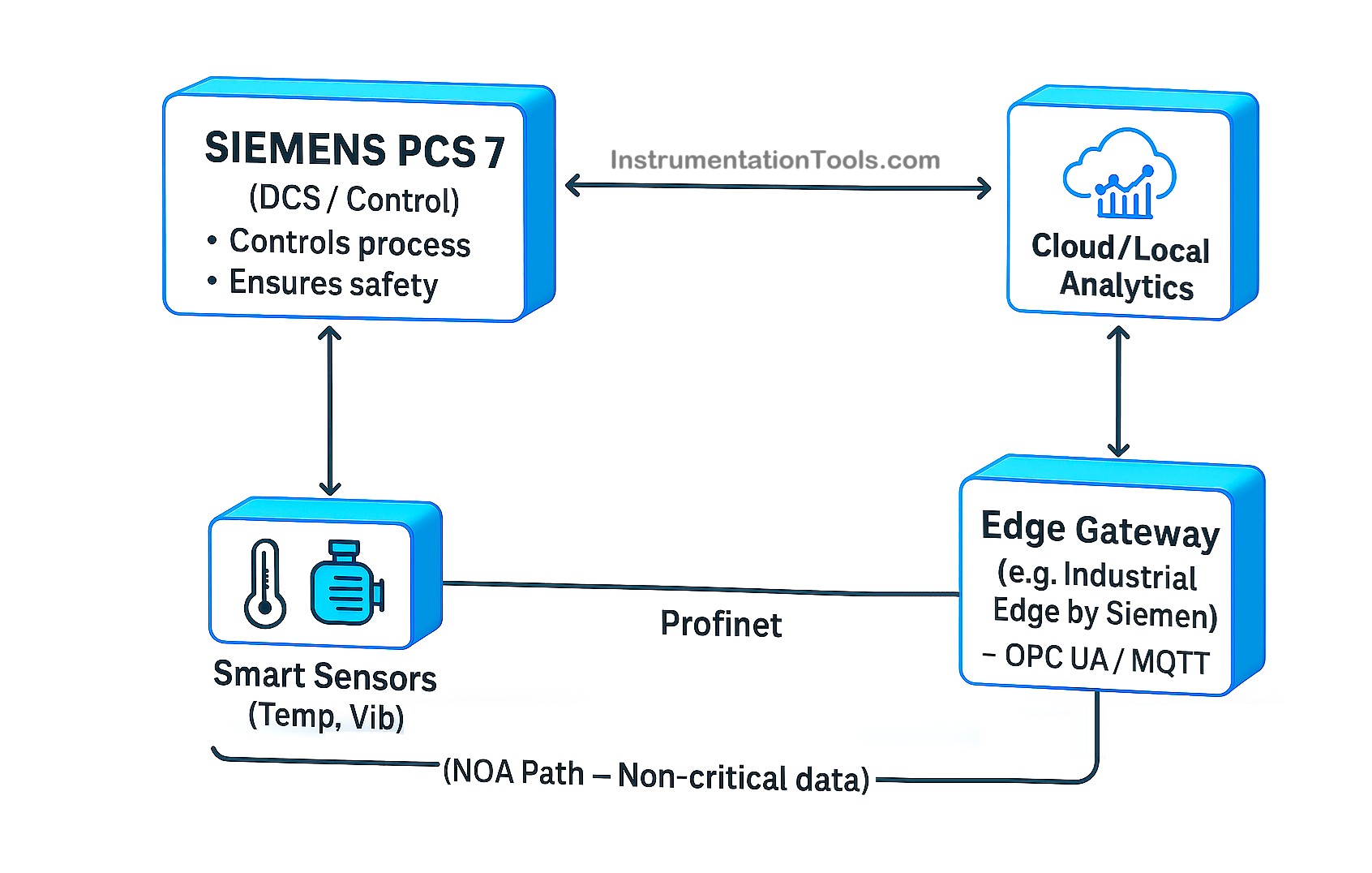

Refer to the image below. Let us understand the case first. We have a Siemens PLC which takes data from an existing pump, monitoring temperature and vibration. The PLC does not have connectivity to the cloud service through MQTT or OPC. But, the data from the pump is required for advanced monitoring of the plant and aiding in timely maintenance more easily. So, there arises a question as to how we can send the data from the pump sensors without affecting the current plant operation? This brings NAMUR open architecture into the picture.
NAMUR OPEN ARCHITECTURE
Let us understand each point step by step:
Our first core plan is to develop a parallel path with the primary path without disturbing it. With that path, we need to transmit all the non-critical data from the sensor to the cloud service. So, we first need to identify the current type of sensor used.
There are two cases: smart or non-smart. If the sensor installed is already smart and has connectivity like OPC, IO LINK, MQTT, or HART, then we can directly fetch data from that. But if the sensor is non-smart, then we need to install a parallel sensor with the connections mentioned. The sensor ideally should be contactless (like ultrasonic, AI vision, or infrared), which can then be easily set up in the existing line (suppose a water pipeline) without digging anything in the pipeline or disturbing any other contact.
Next, you need to transmit data from the sensor through OPC, IO LINK, HART, or MQTT. If there are very few sensors, then the sensor can directly connect to the cloud. But, the general practice, irrespective of the number of sensors, is to use an Edge Gateway device (can be of different makes like Siemens, Beckhoff, Belden, etc.) to connect to the cloud. It is because of the following reasons:
  • Faster data processing
  • Instead of sending multiple sensor data to the cloud data, a single gateway will take all the data and send the package to the cloud.
  • Gateway has strong encryption and cybersecurity features, making it difficult to hack.
  • Internal memory storage options are high for saving a large amount of data from the sensors, even if they are in a power-off condition.
    Due to this, our purpose of sending data from the field to the cloud is now fulfilled.
    In the next step, you get all the data in the IoT cloud. You can then show this data in SCADA or use it for other advanced purposes like ERP, MES, or predictive maintenance.
    Now, what if you want this data in PLC without disturbing anything? Well, that is possible, but don’t use it for controlling anything, as controlling is already being done by the primary sensor. You can add rungs in the PLC program for fetching data through the existing communication protocols. And since in our case, we don’t have MQTT or OPC in PLC, the best way is to read it in SCADA first, and then transfer through the existing line, like Modbus or Ethernet, whichever is connected. So, do not touch any existing control logic or overwrite any existing variable. Create everything as new.
