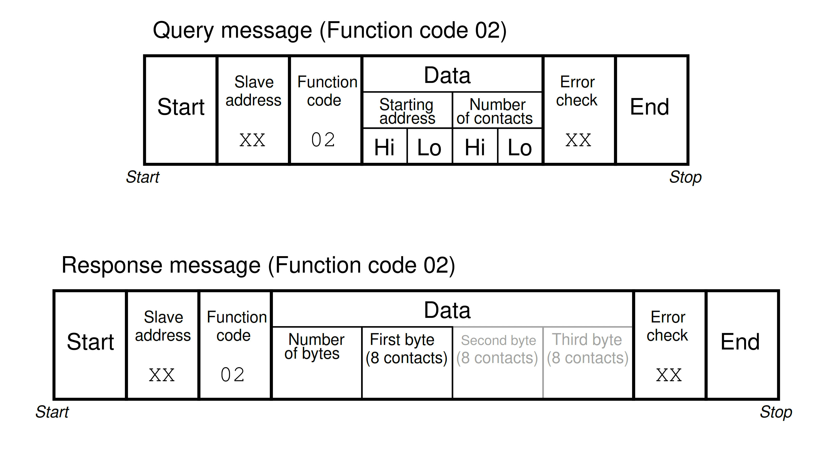

Modbus Function Code 02 – Read Contact
This Modbus function reads the statuses of slave device discrete inputs (“contacts”) within the slave device, returning those statuses in blocks of eight (even if the “number of contacts” specified in the query is not a multiple of eight!).
Modbus Function code 02 – Read Contact(s)
Relevant Modbus addresses for this function range from 10001 to 19999 (decimal), but the starting address is a hexadecimal number representing the (n – 1)th register from the beginning of this range (e.g. absolute decimal address 10256 would be specified as hexadecimal 0x00FF: the “Hi” byte being 00 and the “Lo” byte being FF).
