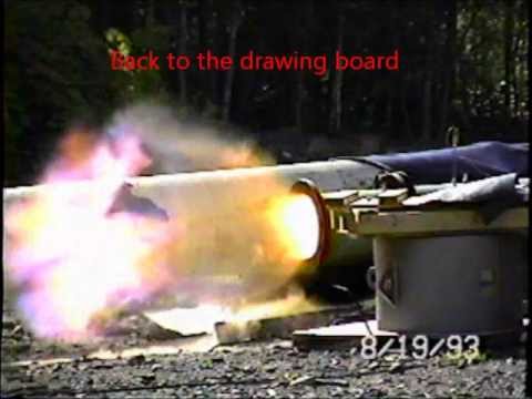

Under normal operating conditions the flame arrester permits a relatively free flow of gas or vapor through the piping system. If the mixture is ignited and the flame begins to travel back through the piping, the arrester will prohibit the flame from moving back to the gas source.
Most detonation flame arrester applications are in systems which collect gases emitted by liquids and solids. These systems, commonly used in many industries, may be called vapor control systems. The gases which are vented to atmosphere or controlled via vapor control systems are typically flammable. If the conditions are such that ignition occurs, a flame inside or outside of the system could result, with the potential to do catastrophic damage.
Flame Arrester
Image Courtesy – Paradox Intellectual Properties Inc.
Figure: This Detonation Flame Arrester is being tested for an 8-inch piping system
