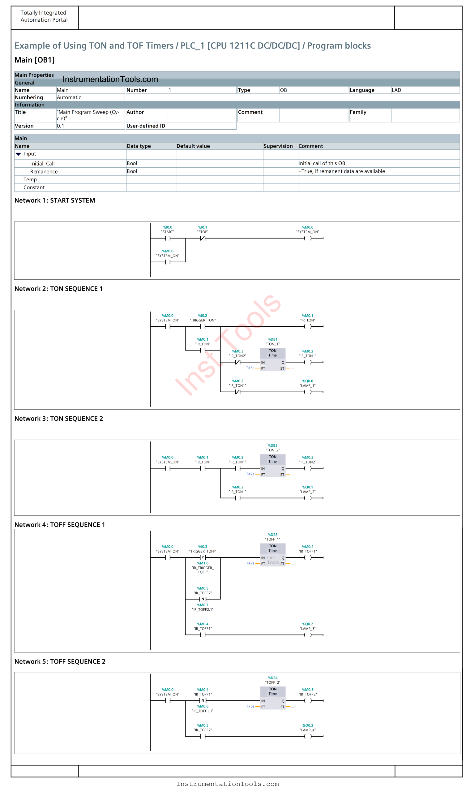

Exercise with Delay Timers

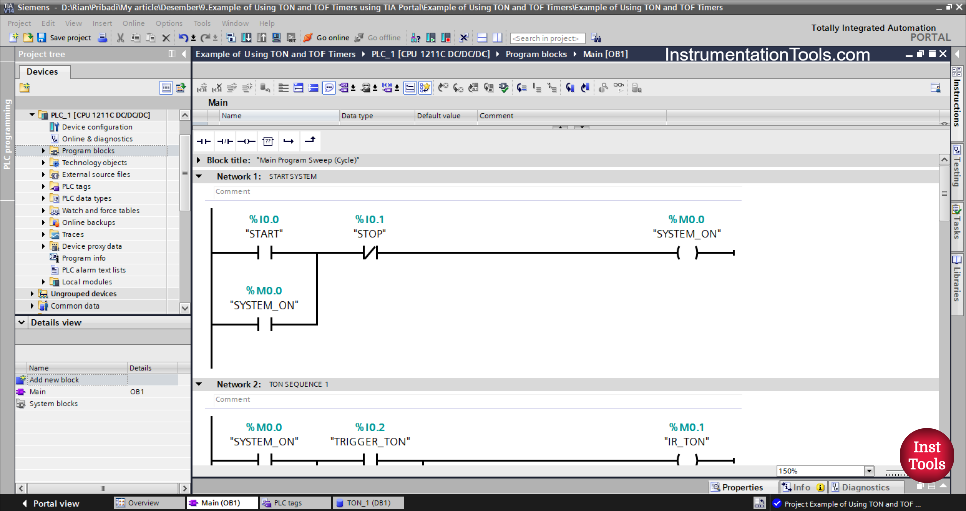

NETWORK 1 (START SYSTEM)
In this Network, when the START (I0.0) button is pressed, the memory bit SYSTEM_ON (M0.0) ​​ will be in the HIGH state. Even though the START (I0.0) button has been released, the memory bit SYSTEM_ON (M0.0) will remain in the HIGH state. Because it uses Latching.
The memory bit SYSTEM_ON (M0.0) will be in the LOW state if the STOP (I0.1) button is pressed.

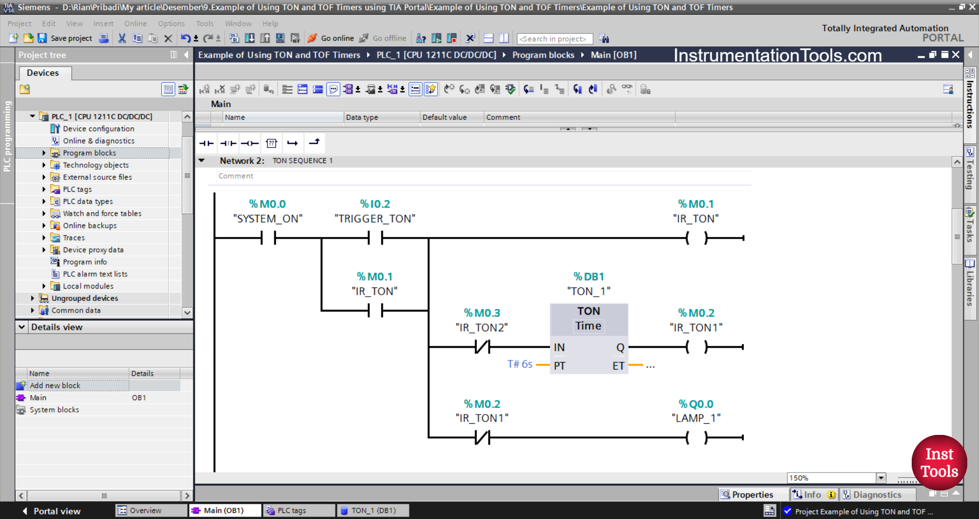

NETWORK 2 (TON SEQUENCE 1)
In this Network, the memory bit IR_TON (M0.1) will be in the HIGH state, and the output LAMP_1 (Q0.0) will be ON when the NO contact of the memory bit SYSTEM_ON (M0.0) is in the HIGH state and the TRIGGER_TON (I0. 2) button has been pressed. Timer TON_1 (DB1) Starts counting up to 6 seconds.
Because it uses Latching, even though the TRIGGER_TON (I0.2) button has been released, the memory bit IR_TON (M0.1) will remain in the HIGH state.
When Timer TON_1 (DB1) has finished counting, the output LAMP_1 (Q0.0) will be OFF and the memory bit IR_TON1 (M0.2) will be in the HIGH state.
Timer TON_1 (DB1) will be reset when the NC contact of the memory bit IR_TON2 (M0.3) is in the HIGH state.
NETWORK 3 (TON SEQUENCE 2)
In this Network, the NO contact of the memory bit SYSTEM_ON (M0.0) and the memory bit IR_TON (M0.1) are in the HIGH state. Then the timer TON_1 (DB1) starts counting up to 5 seconds and the output LAMP_1 (Q0.0) becomes ON.
When Timer TON_1 (DB1) has finished counting, the memory bit IR_TON2 (M0.3) will be in the HIGH state.

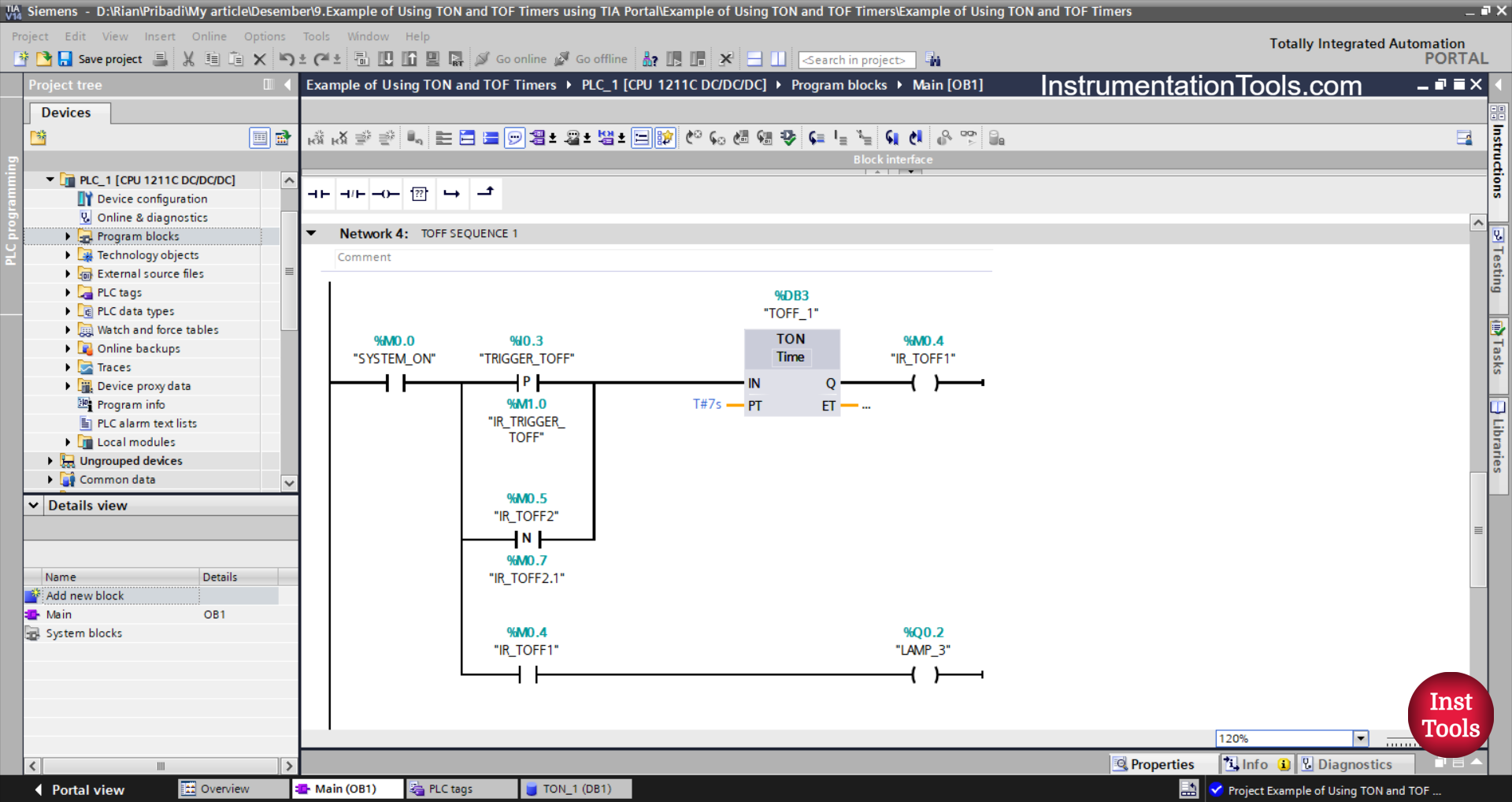

NETWORK 4 (TOFF SEQUENCE 1)
In this Network, Timer TOFF_1 (DB3) starts counting when the NO contact of the memory bit SYSTEM_ON (M0.0)Â in the HIGH state and the TRIGGER_TOFF (I0.3) button are pressed.
The TRIGGER_TOFF (I0.3) button will provide a momentary Trigger to Timer TOFF_1 (DB3) when conditions change from LOW to HIGH state. Because the TRIGGER_TOFF button (I0.3) uses a NO contact of the Positive Signal Edge type.
Next, Timer TOFF_1 (DB3) counts up to 7 seconds. The output LAMP_3 (Q0.2) will be ON, and the memory bit IR_TOFF1 (M0.4) will be in HIGH state for 7 seconds.
When the NO contact of memory bit IR_TOFF1 (M0.4) is in a HIGH state, it will provide a momentary trigger to Timer TOFF_1 (DB3) again.
Because the NO memory bit contact IR_TOFF1 (M0.4) uses the Negative Signal Edge type, the TOFF_1 Timer (DB3) will receive a momentary trigger when the state of the NO memory bit contact IR_TOFF1 (M0.4) changes from HIGH to LOW.

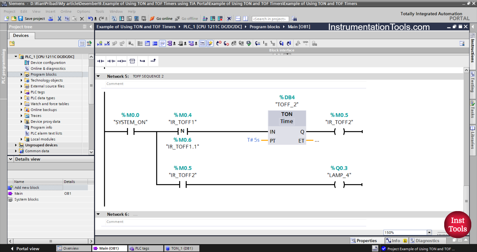

NETWORK 5 (TOFF SEQUENCE 2)
Next, the timer TOFF_2(DB4) will start counting when the NO contacts of the memory bit SYSTEM_ON(M0.0) ​​and IR_TOFF1 (M0.4) are in the HIGH state.
Because the NO contact of the memory bit IR_TOFF 1(M0.4) uses a Negative Signal Edge type contact, then the Timer TOFF_2(DB4) will receive a momentary trigger when the condition changes from HIGH to LOW state of the NO contact memory bit IR_TOFF1 (M0.4).
TOFF_2 (DB4) will count up to 5 seconds, output LAMP_3 (Q0.2) will be ON, and memory bit IR_TOFF2(M0.5) will be in HIGH state for 5 seconds.
