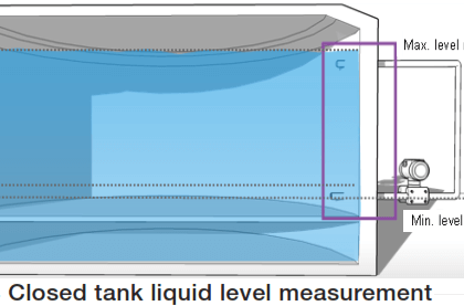

Seals function as an extension of the transmitter. The basic measurement of level follows the same principle as pressure transmitters without seals: pressure is proportional to level. The head pressure of the liquid corresponds to its height multiplied by the specific gravity. The prudent selection of remote seals is important in maintaining a reasonable performance expectation of the pressure transmitter.
An open tank, single seal system, with the transmitter below the tap, is very similar to a transmitter system that uses impulse piping going to the transmitter filled with process fluid. The difference is that the distance between the tap and the transmitter must be calculated with the specific gravity (S) of the fill fluid instead of the process fluid. Note this is the vertical distance, not the capillary length.
Seals offer another advantage over wet legs there is more versatility for mounting the transmitter. The transmitter can be located above the tap. This is particularly helpful when the tank is buried or if the transmitter must be located in a more convenient area. The transmitter can be mounted above the tap as long as the back pressure on the seal does not exceed 1 atmosphere of pressure (33.9 feet). When the seal is above the tap, the level calculation is slightly different because the distance must be subtracted from the level instead of added.
In closed systems, the transmitter location is restricted by the maximum allowable distance above the lower tap. In pressurized systems, this is the same as the 1 atmosphere equivalent seen previously. In sub-atmospheric systems (vacuum systems), the transmitter should be mounted at or below the lower tap. This ensures the transmitter always sees a positive pressure on both the measurement and the reference sides.
In two seal systems, the distance between the taps becomes the reference offset from zero. The calculations are the same regardless of where the transmitter is mounted.
