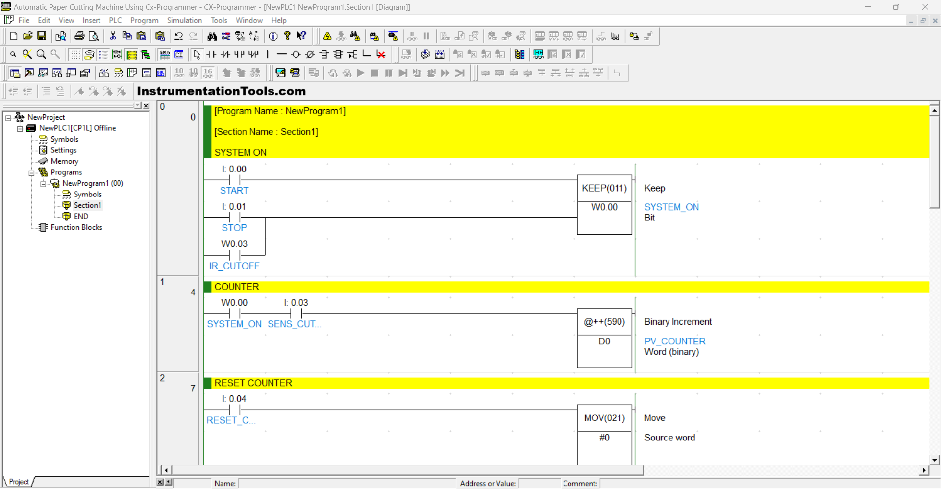

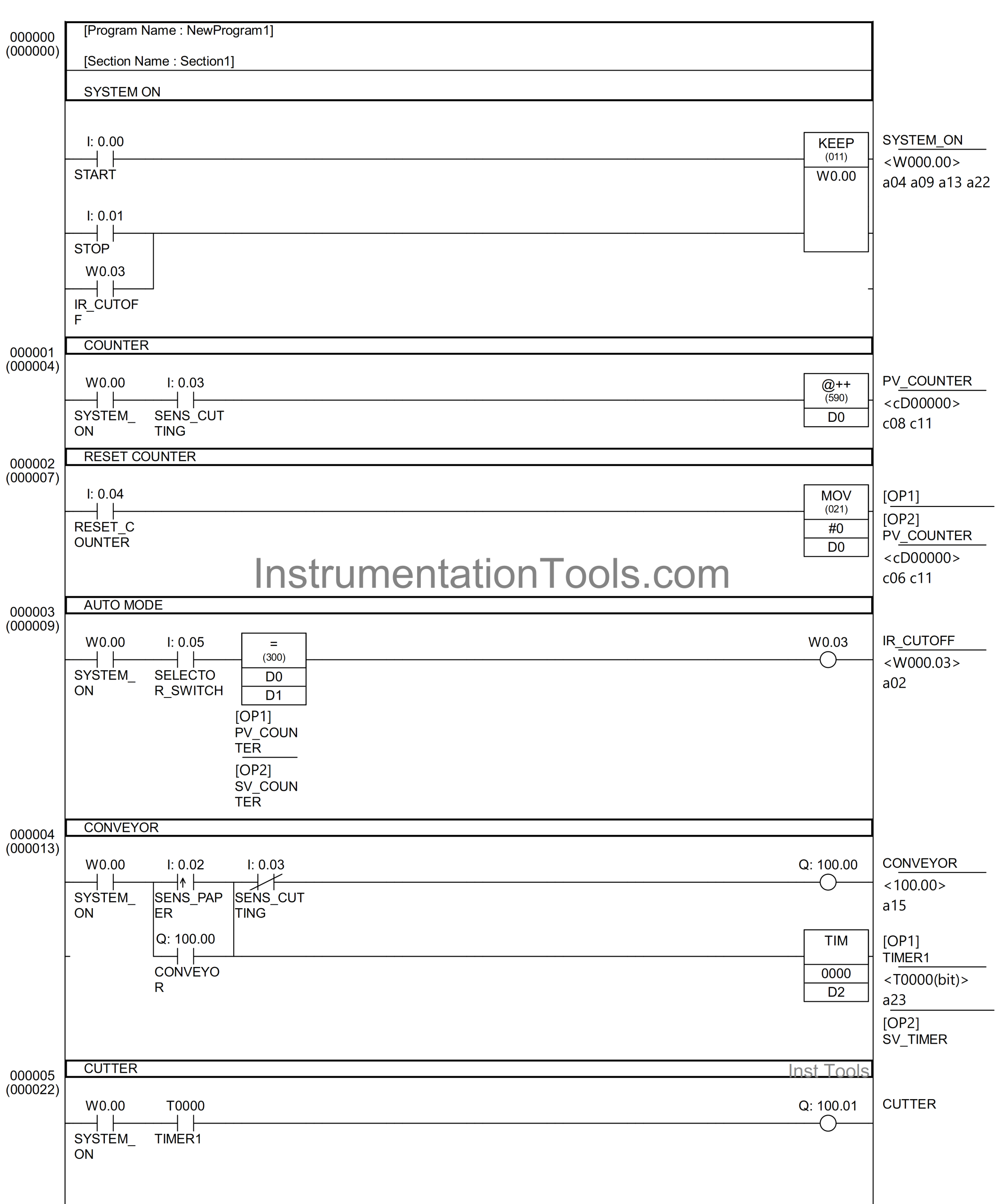

RUNG 0 (SYSTEM_ON)
In this Rung, when the START (0.00) button is Pressed, the memory bit SYSTEM_ON (W0.00) will be in the HIGH state. The memory bit SYSTEM_ON (W0.00) will remain in the HIGH state even though the START (0.00) button has been Released, because it uses the KEEP(011) instruction.
If the STOP (0.01) button is Pressed or the NO contact of the memory bit IR_CUTOFF (W0.03) in the HIGH state, then the memory bit SYSTEM_ON (W0.00) will be in the LOW state.
RUNG 1 (COUNTER)
In this Rung, when the NO contact of the memory bit SYSTEM_ON (W0.00) and Sensor SENS_CUTTING (0.03) are in the HIGH state, then the value in the memory word PV_COUNTER (D0) will increase (+1) because it uses the @++(590) instruction.
PLC based paper cutting machine control

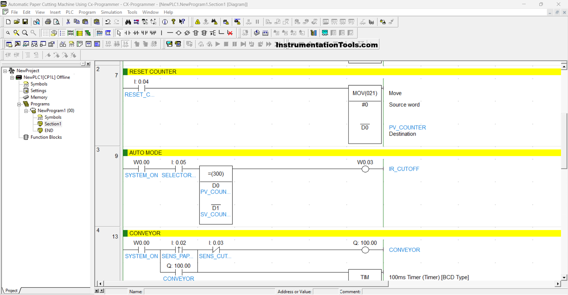

RUNG 2 (RESET COUNTER)
In this Rung, when the RESET_COUNTER (0.04) button is Pressed, the value in the memory word PV_COUNTER (D0) will be Reset to zero “0”. This is because the MOV(021) instruction moves the zero “0” value to the memory word PV_COUNTER (D0).
RUNG 3 (AUTO MODE)
In this Rung, when the NO contact of the memory bit SYSTEM_ON (W0.00) and the Selector Switch is in the HIGH state and the value in the memory word PV_COUNTER (D0) is Equal To SV_COUNTER (D1), then the memory bit IR_CUTOFF (W0.03) will be in the HIGH state.
Paper cutting automation using ladder logic

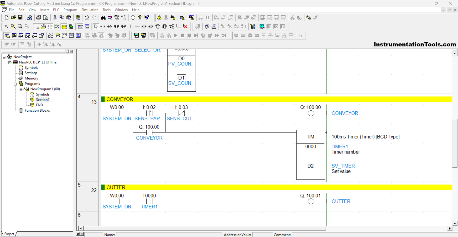

RUNG 4 (CONVEYOR)
In this Rung, when the NO contact of the memory bit SYSTEM_ON (W0.00) and Sensor SENS_PAPER (0.02) in the HIGH state, the output CONVEYOR (100.00) will be ON and Timer TIMER1 (T0000) will Start counting until it reaches the parameter value that has been Set in the memory word SV_TIMER (D2).
When the NC contact of Sensor SENS_CUTTING (0.03) is in the HIGH state, the output CONVEYOR (100.00) will be OFF, and Timer TIMER1 (T0000) will be Reset.
RUNG 5 (CUTTER)
In this Rung, when the NO contact of the memory bit SYSTEM_ON (W0.00) and Timer TIMER1 (T0000) are in the HIGH state, the output CUTTER (100.01) will be ON.
