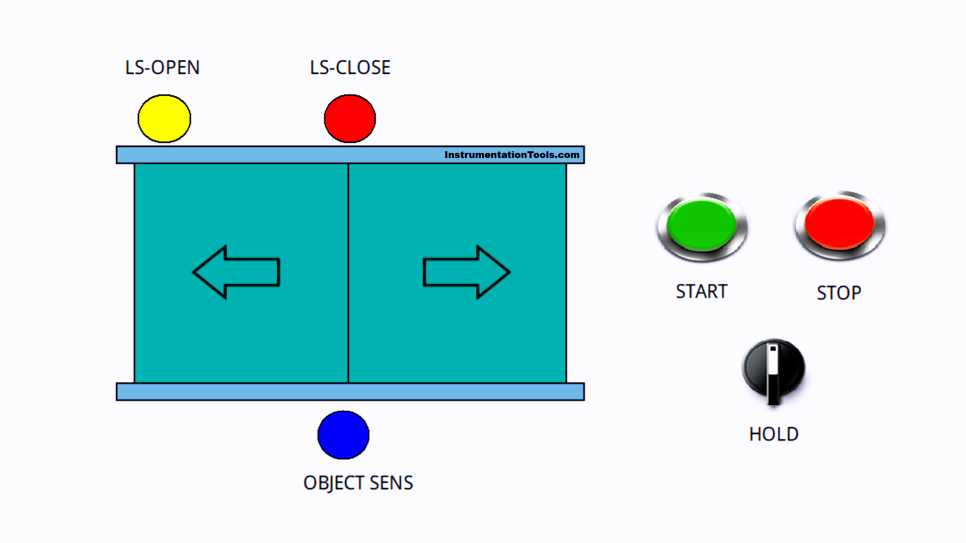

Automatic Door Opening System Steps:
  1. Initialization: System is ready to operate, door is closed.
  2. Detection: The sensor detects an approaching object.
  3. Open Door: The motor moves the door until it is fully opened.
  4. Hold: The door remains open briefly for 4 seconds.
  5. Close Door: The motor moves the door until it is fully closed.
  6. Hold Mode: The door will remain Open if the Selector Switch is set in “HOLD” mode.
  7. Repeat: Return to step 2 for the next detection.
This system has a sensor to detect objects and a limit switch to limit door opening/closing movements.

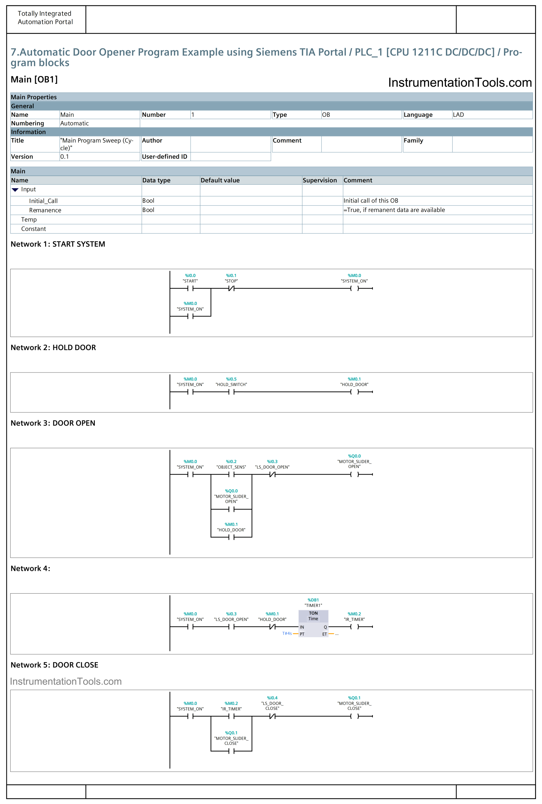

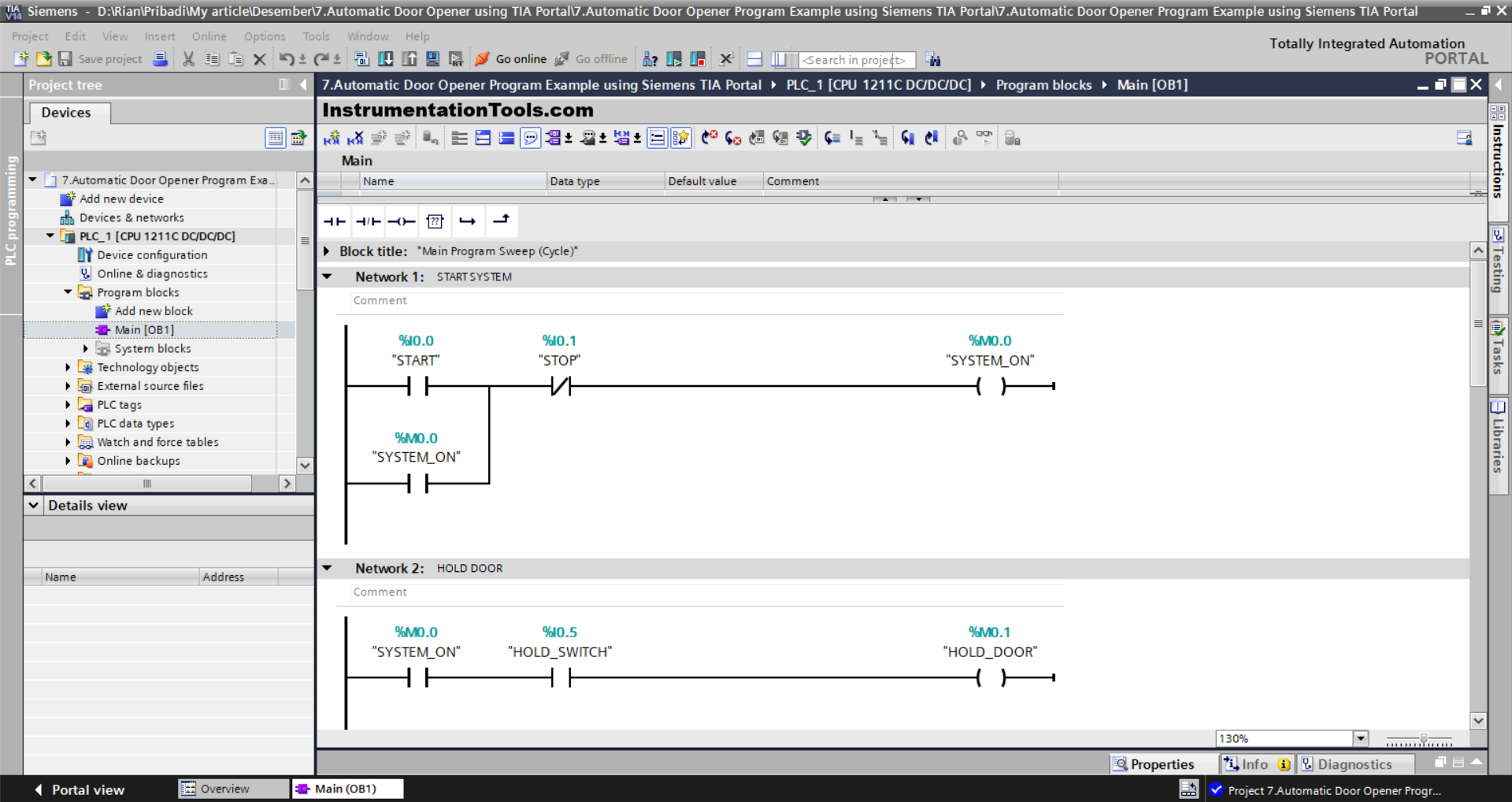

NETWORK 1 : (START SYSTEM)
In this network, when the START (I0.0) button is Pressed, the memory bit SYSTEM_ON (M0.0) ​​ will be in the HIGH state. Because it uses Latching, even though the START (I0.0) button has been released the memory bit SYSTEM_ON (M0.0) will remain in the HIGH state.
If the STOP (I0.1) button is Pressed, the memory bit SYSTEM_ON (M0.0) will be in the LOW state.
NETWORK 2 : (HOLD THE DOOR)
In this network, if the NO contact of the Selector Switch HOLD_SWITCH (I0.5) and the memory bit SYSTEM_ON (M0.0) are in the HIGH state, then the memory bit HOLD_DOOR (M0.1) will be in the HIGH state.
Motion sensor based door control with PLC

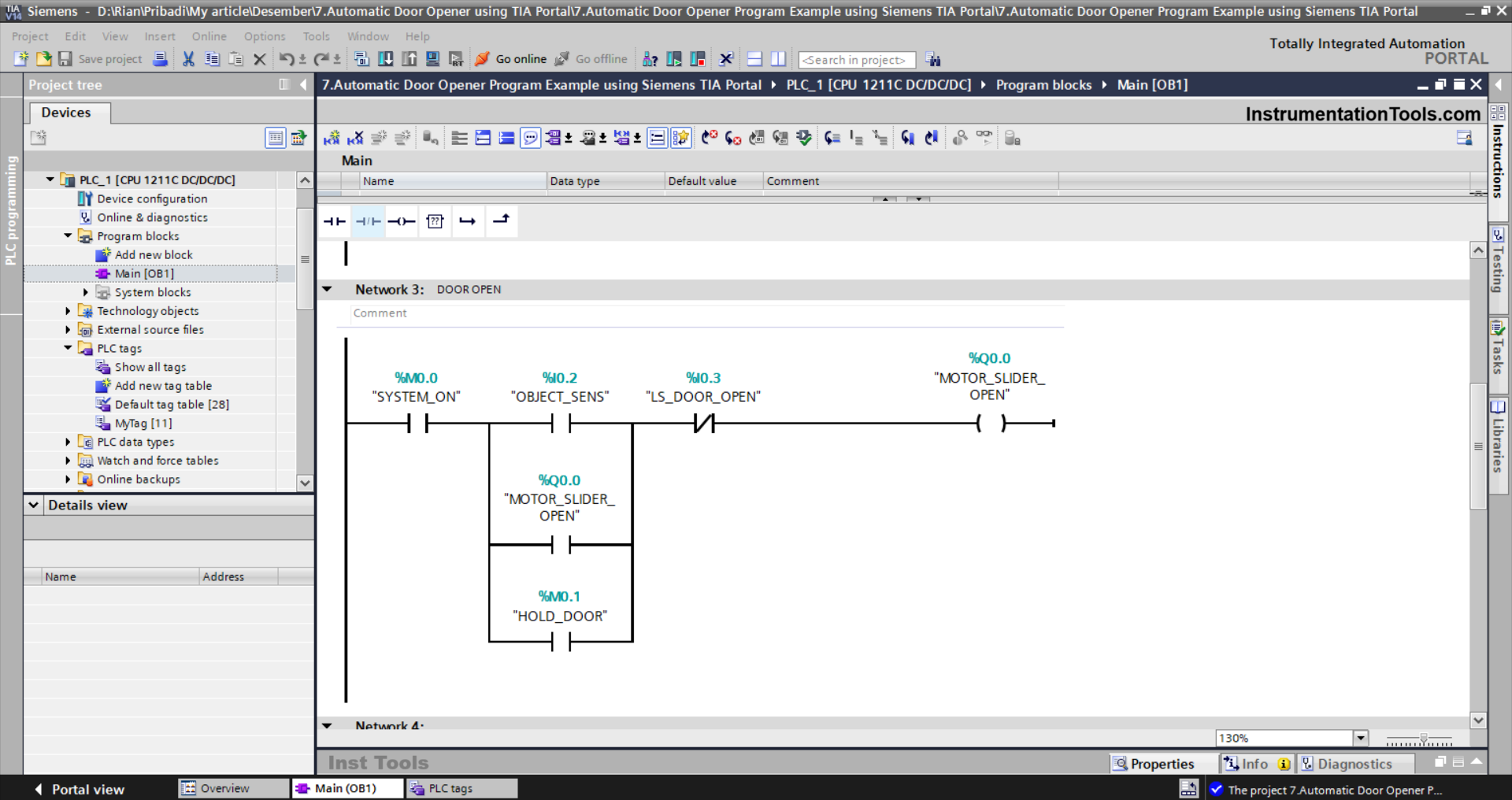

NETWORK 3 : (DOOR OPEN)
In this Network, the MOTOR_SLIDER_OPEN (Q0.0) output will be ON if the NO contact of the memory bit SYSTEM_ON (M0.0) and the sensor OBJECT_SENS (I0.2) are in the HIGH state. Because it uses Latching, the MOTOR_SLIDER_OPEN (Q0.0) output will remain in the ON state even though the NO contact of the sensor OBJECT_SENS (I0.2) is in the LOW state.
Or, the MOTOR_SLIDER_OPEN (Q0.0) output will be ON if the NO contact of the memory bit HOLD_DOOR (M0.1) is in the HIGH state.
The MOTOR_SLIDER_OPEN (Q0.0) output will be OFF when the NC contact of the Limit Switch LS_DOOR_OPEN (I0.3) is in the HIGH state.
TIA Portal ladder logic for automatic door

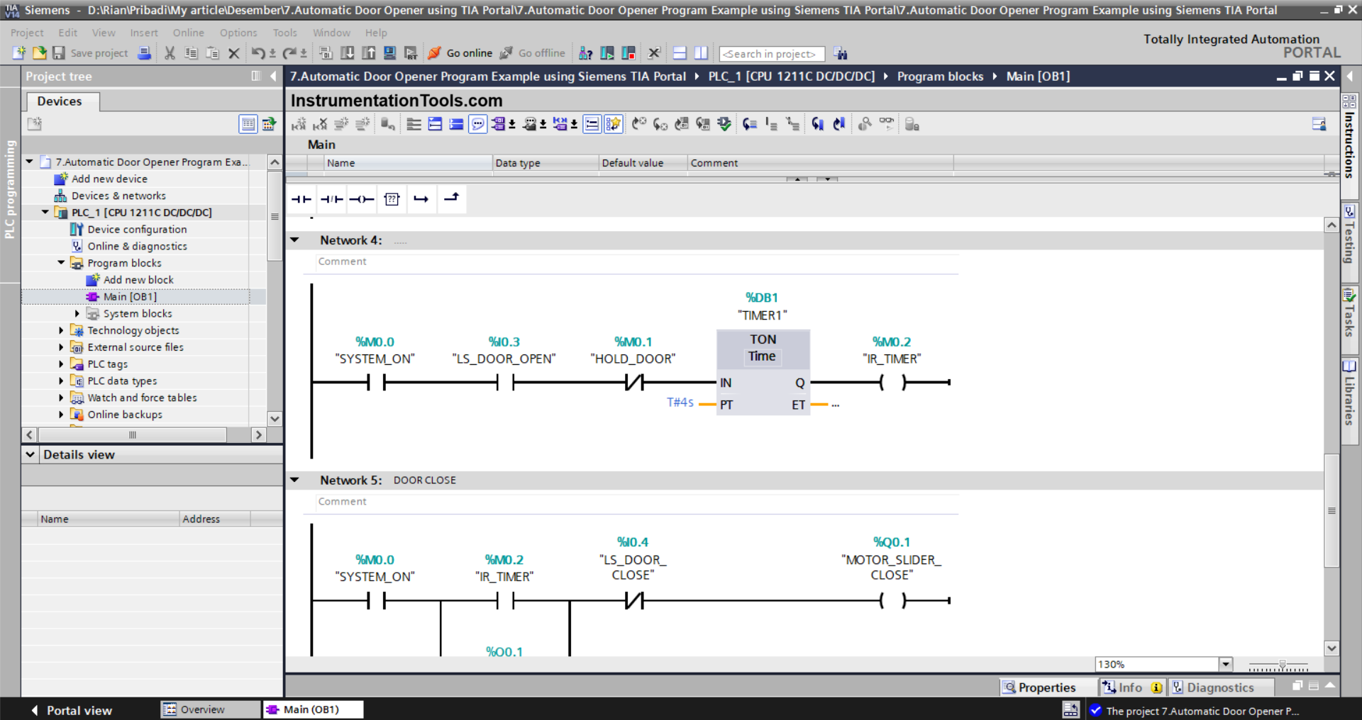

NETWORKS 4
The TIMER_OPEN (DB1) timer will start counting when the NO contact of the memory bit SYSTEM_ON (M0.0) ​​ and the Limit Switch LS_DOOR_OPEN (I0.3) are in the HIGH state. The timer TIMER_OPEN (DB1) will count to 4 seconds.
When the timer TIMER_OPEN (DB1) has finished counting, the memory bit IR_TIMER (M0.2) will be in the HIGH state.
If the NC contact of the memory bit HOLD_DOOR (M0.1) is in the HIGH state, then the timer TIMER_OPEN (DB1) will be reset.
Object detection door opener using PLC

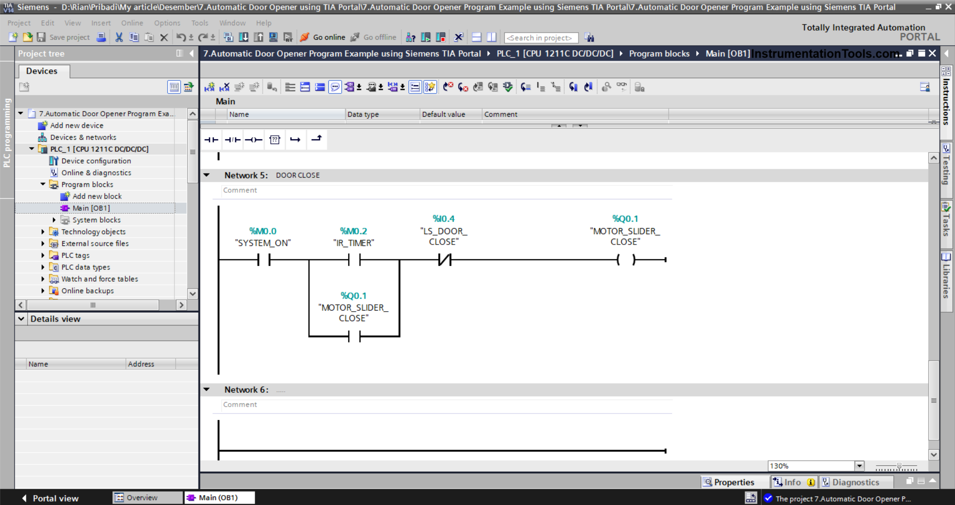

NETWORK 5 (DOOR CLOSE)
The MOTOR_SLIDER_CLOSE (Q0.1) output will be ON when the NO contacts of the memory bits SYSTEM_ON (M0.0) ​​and IR_TIMER (M0.2) are in the HIGH state. Because it uses Latching, the MOTOR_SLIDER_CLOSE (Q0.1) output will remain in the ON state even though the NO contact of the memory bit IR_TIMER (M0.2) is in the LOW state.
When the NC contact of the Limit Switch LS_DOOR_CLOSE (Q0.1) is in the HIGH state, the MOTOR_SLIDER_CLOSE (Q0.1) output will be OFF.
