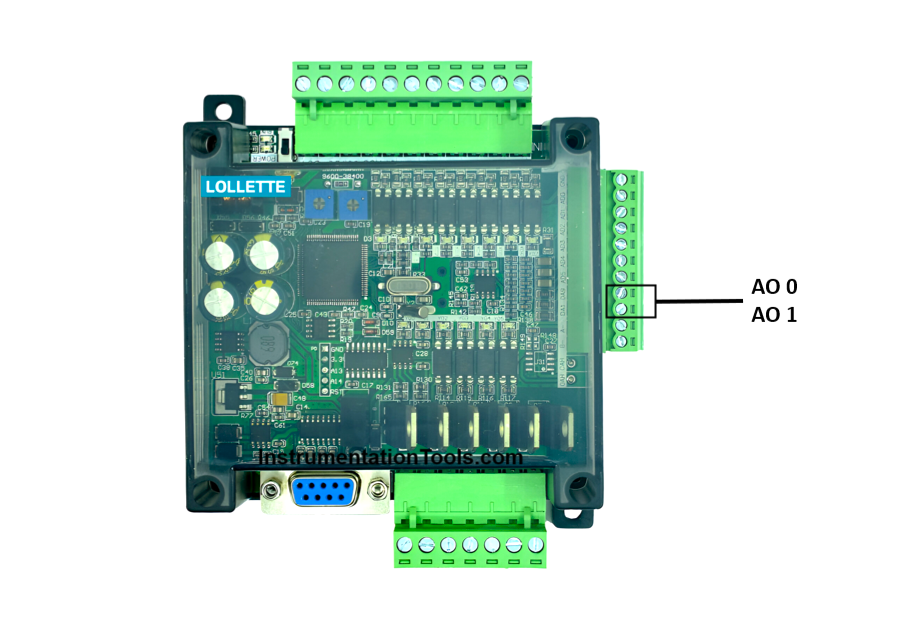

The PLC converts digital data with 12-bit resolution (0-4095) into physical voltage signals (0-10V) through a process called Digital-to-Analog Conversion (DAC). DAC is the conversion process of digital signals (binary or numerical values) generated by the PLC into continuous analog signals, such as voltage or current. In the Mitsubishi FX3U Lolette PLC, there are two Analog Output (AO 0 and AO 1) addresses available, both of which can only produce 0-10V voltage signals.

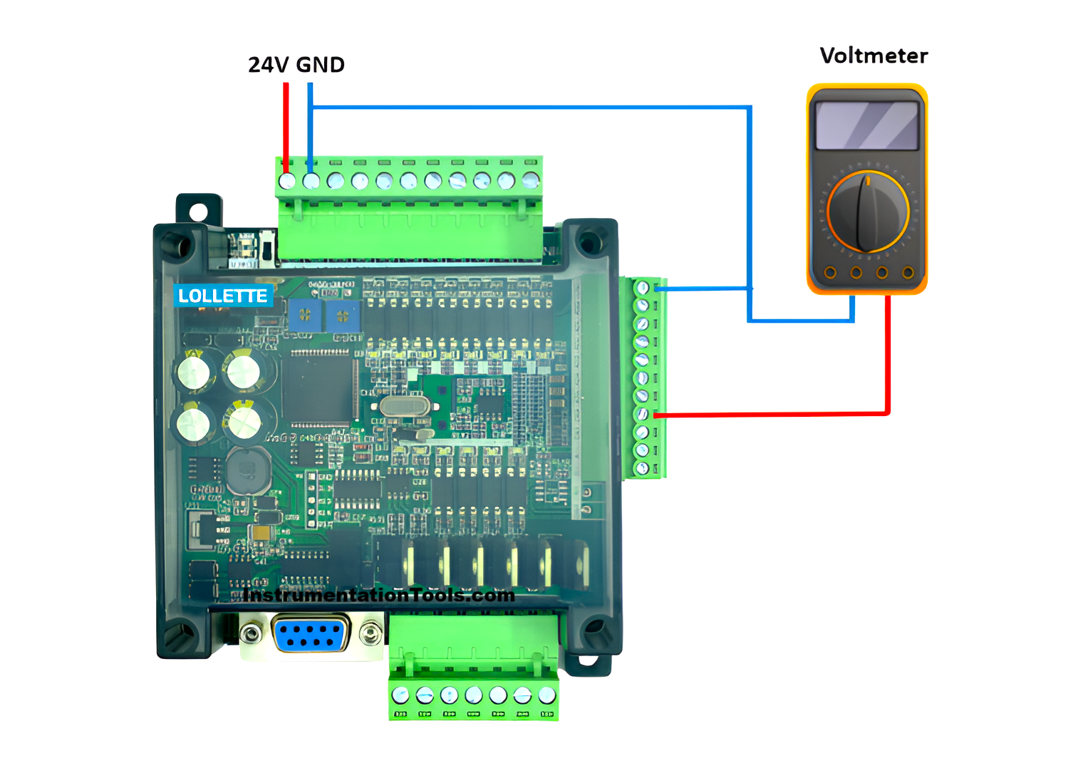

To determine the analog output value generated by the PLC, an avometer or voltmeter is used to measure the DC voltage produced at the Analog Output 0 terminal.

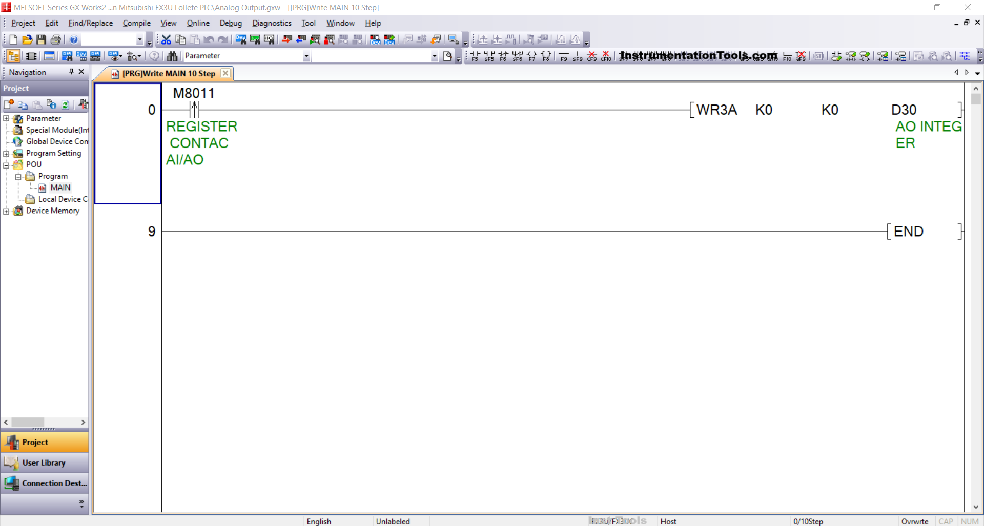

RUNG 0
In this rung, the NO contact from REGISTER CONTACT AI/AO (M8011) is used as a trigger to activate the WR3A instruction, which is a special instruction for setting the analog output value on the PLC.
The value K0 indicates the address of the analog output module being used, while K0 refers to the selected output port, namely DA0.
The resolution value for the analog output is defined through data memory word D30 (AO INTEGER), which contains a number in the range of 0–4095 (12-bit resolution).
When the WR3A instruction is executed, the digital value will be converted into an analog voltage signal of 0–10V, which will be output through port DA0.

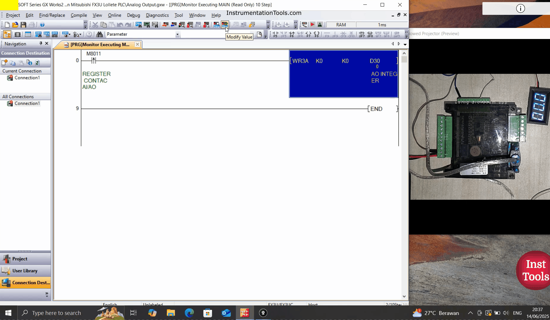

Simulation Video
In the video below, we simulated the program with real hardware and results displayed.
