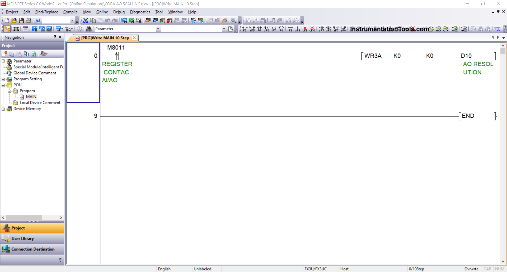

1. Open GX Works2 Mitsubishi PLC software and create the PLC Program.
Use the WR3A instruction with module setting “0/K0” and Analog Output address “0/K0”. Memory word AO RESOLUTION (D10) is used to store the analog output resolution data.

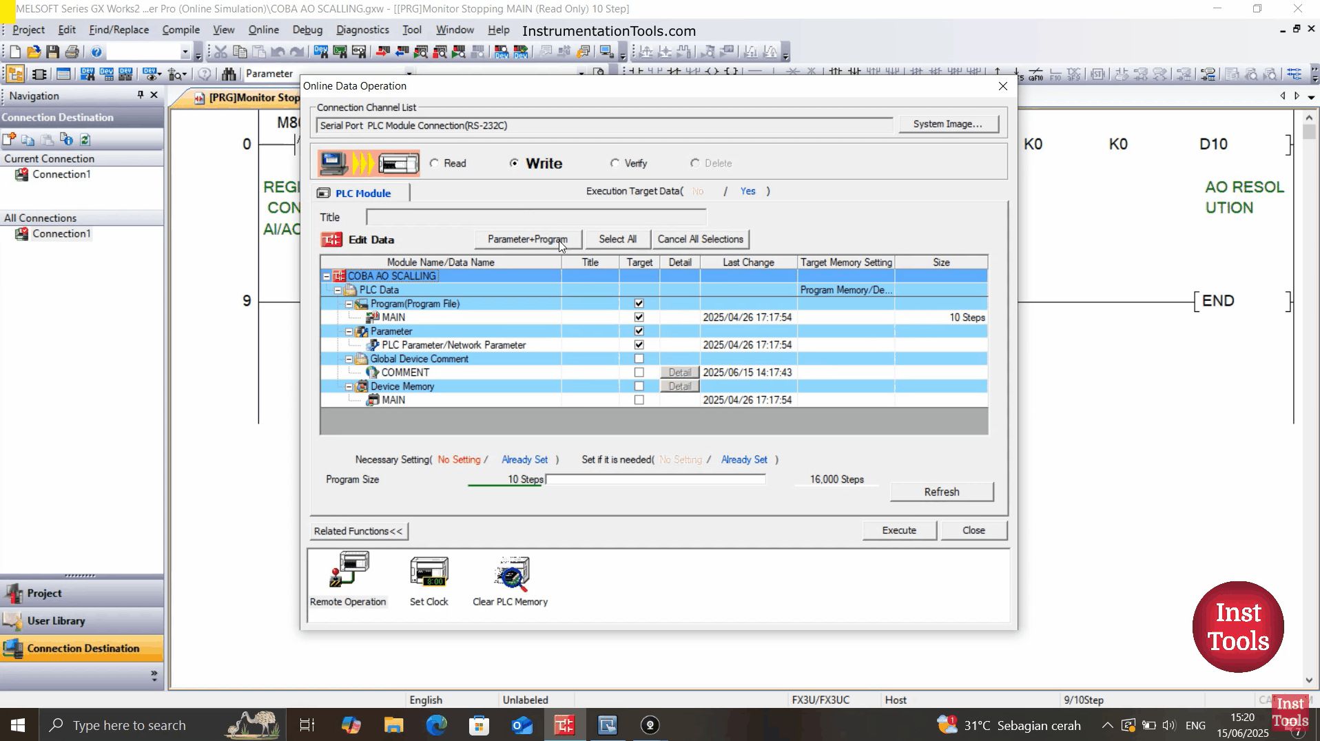

4. Upload the Program to the PLC
Click the Online menu → Write to PLC, select Parameter + Program, then press Execute.

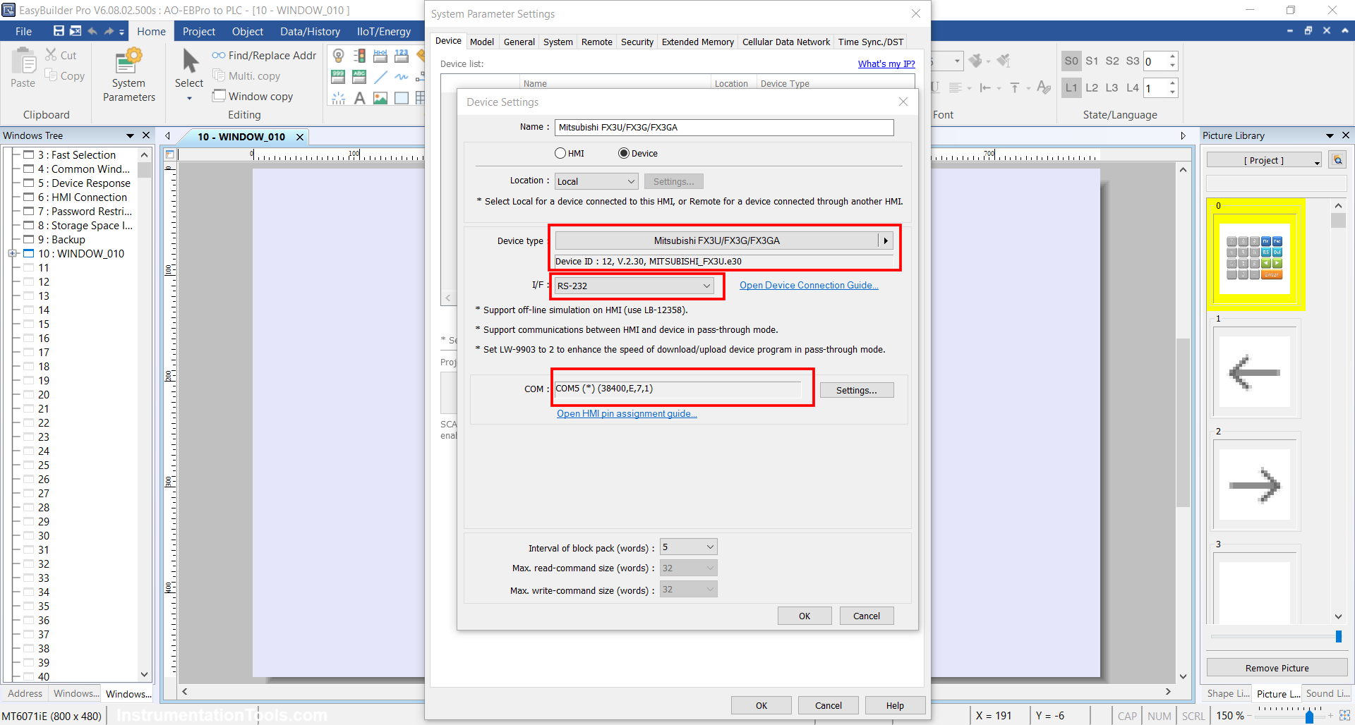

In the System Parameter window, click New Device/Server, then set:
- Port: RS-232
- COM: COM5(*)(38400,E,7,1)
- Device Type: Mitsubishi FX3U/FX3G/FX3GA
- Click OK.

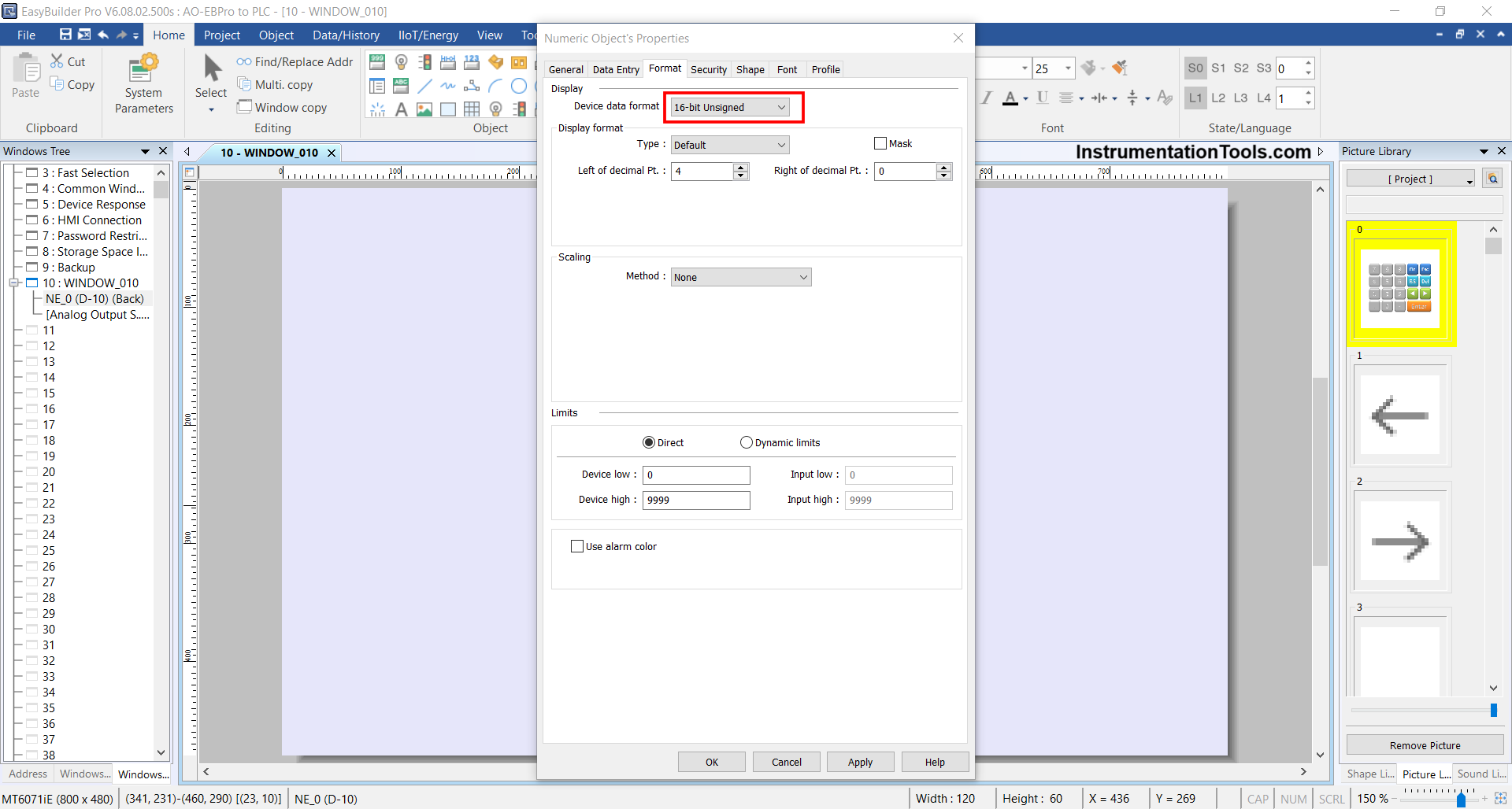

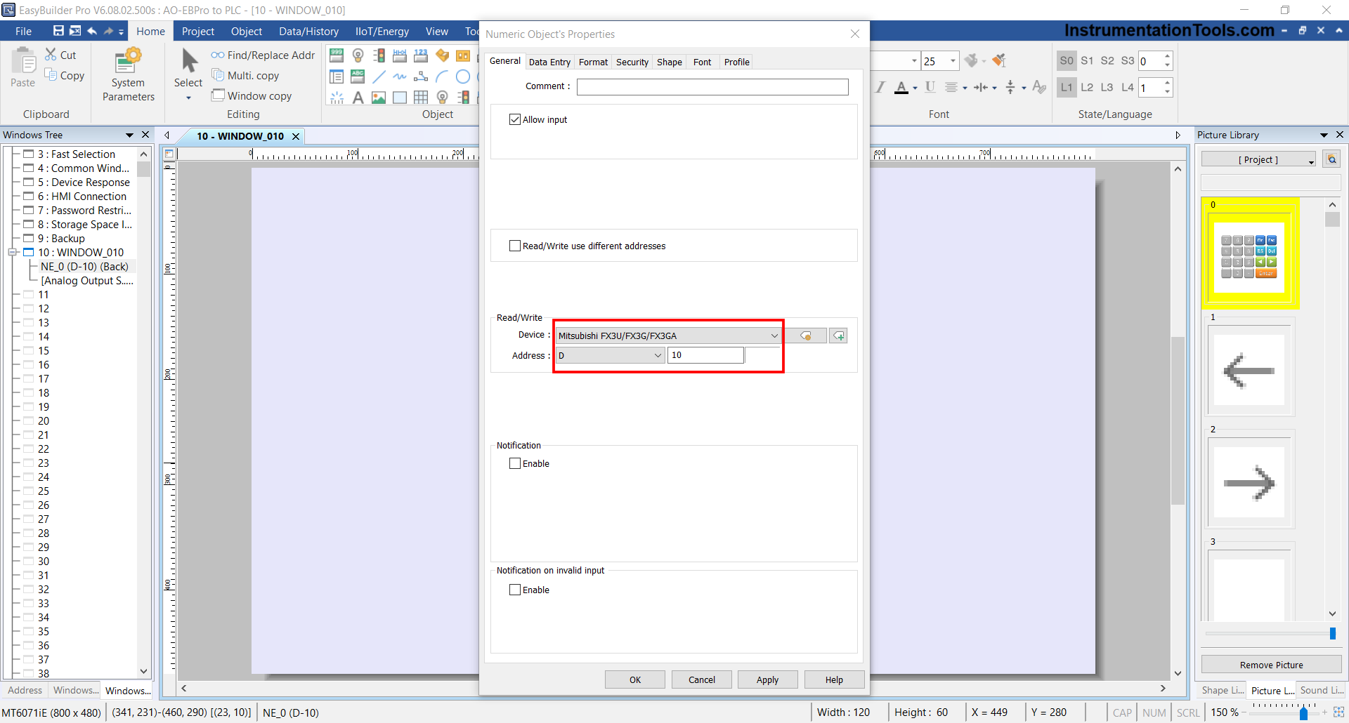

Insert “Numeric Object” → set the Device to “Mitsubishi FX3U/FX3G/FX3A” and the memory word address to “D10”, according to the Analog Output Resolution address in the PLC.
Set Data Format to “16-bit Unsigned”, then click OK.

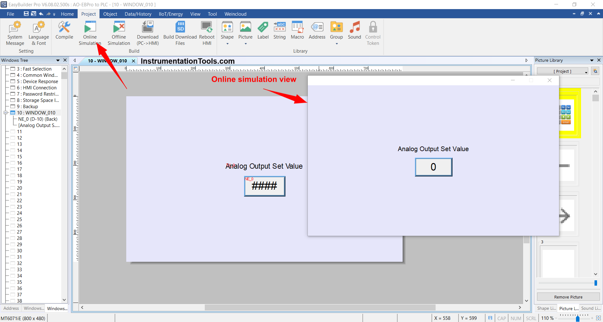

4. To test, click Project → Online Simulation.
5. Run the Simulation
If the connection is successful, the simulation display will appear, and the HMI will be connected to the PLC.
Note: If the message “Device Not Responding” appears, it means the connection failed. Try changing the Device Type in System Parameter to FX0S/FX0N/FX1S/FX1N/FX2/FX3SA, because the FX3U-14MT model (Lollette) sometimes is not fully compatible with the FX3U type in EasyBuilder Pro.
