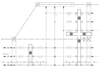

Gas Metering System
Gas Metering System
The custody transfer metering skid is an integrated piping system supported on a structural base. It accommodates all primary measurement instruments including the Ultrasonic flow meters, pressure transmitters, temperature transmitters and the MOV’s, straight length as per AGA 9. Flow profiler, piping and structural design, fabrication and testing are in line with project specifications and applicable codes and standards keeping in view the functional requirements.
The analyzers perform analysis of gas components, and provide input to flow computers for Energy computation. Analyzer house is designed to be located in the hazardous area of Zonal Gr-HB T3 with HVAC units, Fire and gas sensors with safety PLC is provided within the enclosure. Sample probes (installed on the metering skid) and analyzer sample handling system is provided ensuring representative samples.
The metering cabinets are located in the control room in a safe area. The panel houses the flow computers, station computers, GC controllers, PLC, HMI and Ethernet switches with interface to DCS. All flow and energy calculations are done by the flow computers which collect data of various signals from skids and analyzer house. The station computers compile the station values and generate reports.
