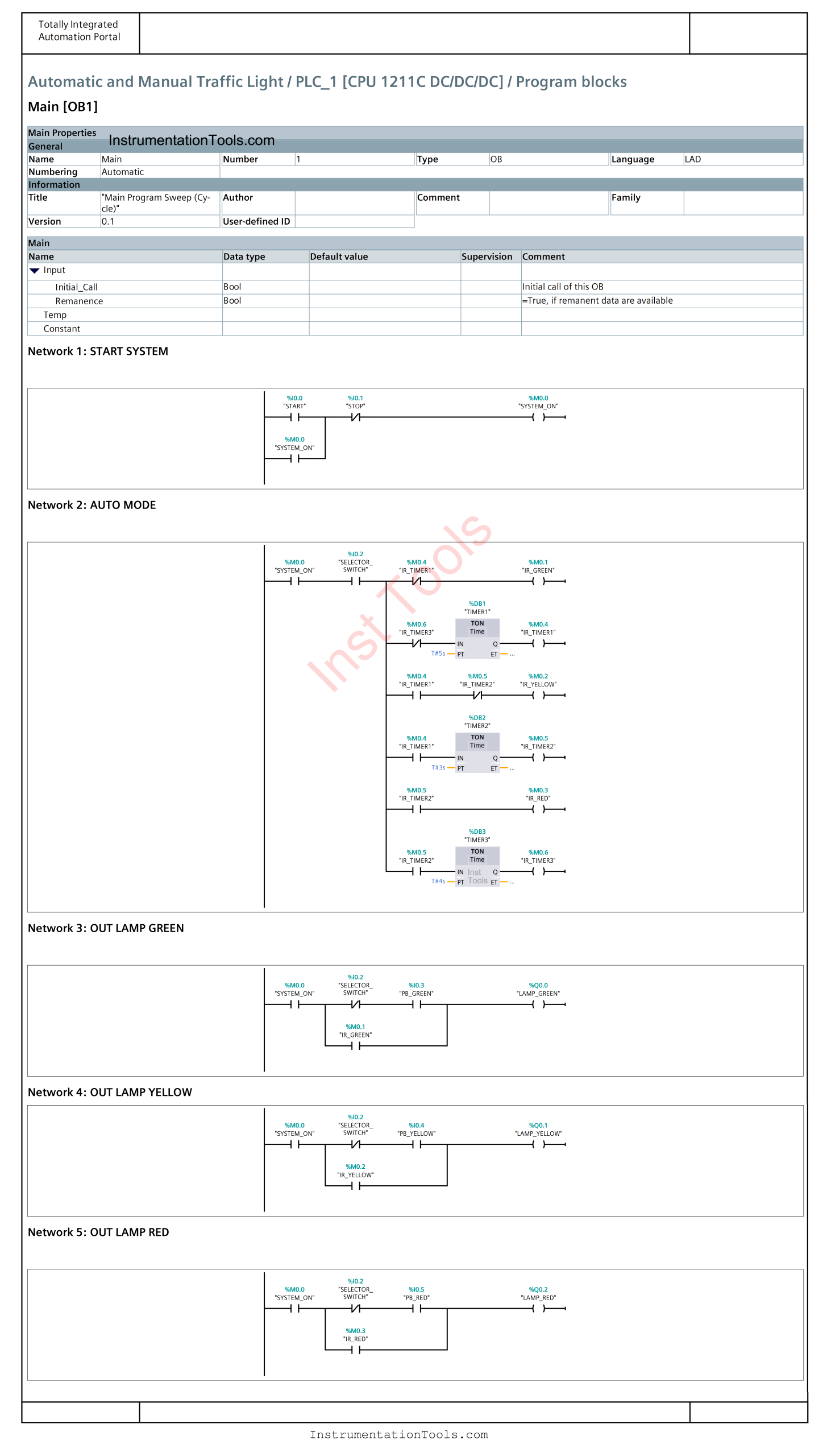

Traffic Signal Control with Push Buttons

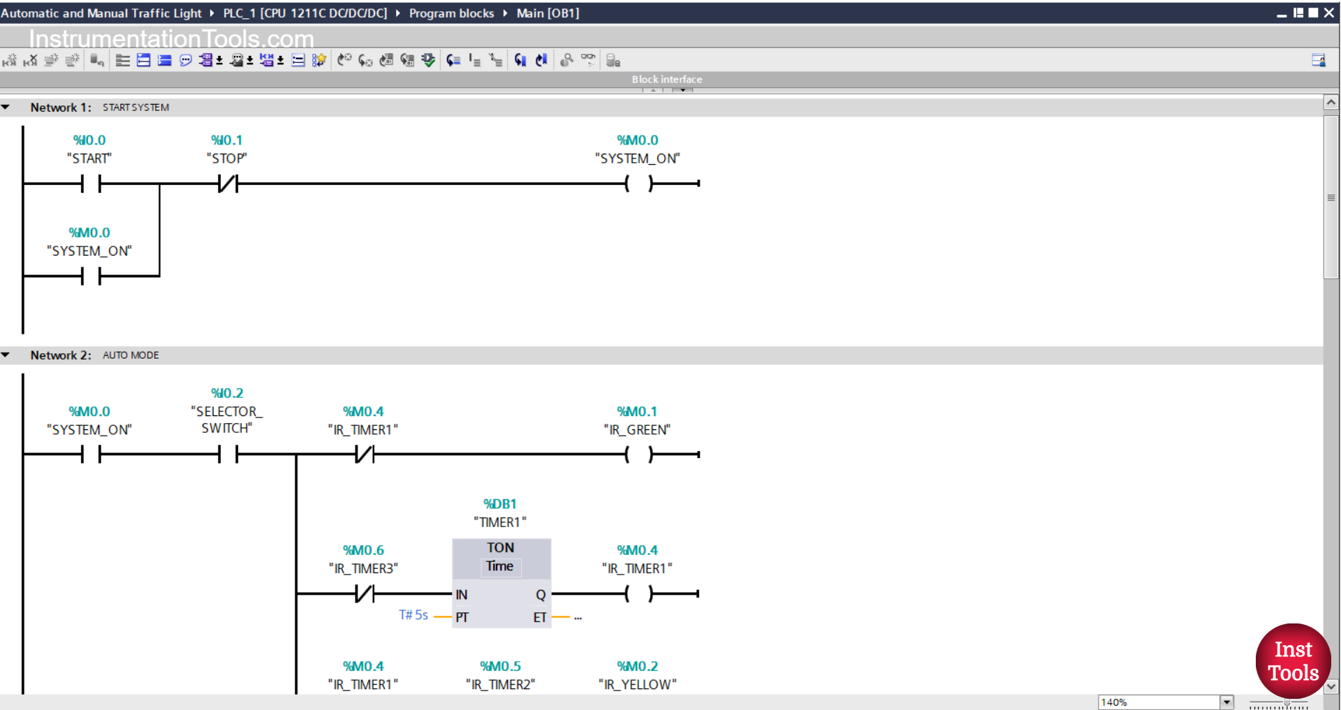

NETWORK 1 (START SYSTEM)
In this network, when the START(I0.0) button is pressed, the memory bit SYSTEM_ON (M0.0) will be in the HIGH state. Because it uses Latching, even though the START (I0.0) button has been released the memory bit SYSTEM_ON (M0.0) will remain in the HIGH state.
The memory bit SYSTEM_ON (M0.00 will be in the LOW state if the STOP (I0.1) button is pressed.

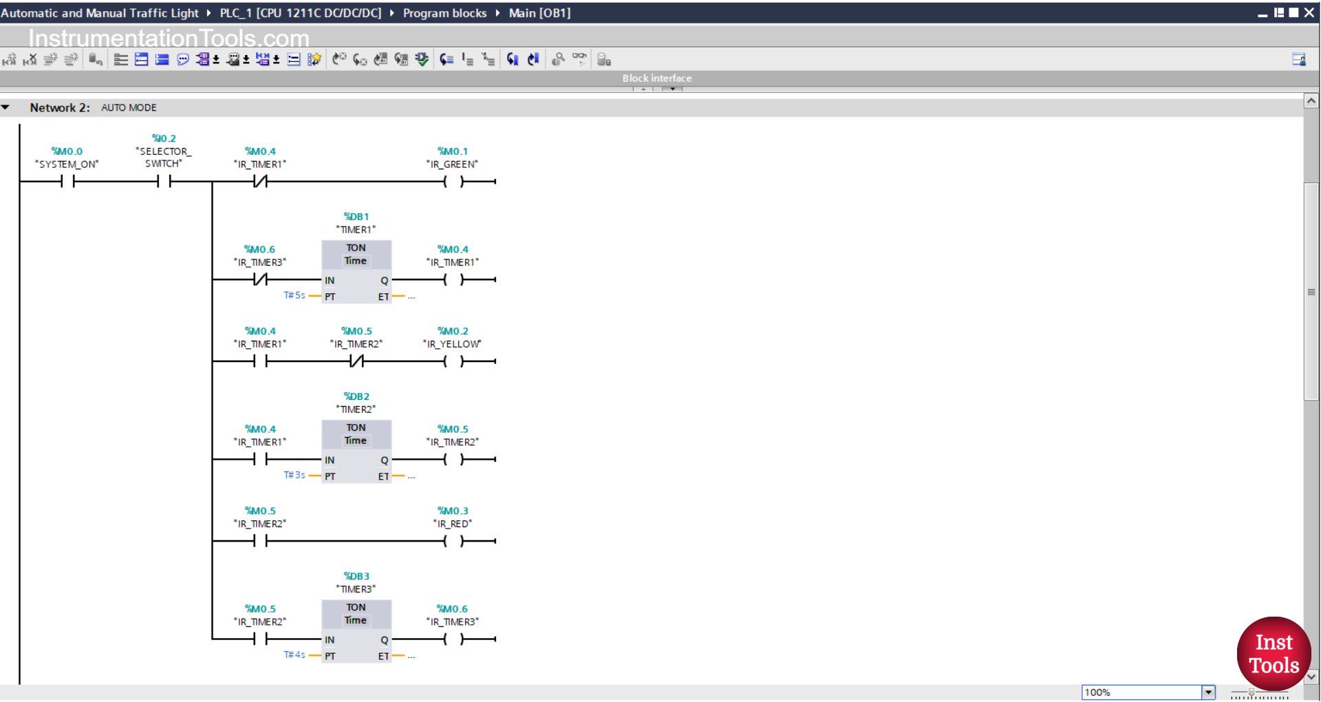

NETWORK 2 (AUTO MODE)
In this Network, the memory bit IR_GREEN (M0.1) will be in the HIGH state when the NO contact of the memory bit SYSTEM_ON (M0.0) and the NO contact of the selector switch SELECTOR_SWITCH (I0.2) are in the HIGH state. Timer TIMER1 (DB1) will Start counting.
The TIMER1 (DB1) timer will count up to 5 seconds, and after it has finished counting, the memory bit IR_GREEN (M0.1) will be in LOW state; the memory bits IR_TIMER1 (M0.4) and IR_YELLOW (M0.2) will be in HIGH state.
Next, Timer TIMER2 (DB2) will start counting up to 3 seconds.
The memory bits IR_TIMER2 (M0.5) and IR_RED (M0.3) will be in the HIGH state, and the memory bit IR_YELLOW (M0.2) will be in the LOW state due to the interlock of the memory bit IR_TIMER2 (M0.5).
The TIMER3 (DB3) timer will start counting up to 4 seconds.
When Timer TIMER3 (DB3) has finished counting, the memory bit IR_TIMER3 (M0.6) will be in the HIGH state.
Timer TIMER1 (DB1) will be reset due to the interlock of memory bit IR_TIMER3 (M0.6).
NETWORK 3 (OUT LAMP GREEN)
In this Network, the output LAMP_GREEN (Q0.0) will be ON if the NO contact of the memory bit SYSTEM_ON (M0.0) is in the HIGH state, the NC contact of the selector switch SELECTOR_SWITCH (I0.2) is in the LOW state, and the PB_GREEN (I0.3) button is pressed.
Or, the LAMP_GREEN (Q0.0) output will be ON when the NO contact of the memory bit IR_GREEN (M0.1) is in the HIGH state.

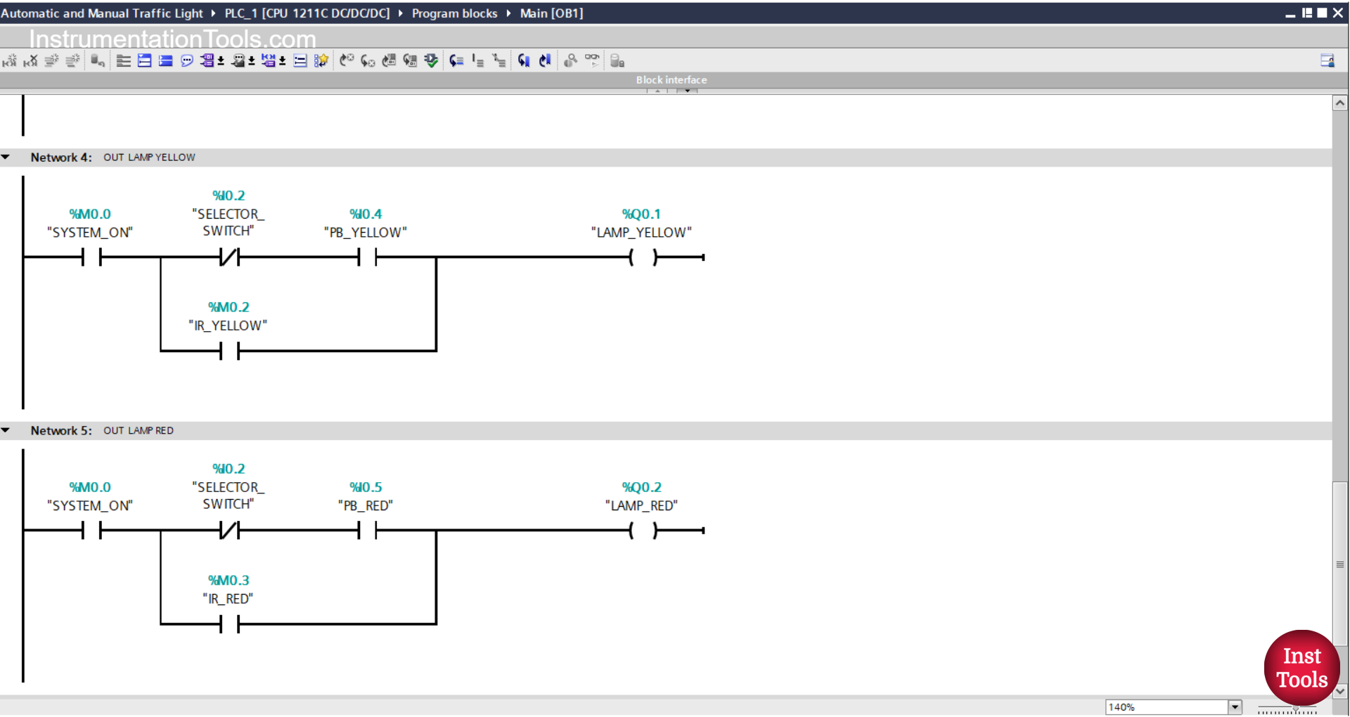

NETWORK 4 (OUT LAMP YELLOW)
In this Network, when the NO contact of the memory bit SYSTEM_ON (M0.0) is in the HIGH state, the NC contact of the selector switch SELECTOR_SWITCH (I0.2) is in the LOW state, and the PB_YELLOW (I0.4) button has been pressed, the output LAMP_YELLOW (Q0.1) will be ON.
Or, the LAMP_YELLOW(Q0.1) output will be ON when the NO contact of the IR_YELLOW(M0.2) bit memory is in the HIGH state.
NETWORK 5 (OUT LAMP RED)
In this Network, the LAMP_ RED (Q0.2) output will be ON if the NO contact of the memory bit SYSTEM_ON (M0.0) is in the HIGH state, the NC contact of the selector switch SELECTOR_SWITCH (I0.2) is in the LOW state, and the PB_ button RED (I0.5) has been pressed.
Or, the LAMP_ RED (Q0.2) output will be ON when the NO contact of the memory bit IR_RED (M0.3) is in the HIGH state.
