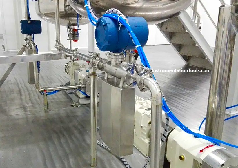

Coriolis meters measure mass flow by measuring how much the tubes twist as fluid flows through them. This twist solely depends on mass flow, hence the measurement stays fairly steady even when the temperature or pressure fluctuates. Thermal mass flow meters work in a different way. They measure how much heat the gas takes away from a heated sensor. This means they work well with clean, dry air or gas, but not with liquids or moist places. You can better comprehend the difference if you think of Coriolis as a “precision scale” and thermal as a “heated airflow sensor.”

Coriolis meters can handle just about anything—clean liquids, thick viscous fluids, slurries, and even some challenging mixtures—making them one of the most flexible technologies on the market. Thermal mass flow meters, by contrast, specialize in gases. Their sensors must remain clean and dry to stay accurate, so they are not recommended for wet gases or environments with contamination. In short: if your process involves “liquid and tough fluids,” go Coriolis; if it’s “clean gas only,” thermal may be the better match.
