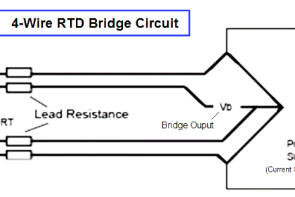

To use an RTD simulator to test a device with an RTD input:
  1. Connect the calibrator to the device input as shown in figure rigth side.
  2. Connect the calibrator output with the right combination to match the device configuration (2, 3 or 4-wire).
  3. Use the test procedure at left for thermocouple testing, starting at step 3.
