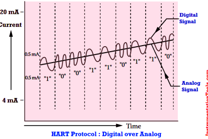

1. Define HART.
HART is an acronym for “Highway Addressable Remote Transducer”. The HART protocol makes use of the Bell 202 Frequency Shift Keying (FSK) standard to superimpose digital communication signals at a low level on top of the 4-20mA
This enables two-way field communication to take place and makes it possible for additional information (tag numbers, measured variables, range & span data) beyond just the normal process variable to be communicated to/from a smart field instrument.
The HART protocol communicates at 1200 bps without interrupting the 4-20mA signal and allows a host application (master) to get two or more digital updates per second from a field device. As the digital FSK signal is phase continuous, there is no interference with the 4-20mA signal.

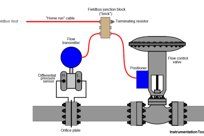

16. What is meant by fieldbus ?
Fieldbus is an all digital, serial two way communication system that interconnects devices such as sensors, actuators and controllers.
Fieldbus replaces the 4-20mA standards. It is a LAN for instruments with built in capability to distribute a control application across the network.

23.What are the different field bus topologies?
  1. Point-to-point topology,
  2. Bus with spurs topology,
  3. Tree topology,
  4. Daisy chain topology.

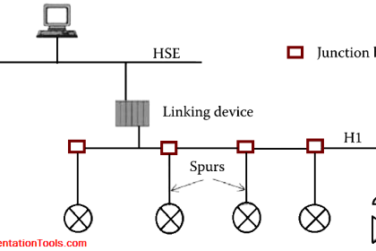

24.What is meant by Bus with spur topology?
With this topology, the fieldbus devices are connected to the bus segment through a length of cable called a spur.
A spur can vary in length from 1m to 120 m. If spur is less than 1 m it is called splice.
25.What is meant by daisy chain topology?
With this topology the field bus cable is routed from device to device on the segment and is interconnected at the terminals of each field bus devices.
