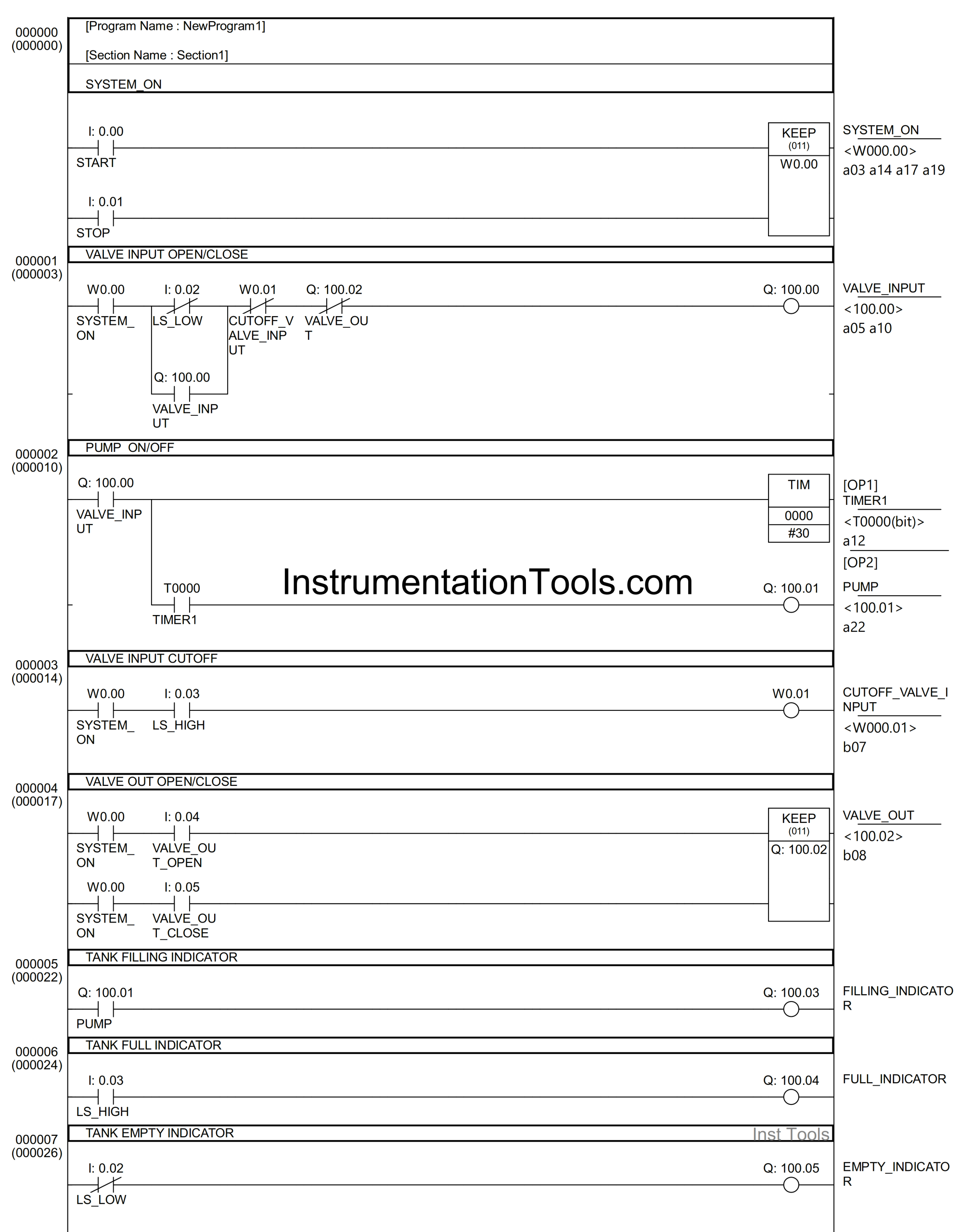

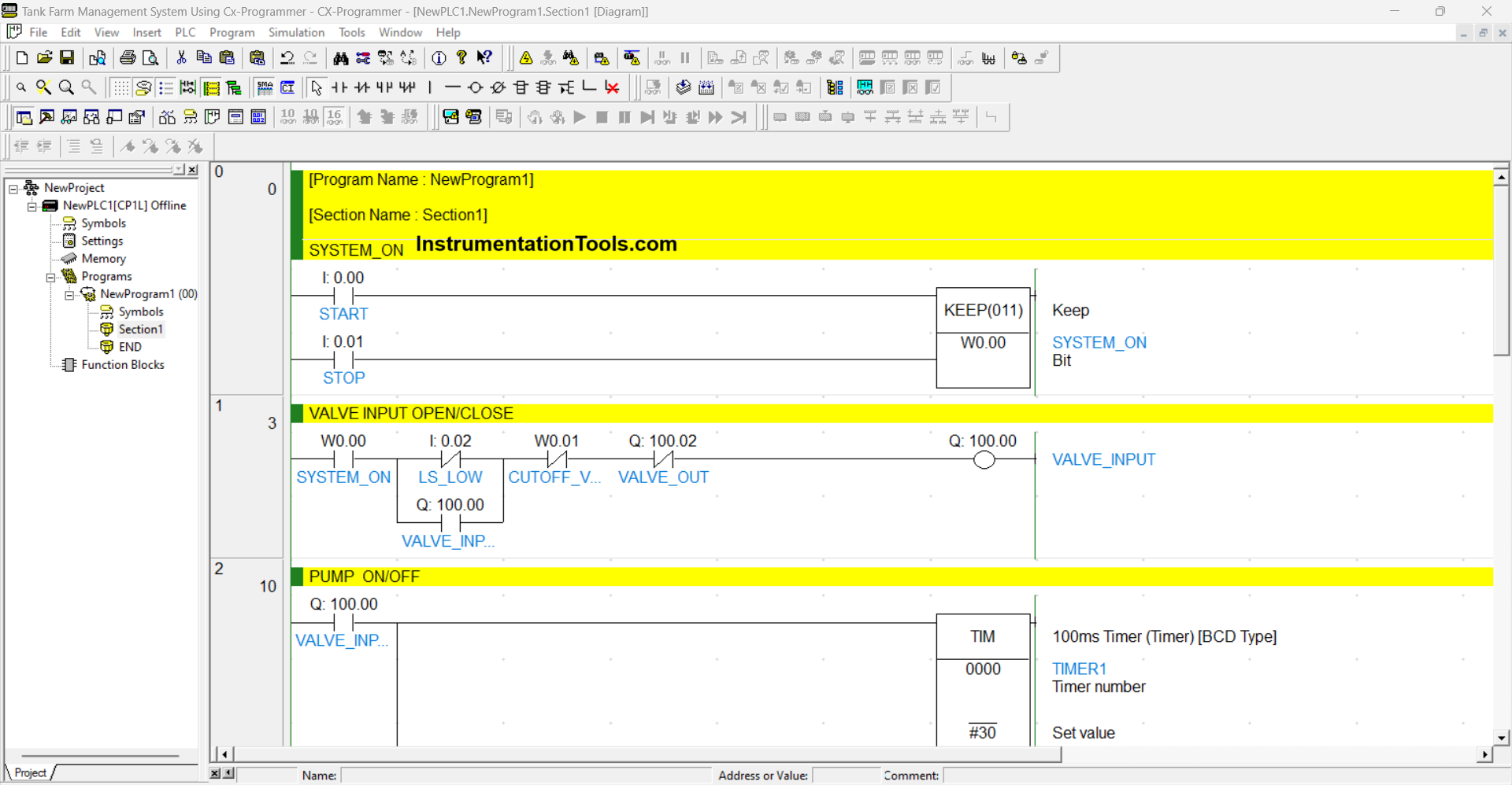

RUNG 0 (SYSTEM_ON)
In this Rung, when the START (0.00) button is Pressed, the memory bit SYSTEM_ON (W0.00) will be in the HIGH state. Because it uses the KEEP(011) instruction, the memory bit SYSTEM_ON (W0.00) will remain in the HIGH state even though the START (0.00) button has been Released.
The memory bit SYSTEM_ON (W0.00) will be in the LOW state if the STOP (0.01) button is Pressed.
Tank Farm PLC Logic
RUNG 1 (VALVE INPUT OPEN/CLOSE)
In this Rung, if the NO contact of memory bit SYSTEM_ON (W0.00) is in the HIGH state and Sensor LS_LOW (0.02) is in the LOW state, then the output VALVE_INPUT (100.00) will be OPEN.
The VALVE_INPUT (100.00) output will be CLOSED if the NC contact of CUTOFF_VALVE_INPUT (W0.01) or VALVE_OUT (100.02) is in the HIGH state.

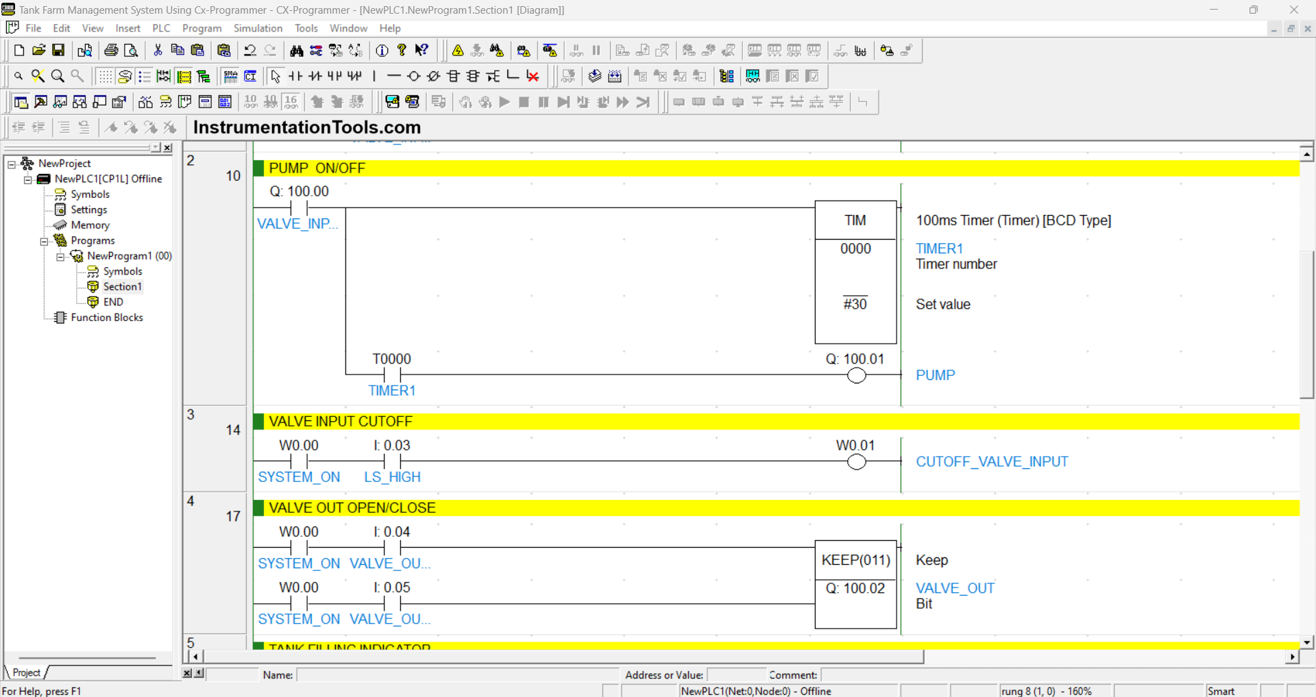

RUNG 2 (PUMP ON/OFF)
In this Rung, if the NO contact of VALVE_INPUT (100.00) is in the HIGH state, then Timer TIMER1 (T0000) will Start counting up to “3” seconds. When the NO contact of TIMER1 (T0000) is in the HIGH state, the PUMP (100.01) output will be ON.
Tank management Ladder Logic
RUNG 3 (VALVE INPUT CUTOFF)
When the NO contact of memory bit SYSTEM_ON (W0.00) and Sensor LS_HIGH (0.03) are in the HIGH state, then the memory bit CUTOFF_VALVE_INPUT (W0.01) will be in the HIGH state.

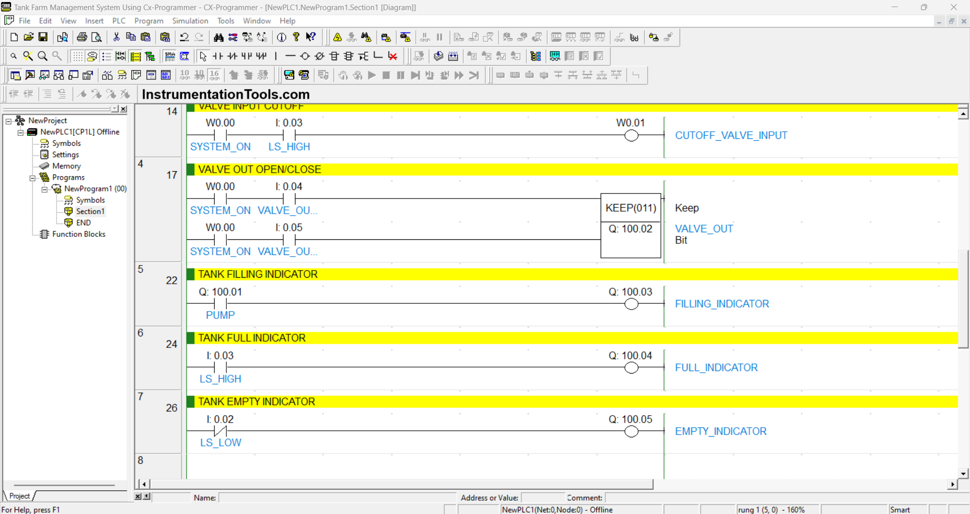

RUNG 4 (VALVE OUT OPEN/CLOSE)
When the NO contact of memory bit SYSTEM_ON (W0.00) in the HIGH state and the VALVE_OUT_OPEN (0.04) button is Pressed, the VALVE_OUT (100.02) output will become OPEN. Because it uses the KEEP(011) instruction, the VALVE_OUT (100.02) output will remain in the OPEN state even though the VALVE_OUT_OPEN (0.04) button has been Released.
And when the VALVE_OUT_CLOSE (0.05) button is Pressed, the VALVE_OUT (100.02) output will become CLOSE.
RUNG 5 (TANK FILLING INDICATOR)
In this Rung, when the NO contact of PUMP (100.01) is in the HIGH state, the FILLING_INDICATOR (100.03) output will be ON.
PLC Tank Terminal Monitoring and Control System
RUNG 6 (TANK FULL INDICATOR)
In this Rung, when the NO contact of Sensor LS_HIGH (0.03) is in the HIGH state, the FULL_INDICATOR (100.04) output will be ON.
RUNG 7 (TANK EMPTY INDICATOR)
In this Rung, when the NC contact of Sensor LS_LOW (0.02) is in the LOW state, the EMPTY_INDICATOR (100.05) output will be ON.
