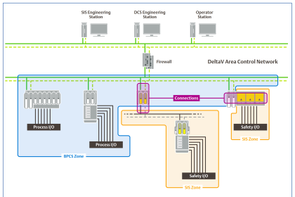

A SIS is engineered to perform “specific control functions” to failsafe or maintain safe operation of a process when unacceptable or dangerous conditions occur.
Safety Instrumented System Engineer InterviewSIS Questions & AnswersWhat are the standards that define the best rules for installation of field equipment of a SIF/SIS, on site?The routing of the individual cables of transmitter that is in a 2oo3 voting system–the same route, different routes?Can I install the three field devices in battery or in different places to avoid, common failure, e.g., vibration, risk of fire?Must I use the normal practices of engineering or do rules or recommendation exist for the installation of field equipment for the SIF/SIS?Installation Guidelines:When is a Safety Integrity Level Rating of a Valve Required?Based on this definition,Why are control valves that are used in a BPCS required to be SIL certified?How can MTTF provide useful data for the calculation of PFDavg (probability of failure upon demand)?What is SIL?How is SIL different than reliability?When does a Fire & Gas system become a SIS?How does SIL relate to individual components?Why would a customer want SIL certified products?
Safety Instrumented Systems must be independent from all other control systems that control the same equipment in order to ensure SIS functionality is not compromised.
SIS is composed of the same types of control elements (including sensors, logic solvers, actuators and other control equipment) as a Basic Process Control System (BPCS).
However, all of the control elements in an SIS are dedicated solely to the proper functioning of the SIS. Read the Safety Instrumented System Engineer Interview Questions.

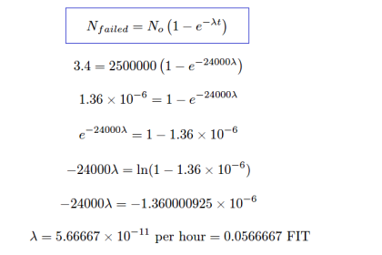

Essentially MTTF (mean time to fail) is the right term to define product reliability. It is usually furnished in units of hours. This is more common for electronic components, but trends are seen even for mechanical items.
MTTF can be simplified to 1/(sum of all failure rates) or equal to 1/λ
MTTFs calculations provide plant availability, which is a very important measurement of process plant up-time capability. A spurious trip that is considered a safe but unplanned trip may be too strenuous for piping and other equipment. Not only are production and quality affected, profits may be as well.
